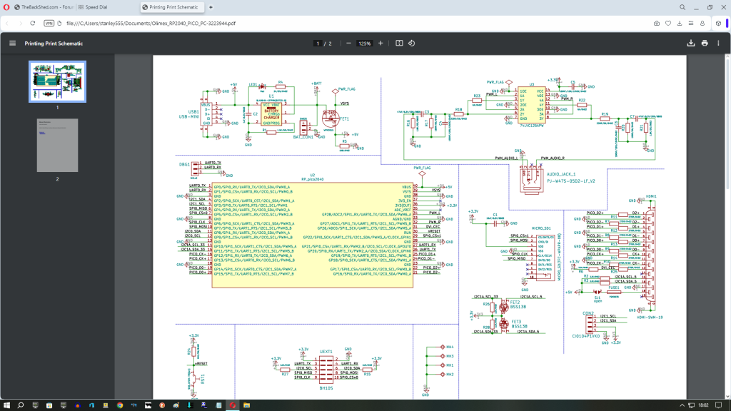

Hello to matherp an geoffg.
At olimex i found the so called rp2040pc. is it possible to install/ run picomite 6 on this device?
Link to Olimex rp2024pc
Edited 2024-12-12 15:58 by hhtg1968
Footnote added 2024-12-12 15:59 by hhtg1968
sorry for the title. RP2040PC is the right name.
Posts: 3369
Posted: 06:49am 12 Dec 2024
The PicoMite firmware would run on it, but it would not support HDMI and probably not most of its other features.  Olimex mention that they have a schematic, but it is not available for download so you would be flying blind.

Posts: 9239
Posted: 08:37am 12 Dec 2024
Schematic is here on Github.
Interesting that it uses the same pins as the HSTX for HDMI. I suspect it's come from the earlier HDMI stuff that was done for the RP2040.

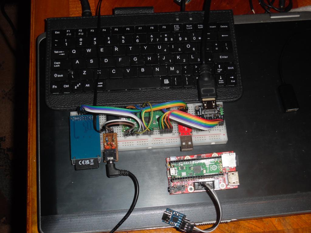

Posts: 2807
Posted: 10:42pm 12 Dec 2024
I got olimex and soldered long female headers but there was sound/a-d problems so breadboard 2350 pico 2 which I can use a scope prog to display audio sound using a-d.
got to solder to vero and going to keep molex leads!
