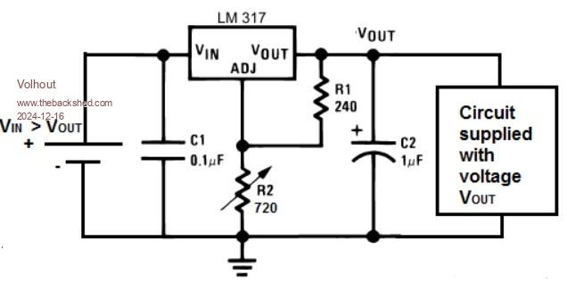

A typical application is the LM317 linear regulator for a small 1A 30V supply. Similar to this:

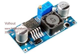

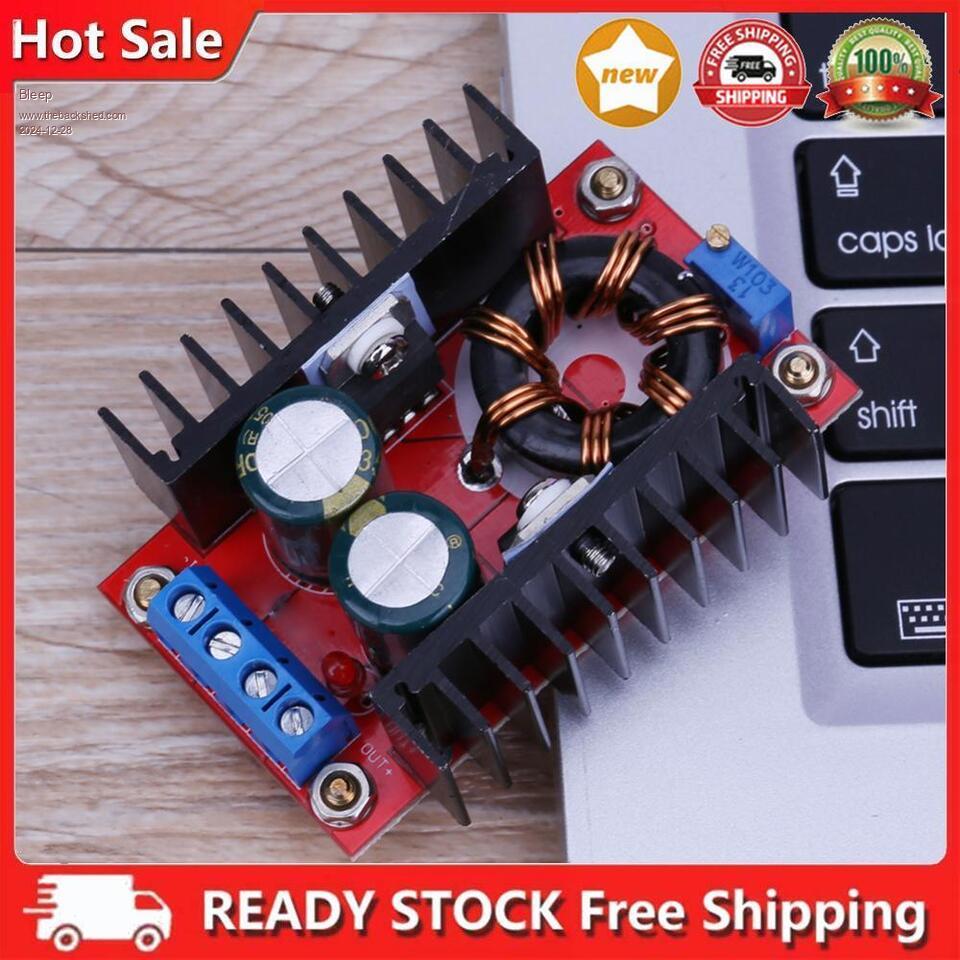

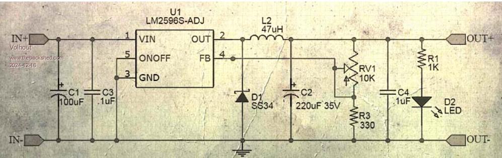

2/ Switchmode power supplies ( famous for their good efficiency ( but poor noise behaviour). For similar powers you can use the cheap LM2596 boards as depicted below.
The schematics are found on the internet, and are these:

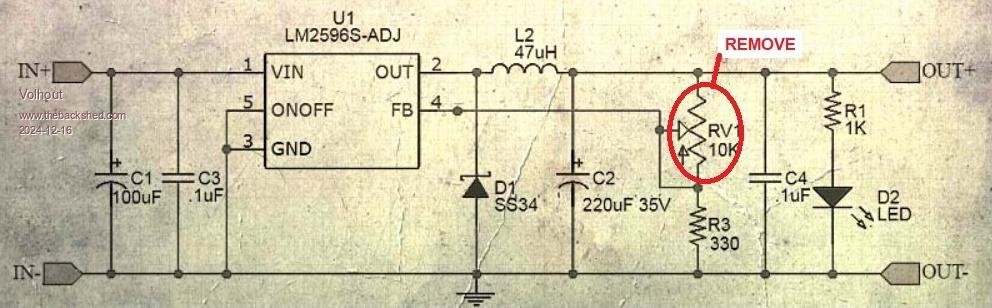

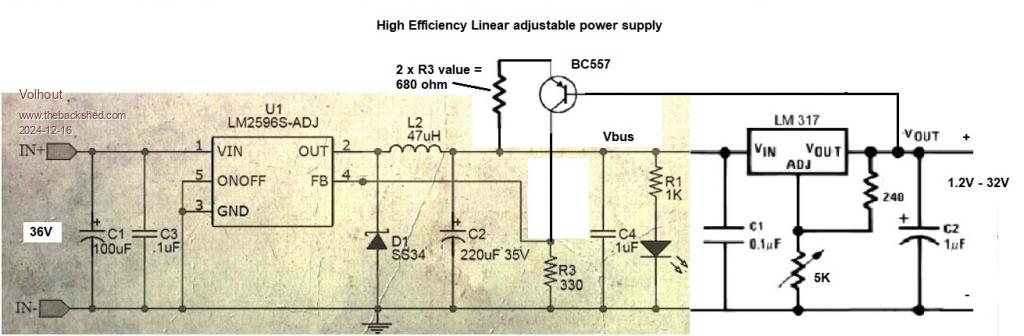

The combination of a pre-regulator and a post regulator.
Very good results can be achieved when the linear regulator is given the optimal input voltage to perform it's task, something like 3V dropping on the LM317. That can be achieved by combining the switching pre-regulator and the linear post regulator as below. Remove the potmeter from the LM2596 board.
The adjustment of the switching regulator is replaced by a circuit that makes it track the output voltage for the linear regulator. The 680 ohm resistor deternings the LM317 drop voltage.
I purchased the LM2596 board for 1 euro, and the LM317 for 50 cents. The whole power supply is below 2 dollar (except for the 36V source).
This idea works fine, the LM317 needs only a very small heatsink, for a continuous 1A output. For real low noise, an LC filter between LM2596 and LM317 is needed.
This is not a complete bench power supply, but the idea forms the basic for the power supply in development. It is just that somebody might find this beneficial.

Some of thesecircuits look the same but operate different. The circuit proposed above is a linear feedback system that does not need any tuning since it relies on the feedback gain and phase that was originally designed. The circuits in your article increase the gain, and therefore require careful tuning to maintain stability.

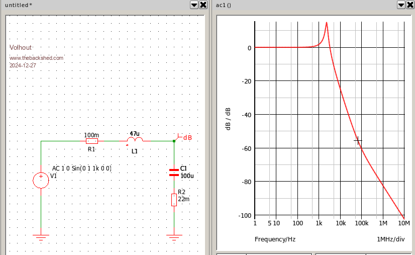

Posts: 5995
Posted: 08:49pm 26 Dec 2024
Hi aFox,
A linear regulator like an LM317 has a pretty good ripple rejection for 50 and 100Hz (anything below 1kHz), but is not very good for 180kHz (the switching frequency of the LM2596) and above. That is why you need a LC filter.
I succesfully tried a 47uH inductor and 100uF capacitor without calculation. The inductor should be rated 1A minimum. With a 180kHz ripple of 1Vpp, you need 60dB (a factor 1000) rejection to get to 1mVpp.
The resistors are part of inductor/capacitor according the datasheet.
The disadvantage of the LM317 is that for current limit and short circuit protection, you would need a negative voltage. Do able, but complicating.
So the LM317
- needs a negative voltage when adjustable current limit is required.
- cannot be used as reference, since you want if controlled from a DAC (the DAC Vref will be the reference) or PWM (pico voltage is the reference)..
- has poor ripple rejection for 180kHz.
So apart form the nice TO220 package it has no benefits.
This does not make LM317 an ideal candidate. Although I have a circuit drawn and prototyped, I am drifiting off into a new design that simply uses a medium power transistor in combination with an LM358 opamp and the above 2596 switcher board.
Edited 2024-12-27 07:13 by Volhout

I've come up against this with LM317 designs. It's not a good chip for a general purpose lab supply. You need a negative rail for 0v output and current limit has to be sensed in some other way to be of any use. The method of varying the voltage is only optimal over a restricted range. Toward the edges of that range regulation suffers. The package is power limited, which will usually protect against overloads, but no guarantee into a short circuit. Of course, it was never designed for this. It's designed to be a programmable fixed voltage regulator and it's good at that.
By the time you've messed about making an unsatisfactory supply out of two or more LM317s you may as well have used a twin op amp, a transistor or so and a power transistor for the output. It'll probably be less complicated and work better. :)

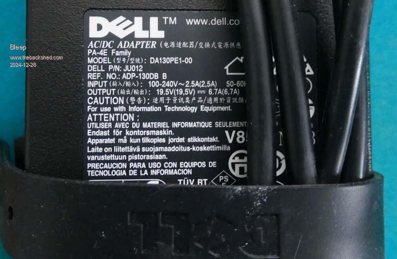

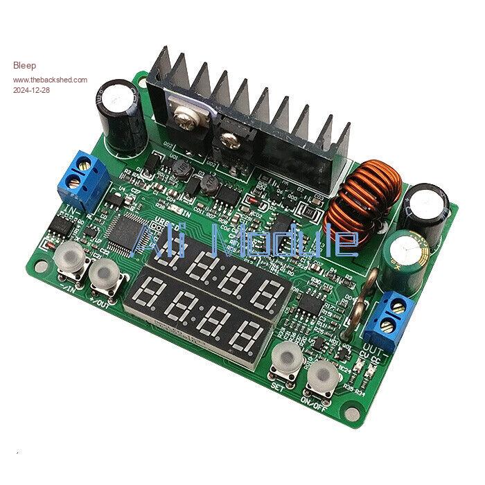

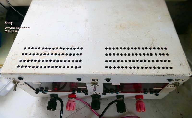

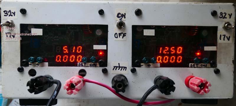

I know your original title is 'linear' but here is my take on a cheap-n-chearfull bench PSU partially from the junk box.
Dual 0-32v at up to 5.1A, with digital displays & current and voltage limits.
2 x 19V 130W laptop bricks.
2 x DP30V5A Digital-controlled 160W 32V 5A Buck PSU constant volt/current
2 x 150W DC-DC Boost Converter Step Up Power Supply Module 10-32V To 12-35V
Sundry, switches, terminal posts and one NTC.
Makes one of these:-
Each brick, poweres it's own Digital voltage/current controller, which would only normally give 18V output, so there is also 2x 150W step up converters to give the 34V required to give the full 0-32V range, these can be switched in and out as required.
I wanted to be able to charge Lead Acid batteries occasionally, which this is easily capable of, 10.2A at 14V, both channels paralleled up.
The current limit is very usefull, especially when prototyping new builds, or for re-charging batteries, especially Lithium.
I found the NTC on the mains input to the bricks was required, only after I had destroyed 2 mains power toggle switches. :-(
You presumably could make it quieter by adding your LC filter. :-)
Regards, Kevin.
