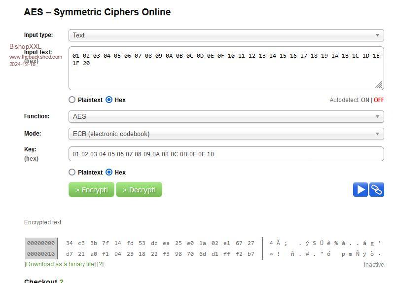

BishopXXL
Joined: 13/01/2019
Posts: 42
Posted: 07:55am 18 Dec 2024
Hello,
thank you for your help!
@Peter
@Mixtel90
yes mick, you're right, it's "ECB"
I tried this again with an online tool!
I'll add a screenshot.
If it's not too complicated, I would be very happy to use it at some point
is accepted into the MATH family - THANKS to EVERYONE!!!
Cheers Bishop
