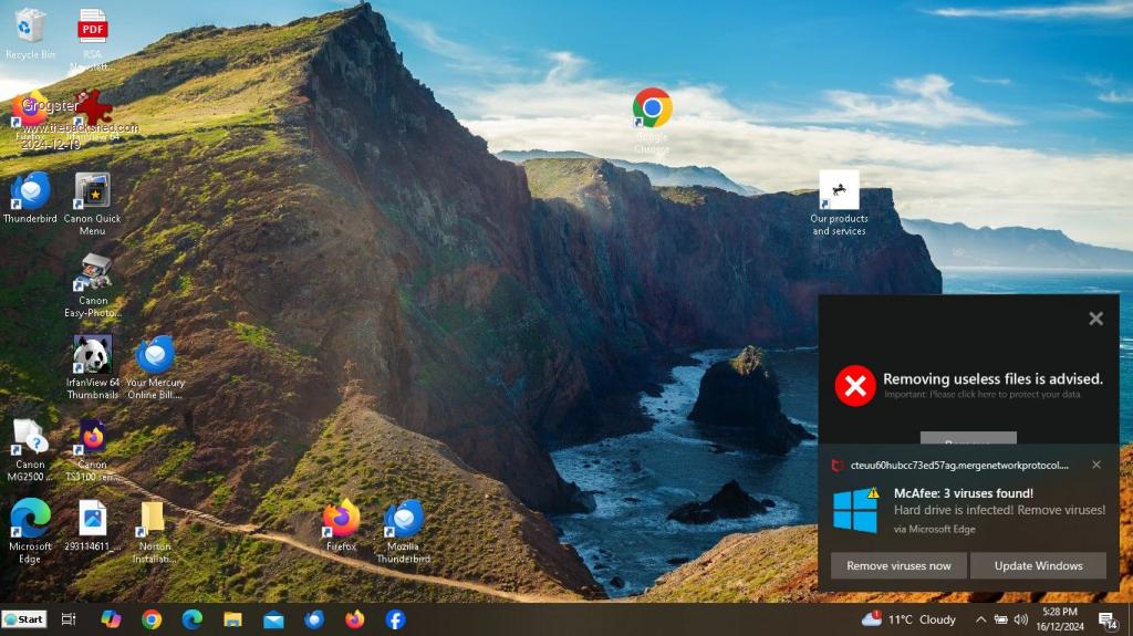

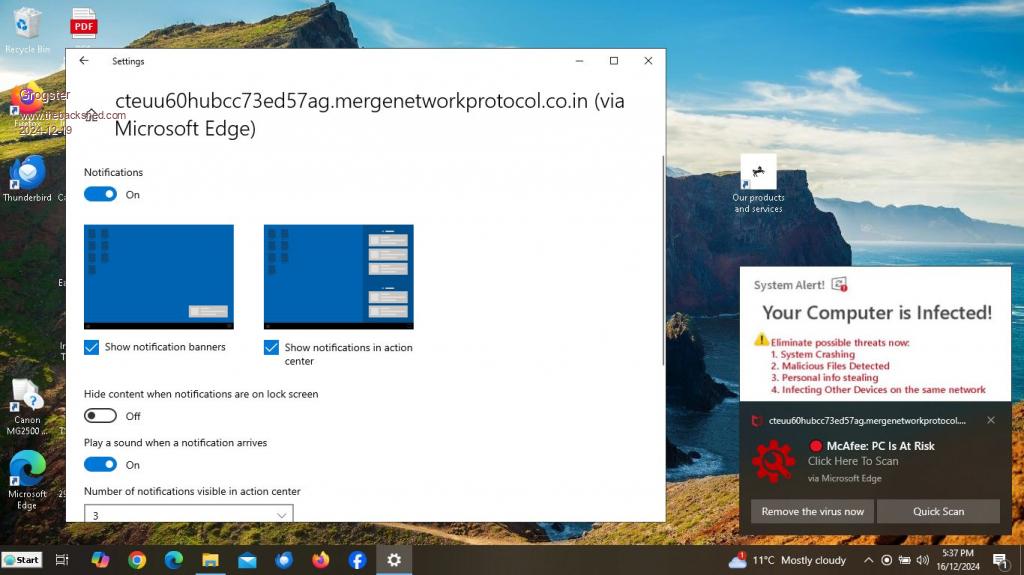

Hi all.
I've seen this on a couple of machines now, and it bombards the user with constant pop-ups via the Windoze notification system.
A full(up to date) AV scan does not detect it, Spybot does not detect it.
You can generally disable it using notification settings, but does anyone know how you go about uninstalling something that is hiding in the notification system?
I attach some photos.  Note the extremely random and non-sensical name of the app that is doing this.
These notifications APPEAR to be coming via Microsoft Edge, but in both cases that I have seen, neither person uses MS Edge, they use either Google Chrome or Firefox, so not quite sure how MS Edge can be routing this crap, if MS Edge is not being used as the web browser by either user.
Anyone else seen this crap, and does anyone know how you remove it?

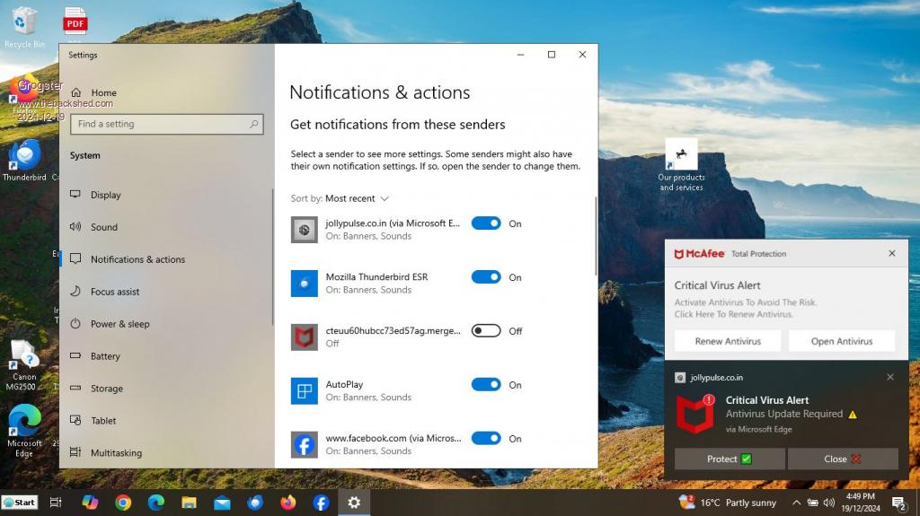

A google search on jollypulse.co.in found this:
https://sensorstechforum.com/jollypulse-co-in-ads/
I have no idea if the above site is any better than jollypulse so do further research before downloading their "fix"

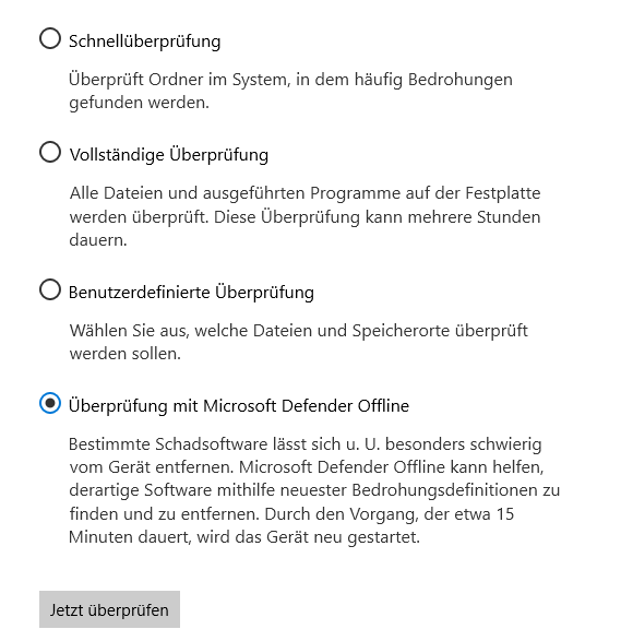

1) Not use anything else than Firefox as browser and add the "uBlock Origin" add on.
2) Go to "scan options" of Windows Defender and do an "offline scan" & restart system

  robert.rozee said  are you referring to the messages from McAfee?
No.
NEITHER of these two users, have McAfee installed, so this is total BS....
EDIT: It is phishing.  The users don't even have the AV software being pushed via these "Notifications", so the notifications are trying to say they need to update software they don't even have.  Red flag.

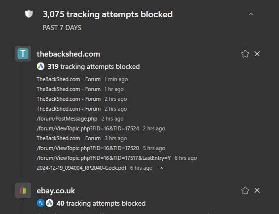

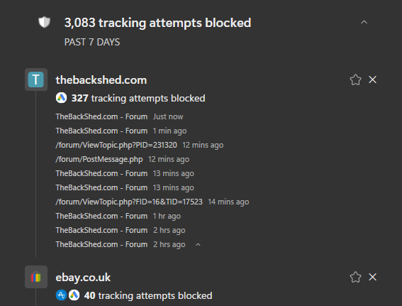

This is the update that I get from the Duckduckgo browser:
Aaaaan a few minutes later:
Edited 2024-12-20 01:18 by PhenixRising

This probably caused by a site that is using browser notifications to do some phishing.
Go into your browser settings and disable all notifications and also remove and block the sites that have been granted permission to notify.
Do this for all your browsers, particularly Chrome and Edge. Check also for rogue extensions.
After all is clean, use an adblocker. I recommend Ublock Origin Lite for Chrome (optimal setting) and regular Ublock Origin for the other browsers.
Also, it would wise to scan with ADW Cleaner.

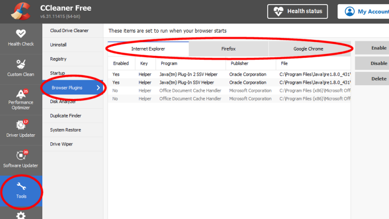

I use CCleaner  to keep my machines reasonably tidy. It can remove "web helper" plugins from various browsers - I suspect your user has accepted an "offer" from some nefarious pop-up. Install CCleaner and then look to see what bolt-ons are installed for startup, browers etc... use disable instead of delete just for safety... anything that you cant positively identify, disable it and see if that fixes the problem... it will be a bit of trial and error I think but this tool is very good at helping. Then after a while and the problem not recurring, go in and delete those you disabled if you want.
