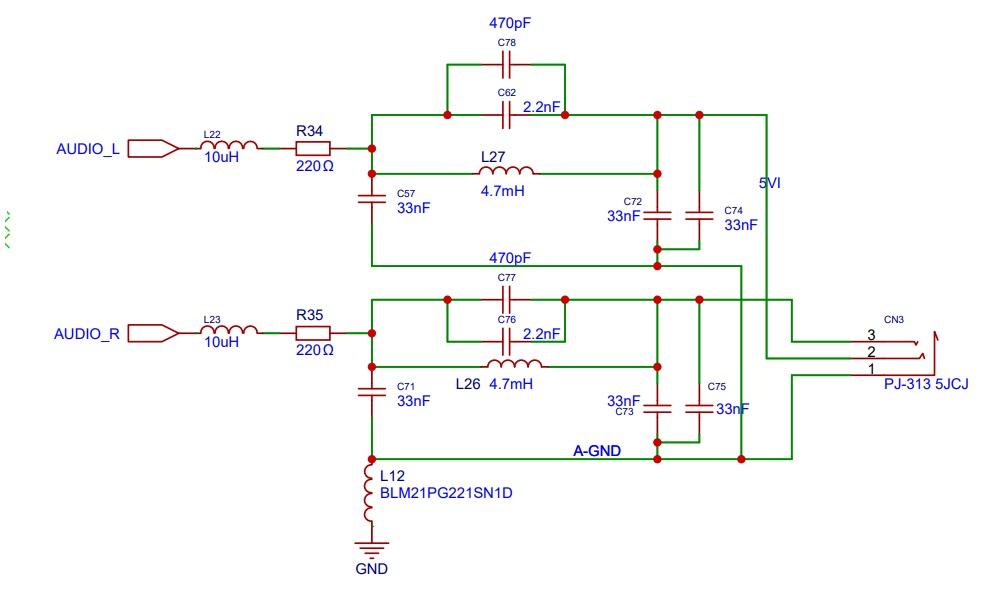

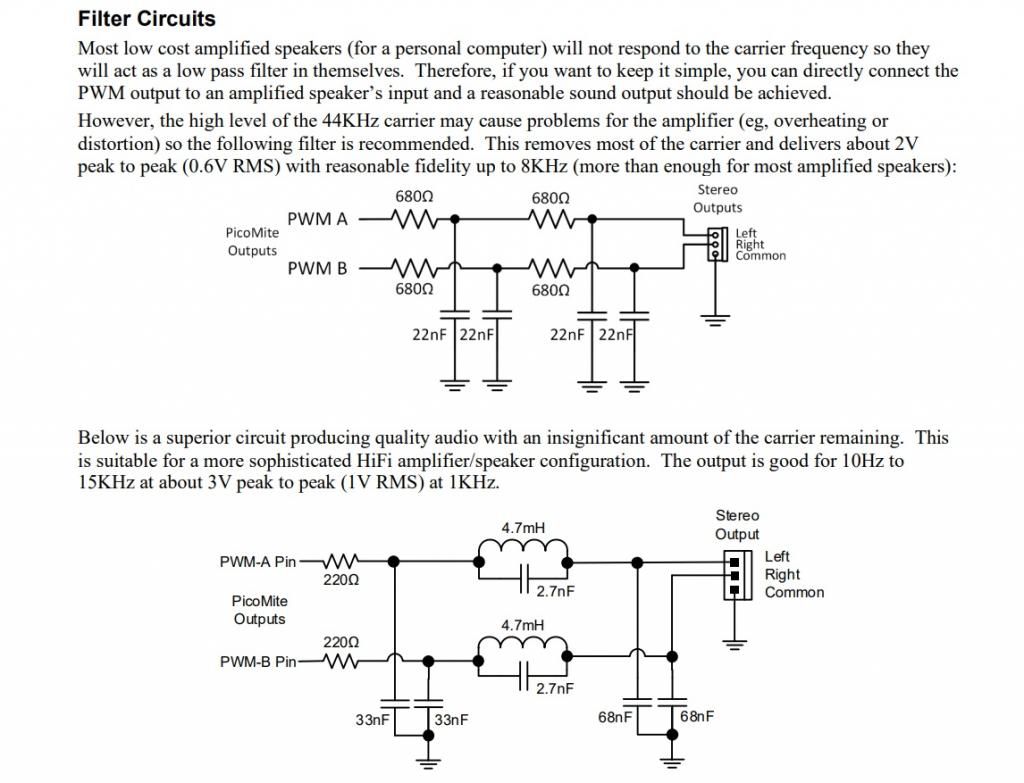

New audio filter circuit and usb-hdmi circuit

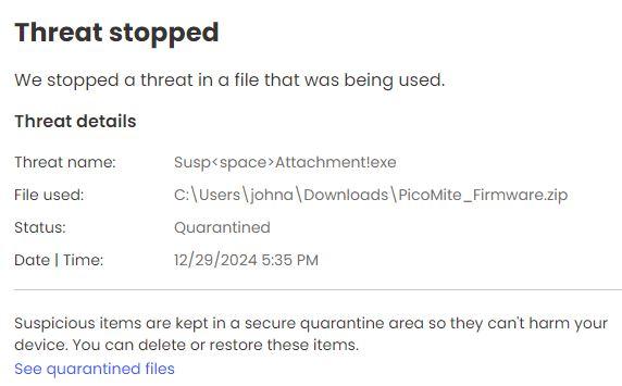

Humm... I got this from McAfee after the download... Anybody else..??
Posts: 3367
Posted: 11:59pm 29 Dec 2024
Mcafee needs to get a life.  As if Peter or I would insert a virus in this.
Geoff
Edited 2024-12-30 10:03 by Geoffg

  Geoffg said  Mcafee needs to get a life.  As if Peter or I would insert a virus in this.
Geoff
It was you who infected me with the mmbasic virus many years ago ;-)

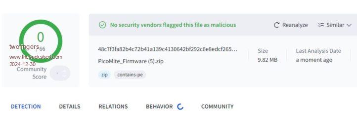

  Zonker said  ... Anybody else..??
Everything fine!
Michael
The lone and ...
Posts: 2807
Posted: 12:49am 30 Dec 2024
no probs for me with links to download earlier. hdmi usb 2350.
win 10, no defender message, do you want to run this file anyway.
I get defender message with vga demo progs posted but click run
Zonker
Joined: 18/08/2012
Posts: 772
Posted: 01:55am 30 Dec 2024
No problem folks..!!  I didn't mean to point the finger at anyone...
I just was wondering if anyone else got a hit... Okay... No worries then...
Edit:  So, I re-ran a scan on just this file and McAfee said nothing found..
      Humm.. So, Is McAfee a POS virus package..?? If so, What IS a good package..??
Edited 2024-12-30 12:03 by Zonker
