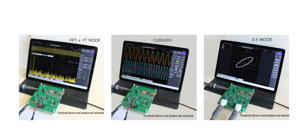

You can get a low-end scope for 150UKP. It has two channels, a proper trigger system, a 7 inch screen (beat that, Apple!), 1GS/s. (Although claimed to be 100MHz analogue bandwidth I wouldn't read too much into that :) ). Get a proper 'scope. It's far more useful and cheaper than many smart phones! It also doesn't have a battery of unknown condition in it, that could split the case anytime.
Don't get me wrong, things like Scopy have their place, but that place isn't where beginners should be going. Try measuring a 9V battery and you could (subject to any input protection) kill your phone. In this case (assuming a RP2040), feed in more than +/-1.8V and the Pico is dead. There is no attenuation and no protection.

  Mixtel90 said  I have to admit that when I see things like this I think "but why?".
You ship a PicoMite based product and you incorporate an extra Pico for Scoppy.
Client calls to report a malfunction
You connect to his Android device via TeamViewer and instruct him where to hang the probes
Now you are remotely observing the signal.
Very rarely do I need a scope for troubleshooting anymore but when it appears that the signals from a £10K motor/encoder might have failed, you don't want to tell your client to replace it "just to see"

As I said, this sort of thing has its place. Yours is what I would call a specialised application. As far as the youtube clip goes it is simply asking for problems though. No input protection whatsoever.
Even in your case I'd suggest a proper PCB, with input voltage clipping and a simple voltage divider on the input, possibly with the ability to switch it out if the input is guaranteed to be less than +/-1.8v. Control gear has a tendency to contain pico-frying voltages like 0-10V and 24V (AC & DC). Somebody *will* poke the probes into the wrong place. If you are lucky only the Pico will explode.  :)

Scoppy itself running on its battery-operated android device, is probably safe as it would mean out of spec voltages appearing on the USB connector. Only a possibility if the RP2040 seriously explodes. A mere burn-out of the ADC would probably protect it.
No, the problem is with that comes before the Pico pins. No pin can be driven above 3V6 (RP2040) or 5V (RP2350 but only if powered at 3V3 - and the ADC is still 3V3). In order to display the negative half of a waveform a virtual GND is produced from two identical resistors across the supply (which is also VREF). So your operational input limits are +/-1.65V. The ADC is less flexible than digital inputs.
I would start by setting the maximum input at +/- 1.2V. I'd do that by putting two reverse-parallel silicon diode pairs in series between the ADC pin and virtual GND - remember, we are using it as a differential input. The series resistor on the ADC input will limit the current through these if they are forced to conduct.
Now you haven't got a lot of input voltage to work with. An op-amp could give you several gains (x5 would be a good starting point), and a voltage divider before it can drop larger voltages, as well as also reducing noise on the input signal. A x5 gain over +/-1V basic sensitivity would give you +/-0.2V input sensitivity. I don't know how Scoppy works, but I'm sure there'll be settings. The potential divider could give you various steps.
See what I mean? Scoppy is only part of the solution. It's a display device, not a scope. You actually need a fair bit of hardware to turn it into a usable 'scope - and a Pico isn't it. That's just the middle stage that fits between the ADC and the USB display.

Posted: 06:27pm 31 Dec 2024
Oh, I've always been aware of the hardware requirements which is why I contacted them about the X 20 probes.
