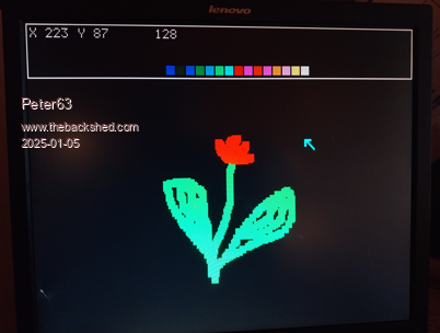

Is it possible to save VGA screen (content) to a file?
using: Pico2
PicoMiteVGA MMBasic USB RP2350A Edition V6.00.01R10
/Peter63

Posted: 05:42pm 04 Jan 2025
I'am using MODE 2 (320x240), VGA screen
tested Blit read 1,0,42,319,198
then Error: Not enough Heap memory
tested Save compressed image "pic1.bmp",0,42,319,198
crash , black screen , have to reboot Pico2
/Peter63

Posted: 05:53pm 04 Jan 2025
Tested  Save compressed image "pic2.bmp"
it works  jippi
Why didn't it work with, Save compressed image "pic2.bmp",0,42,319,198
i only want to save a part of the screen
/Peter63

  Peter63 said  I'am using MODE 2 (320x240), VGA screen
crash , black screen , have to reboot Pico2 ...
save image "pic3.bmp"
would work.

Posted: 06:10pm 04 Jan 2025
Tested again and it works with: Save image "pic1.bmp",0,42,319,198
This saved the part of the screen i wanted
