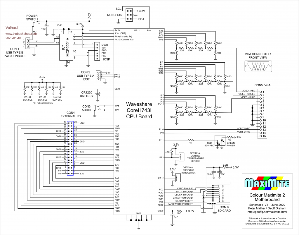

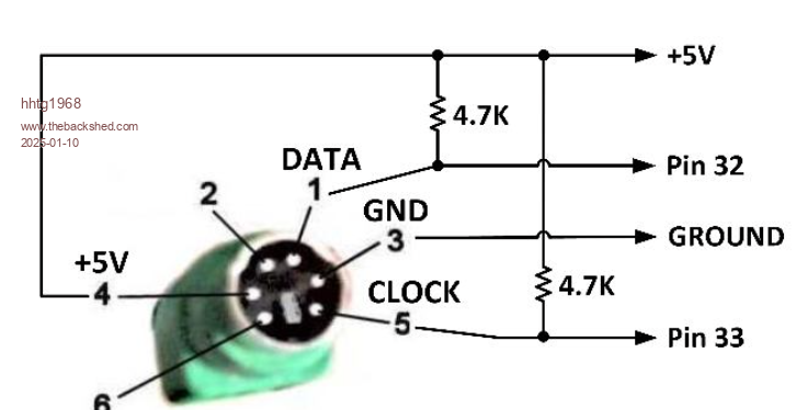

Hello. I want to connect a ps/2 mouse to my cmm2 gen1.
in the documentation i found an doc image.
i can connect to pin 33 and 32 and ground on the gpio. but where can i connect the 5v from the mouse?
there are 3.v pins, no 5v pins...

Posts: 4354
Posted: 03:50pm 09 Jan 2025
I think it means you need to provide 5V.
Posts: 8965
Posted: 04:05pm 09 Jan 2025
Pin 2 or pin 4 (manual page 10)
TBH I don't remember the CMM2 having any support for PS2 at all...
Edited 2025-01-10 02:12 by Mixtel90
Posts: 5995
Posted: 04:07pm 09 Jan 2025
Hi
+5V is available at pin 2 and 4 of the 40 pin connector.
Posts: 8965
Posted: 06:38pm 09 Jan 2025
My brain must be going...
Of course the CMM2 supports direct connection of a PS2 mouse. Technically it's a USB mouse that supports the PS2 protocol though. It works fine - I modified my CMM2. It's on channel 0.

Posted: 08:22pm 09 Jan 2025
  Volhout said  Hi
Thank you very much.

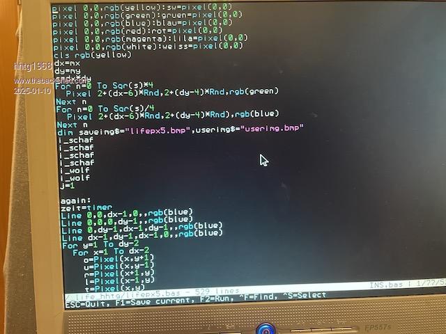

Posted: 09:11am 10 Jan 2025
And it runs well...
you can see the mouse "cursor"...
Thanks again.
