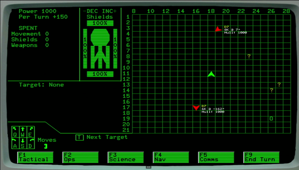

Hi,
I don't know much about colour blindness, so I'm looking for some advice. In the screen shot below, there are two distinct colours of ships (green and red) on the map area. Green is friendly, red is enemy.
Forgive my ignorance, but can you tell which is which?
Being able to distinguish between them is going to be central to the game, and I know red/green is an issue. So I'd rather fix the mechanic now before it become a problem.

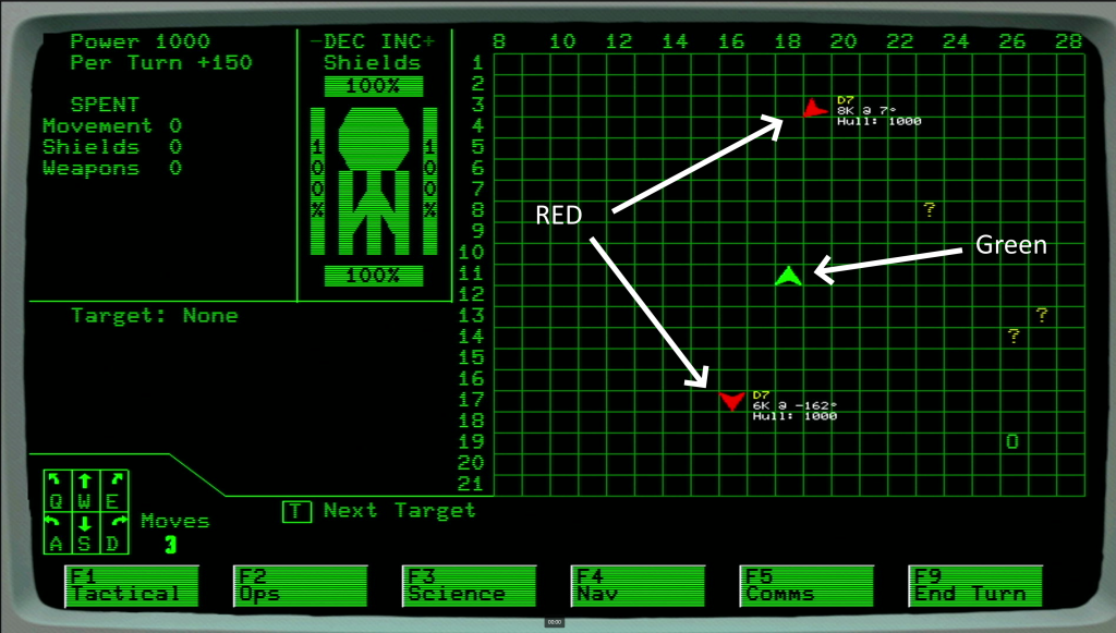

For clarity I have marked which ships are which colours in the image below.

I can see the difference on the shots. I am Red/Green colour blind, for me as things get further away I have more problems with telling the differnce.
For someone like me Blue/Yellow would be easier to see.
We have maps of where fires are where I live. I often have problems telling which triangles on the maps are red and green.

I am not color-deficient but work as a vision researcher. Adding some blue to both channels may help. For scientific figures (e.g. for pictures, where two information channels are overlaid to illustrate if anatomical structures are colocalized) magenta vs cyan is often recommended.

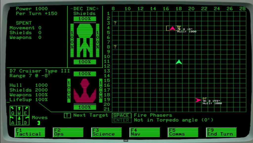

I took your advice Thomas, and to be honest, I think the little bit of blue makes both the red and green "pop" a lot more. Picture below with adjusted colours. Hopefully it also helps for colour blind users. Thank you for that very useful bit of knowledge!

Hi Pete, the adjusted colours look better, the Red has a pinkish tinge to me now, and the green has more of a yellowish tinge.
I have trouble seeing red flowers on green trees at any distance, very close up I can see them but they don't stand out much.
I used to mistake the brown for the red when playing snooker too. Then I worked out that the red balls were shinier than the brown one.
Your idea of allowing people to remap the colours to suit themselves seems like a good one

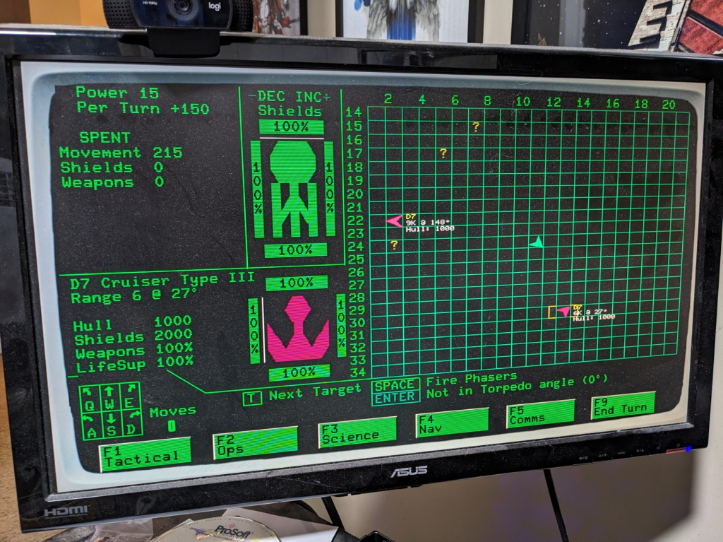

I also noted, that my screen capture device mutes the colours quite significantly compared to the actual monitor image.
Here's a photo of the monitor (I know that my camera is also changing the picture - but it's a better representation than the previous screen shots).

I hate to be "that guy", but that silhouette looks like a D12 Bird of Prey rather than a D7 Cruiser .

  thwill said  I hate to be "that guy", but that silhouette looks like a D12 Bird of Prey rather than a D7 Cruiser .
Ha ha ha! You are right sir! And I love that you are "that guy". Because it was indeed modelled on a bird of prey. I was originally going to have a variety of Klingon ships - but now that it's no longer a Star Trek game, I might have to come up with some original designs.

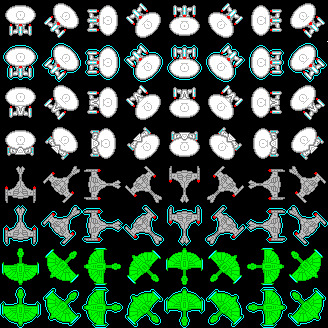

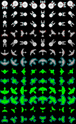

Apropos of nothing very much here are some assets I created 30+ years ago for a Visual Basic game that never went very far:
Edit: The cyan outlines are for cloaked ships.
And the full set of assets including some less interesting UI elements:
GRAPHICS.zip
Edited 2025-01-11 04:44 by thwill

The green ship on the green grid is a problem. If you are keeping the green grid, you should make the green ship some other color that contrasts, like the red ship does. It will make it easier to quickly track the green ships on the display.

  thwill said  Apropos of nothing very much here are some assets I created 30+ years ago for a Visual Basic game that never went very far:
Very nice Tom.
I am trying to restrict myself to just using fonts and Pet-SCII (Max-SCII?) type characters. But they are excellent graphics and I'm sure somebody could use it to re-skin the game.
