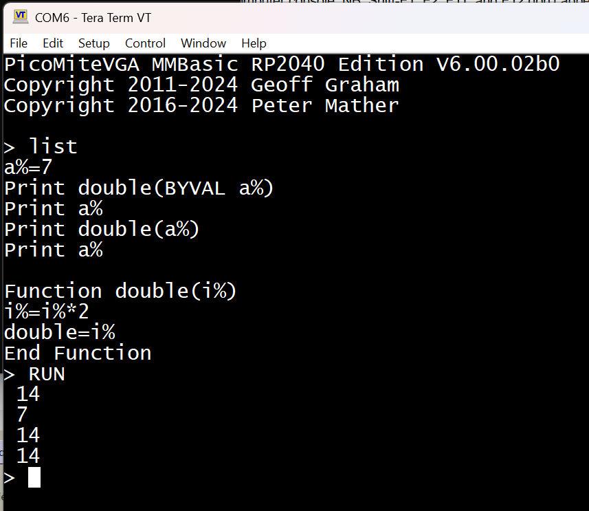

I've also played with this - does it make sense?
Note that BYVAL is effectively a unary operator and must be included in the call and can't be specified in the subroutine itself

  matherp said  I've also played with this - does it make sense?
Note that BYVAL is effectively a unary operator ...
Do we need that? Isn’t that identical to
a%=7
Print double((a%))
Print a%
Print double(a%)
Print a%
Function double(i%)
 i%=i%*2
 double=i%
End Function
Isn't a note in the manual enough?
I wouldn't, but <shrugs shoulders>. Is there a particular difficulty in adding adding it to the SUB prototype like VB ... though even then I do wonder whether you should.
a%=7
Print double((a%))
Print a%
Print double(a%)
Print a%
Function double(i%)
 i%=i%*2
 double=i%
End Function
Yes! But using an unary operater like "ByVal" would be more expressive!
  matherp said
  Quote  Is there a particular difficulty in adding adding it to the SUB prototype like VB
Yes!!!!!!!
Maybe you should consider in advance whether using it as a "unary operator" when calling a sub/function could prevent a future use of "ByVal" in a sub/function prototype declaration?
If that were the case, perhaps use a different name for the "unary operator"? E.g. "AsVal"?

Peter,
BYVAL is a great addition, but it really must be a qualifier in the definition of a SUB (not in its call).  If you like, I can develop the code for it so that it would be a drop in lump of code for 6.00.02.
