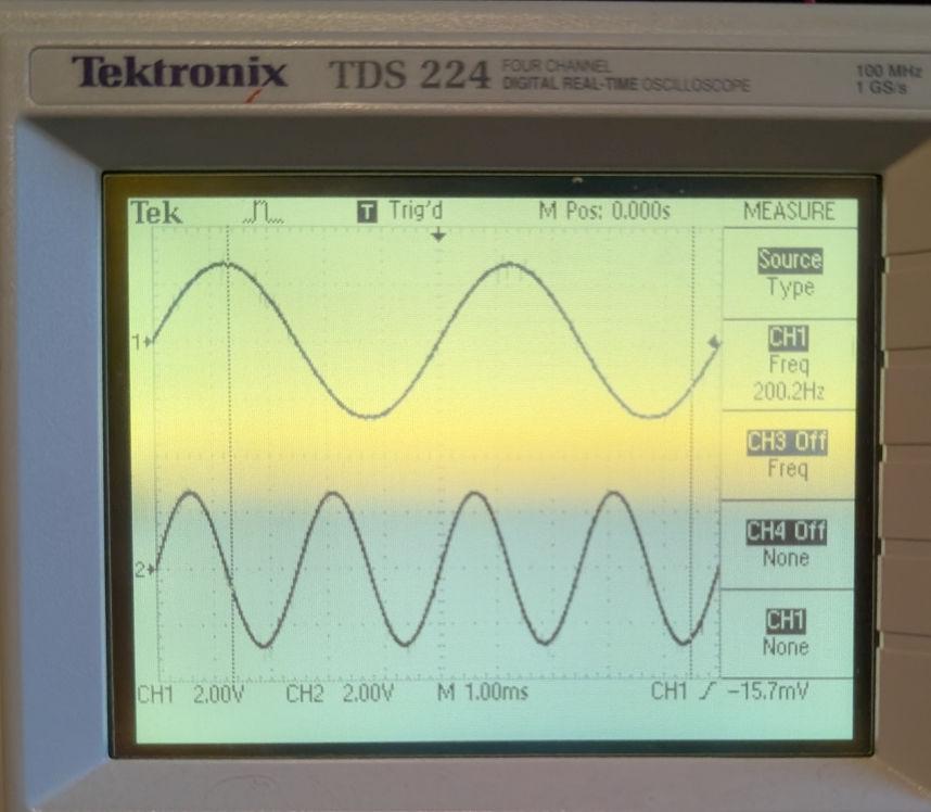

PLAY TONE 200,400

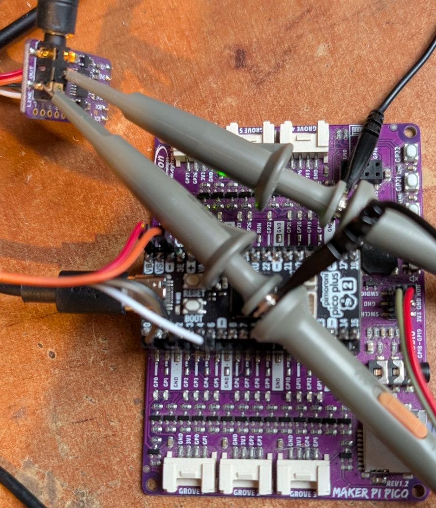

@javavi:
At what cpuspeed are you running the setup? I've just made a setup with a PCM1502 chip (seems to be the same board as Peter is using in the foto of his setup) on an Pimoroni RP2350-plus and encountered some strange effects:
at e.g. cpuspeed 252000 kHz and MP3 playback i get clicking noise and a "phasing-like" effect between left and right channel. Makes me dizzy with headphones and almost hurts my ears.
at cpuspeed 206000 kHz the sound is audibly less distorted as far as i can tell. Minor fast clicks are audible though.
The clicking can also be reproduced with play tone command, but not the phasing effect. That appears only on mp3 playback.
Are there any restrictions to the mp3 compression used?
Is the TDA1387T showing the same effects? MMBasic Version is V6.00.02.b3
