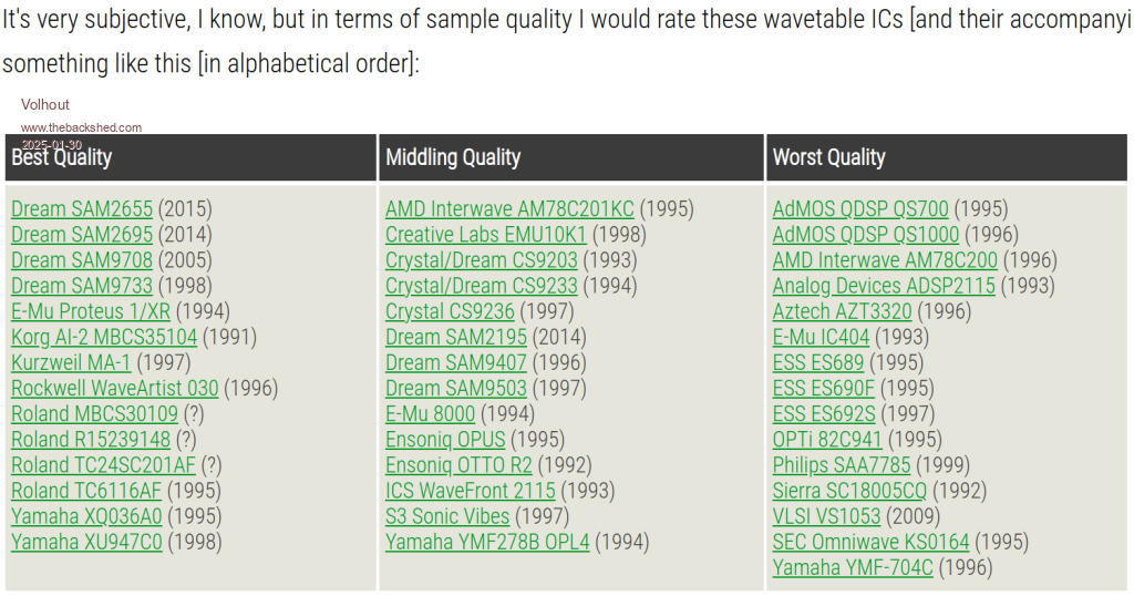

@Peter,
There is a sound quality difference between the 1053 that is implemented in PicoMite, and the SAM2695 when it comes to MIDI.
See this
I can imagine people looking for the SAM chip.....
source
Edited 2025-01-30 07:15 by Volhout
