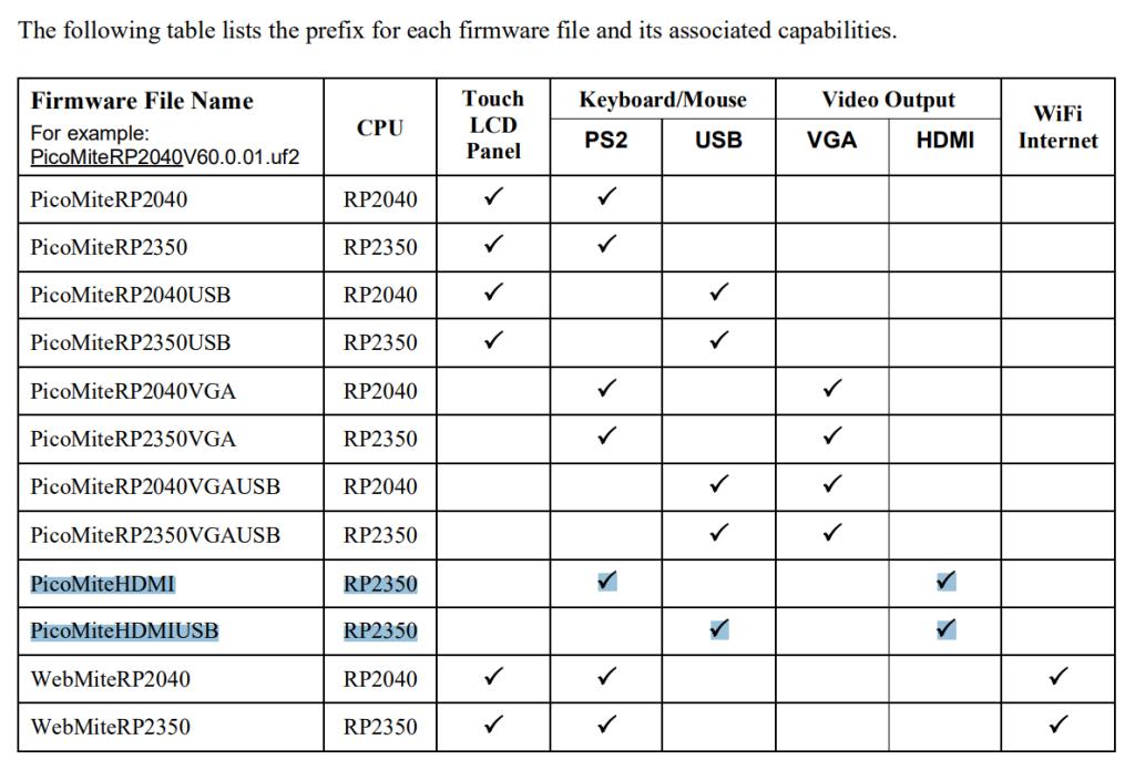

Hello everyone,
I have now ordered a Raspberry PI Pico 2 (RP2350), because apparently these uf2 files can only be installed on such a device, but not on my Raspberry PI Pico (RP2040):
- PicoMiteHDMIV6.00.01.uf2
- PicoMiteHDMIUSBV6.00.01.uf2
I could install one of these uf2 files on my Pico (RP2040 ):
- PicoMiteRP2040V6.00.01.uf2
- PicoMiteRP2040USBV6.00.01.uf2
- PicoMiteRP2040VGAUSBV6.00.01.uf2
- PicoMiteRP2040VGAV6.00.01.uf2
but then the components of the Olimex RP2040-PICO-PC are not supported, right?
So now I'll wait until the new Pico 2 is delivered...
I'm pretty sure that everything will work right away ;)
My only problem was that I didn't know that the uf2 files PicoMiteHDMIV6.00.01.uf2 and PicoMiteHDMIUSBV6.00.01.uf2 require a Pico 2, or could I have read that somewhere?
Actually, it would have been enough if the two files had been named like this:
- PicoMiteRP2350HDMIV6.00.01.uf2
- PicoMiteRP2350HDMIUSBV6.00.01.uf2
Posts: 11827
Posted: 06:27pm 10 Feb 2025
  Quote  My only problem was that I didn't know that the uf2 files PicoMiteHDMIV6.00.01.uf2 and PicoMiteHDMIUSBV6.00.01.uf2 require a Pico 2, or could I have read that somewhere?
Manual - page 5
ManiB
Joined: 12/10/2019
Posts: 168
Posted: 06:48pm 10 Feb 2025
Manual - page 5
You're right, I had overlooked that. Very good documentation.
Nevertheless, it would be better if these two files also had the CPU names in their names.
