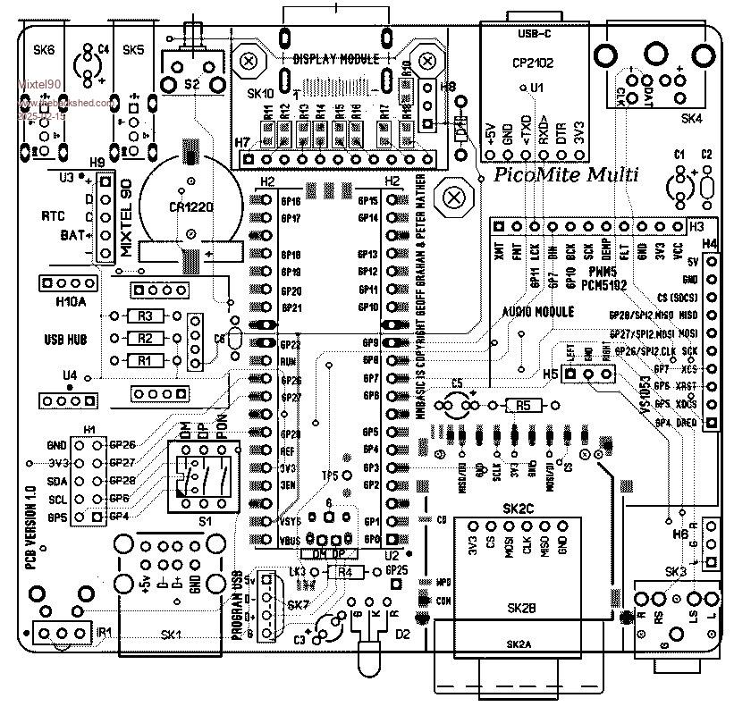

If you only ever build one PicoMite compatible system it may well be this one. :)
PicoMite Multi Construction Pack.zip
This is the result of an idea from one of my previous posts.

Oh, I agree completely. The alternative is to surface mount everything or to have your own modules made. I don't think most home constructors are too happy with either of those alternatives. I for one have problems if resistors get down to 0805, never mind anything else.
Of course, it's equally likely that the rest of the hardware will be out of date before the modules become unavailable anyway. Electronics has a relatively short commercial life but the Chinese are happy to produce their el cheapo modules so long as there is a demand for them.
The only module I had any difficulty in getting was the Adafruit one. The Chinese ones were no trouble, but for some reason that particular one is not that easy to find in the UK. That's why I included the option of on-board HDMI.

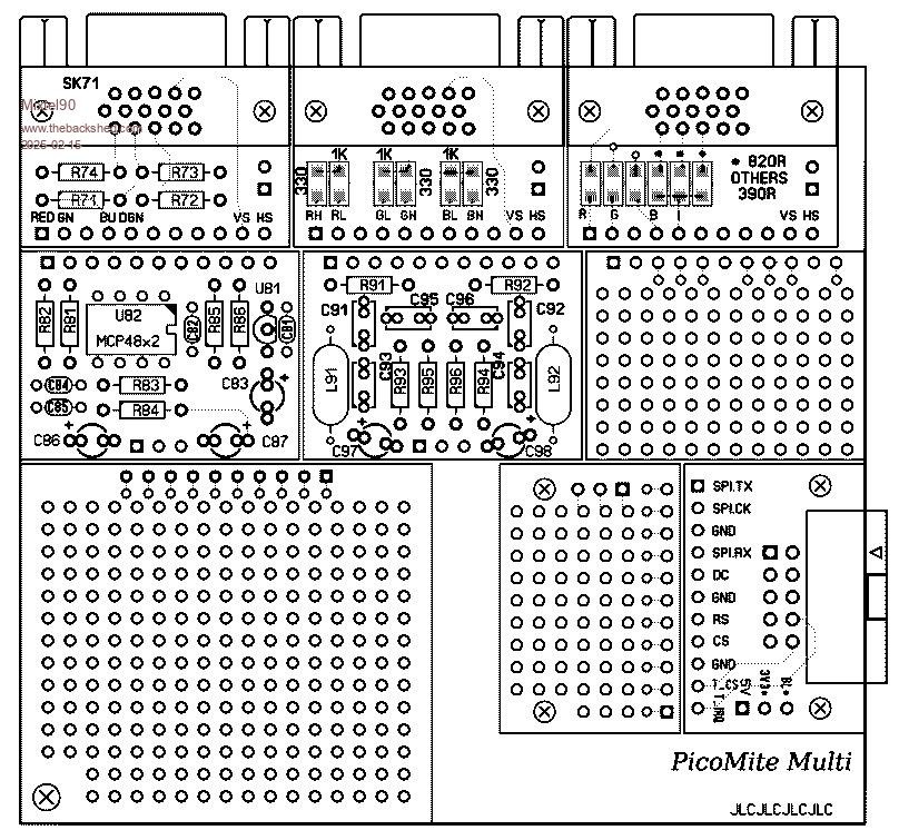

Yeah, same old Pico on a 100x100 board. Yawn. This on gives you a choice of just about any pin-compatible Pico clone, a choice of display and audio systems and the opportunity to create your own of either. Throw in a 4-port USB hub, PS2 keyboard socket and IR receiver and it just gets a bit mad. :)
It makes an interesting test rig too. Just plug together the system that you want at the time, load the appropriate firmware and off you go. Doesn't matter if it's just a Pico or a Pico 2 with HDMI, the same board can be reconfigured at any time to do both.
Of, the padboards have the pads linked into strips bt thin tracks underneath. Treat them like stripboard with the advantage that you break the strip between the holes instead of at them. The strips aren't connected to anything, that's up to you.
