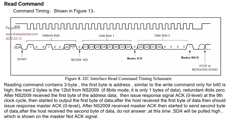

Here is the C program I'm trying to translate into mmBasic code
I want to be able to read x and y position from NS2009 in MMBasic

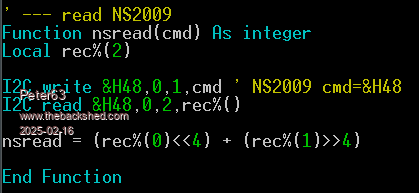

Posts: 6548
Posted: 09:25pm 15 Feb 2025
Assuming
option base 0
and I2C is opened at the start of the program and closed at the end
FUNCTION nsread(cmd) AS INTEGER
 LOCAL rec%(2)
 I2C WRITE &H48,0,1,cmd
 I2C READ &H48,0,2,rec%()
 nsread = (rec%(0)<<4) + (rec%(1)>>4)
END FUNCTION
Peter63
Joined: 28/07/2017
Location: Sweden
Posts: 199
Posted: 12:57am 16 Feb 2025
Reading from NS2009 now works / thanks Jim
/Peter63

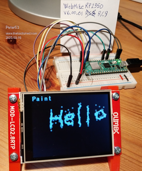

' Test program to read from NS2009
' 4-Wire Touch Screen Controller with I2C Interface
' using WebMite MMBasic RP2350A Edition V6.00.01RC9
CLS
Font 3
Text 0,0,"Paint"
SetPin GP0,GP1,I2C ' set I/O pins for I2C
screen_x_pixel = 320 ' 320
screen_y_pixel = 240 ' 240
Dim x As integer
Dim y As integer
Dim z As integer
I2C open 100,5000
z=nsread(HE0) ' read press-value
If z > 150 Then
 x=nsread(&HC0) ' read x-pos
 y=nsread(&HD0) ' read y-pos
 ' landscape mode screen_pixel flipped
 xx = Int(x * screen_y_pixel / 4096)
 yy = Int(y * screen_y_pixel / 4096)
 Circle yy,xx,2,1
End If
Loop Until Inkey$<>""
I2C close
End
' --- read NS2009
Function nsread(cmd) As integer
Local rec%(2)
I2C write &H48,0,1,cmd ' &H48 = address NS2009
I2C read &H48,0,2,rec%()
End Function
/Peter63
