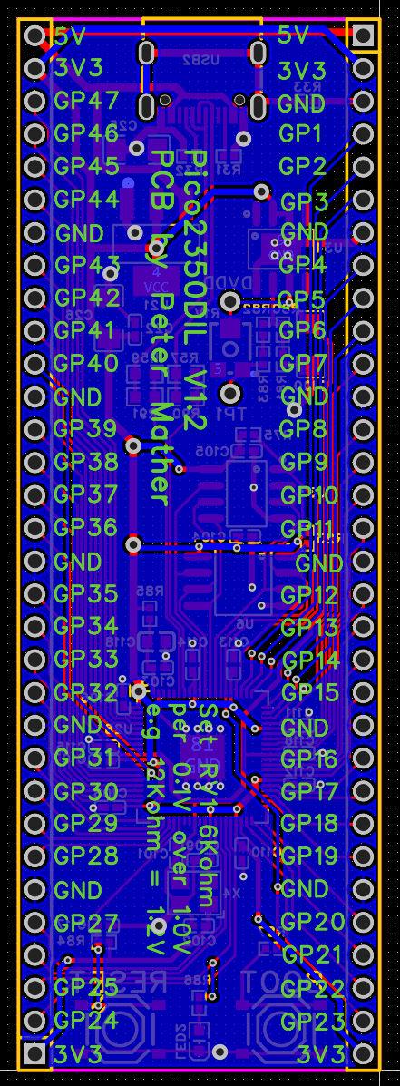

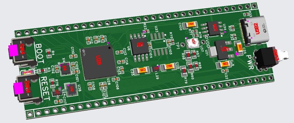

Before incorporating into more complex boards I thought it would make sense to do something to prove the design first. I'm using some different techniques from the Pico design guide but I think/hope they are better and should be more stable (overclockable). Not routed yet but would this be a useful form factor? Ignore the fact the headers are showing upside down. 64-pin 1" between rows

Posted: 08:05pm 20 Feb 2025
Looks perfect.
The problem with the other boards is that they are populated with features that I have no use for.
Posts: 8965
Posted: 10:22pm 20 Feb 2025
That's very nice indeed. I can see it being popular.  :)

Posted: 10:26pm 20 Feb 2025
I like it a lot!! Watching for the next move....
Posts: 3323
Posted: 10:43pm 20 Feb 2025
Yes, more practical layout than the PGA2350. Perfect for embedded controllers.

Posts: 9996
Posted: 05:13am 21 Feb 2025
Nice one, my son!
U33?
I2C EEPROM footprint?
RTC?
EDIT: Sorry - asked before I looked at the schematic - PSRAM chip.

Posts: 2991
Posted: 10:10am 21 Feb 2025
  matherp said  I'm using some different techniques from the Pico design guide but I think/hope they are better and should be more stable (overclockable)
Looking good there - I like your circuit around U34 and i reckon you’re onto something there regarding it making a big difference to ‘stability’.
Watching with great interest.
FYI - I have a very stable ‘complete setup’ based around the RP2350B XL Stamp exposing all GPIOs. Proof of concept built on stripboard and using multiple break-out modules. Your module here would be perfect to replace the XL Stamp….

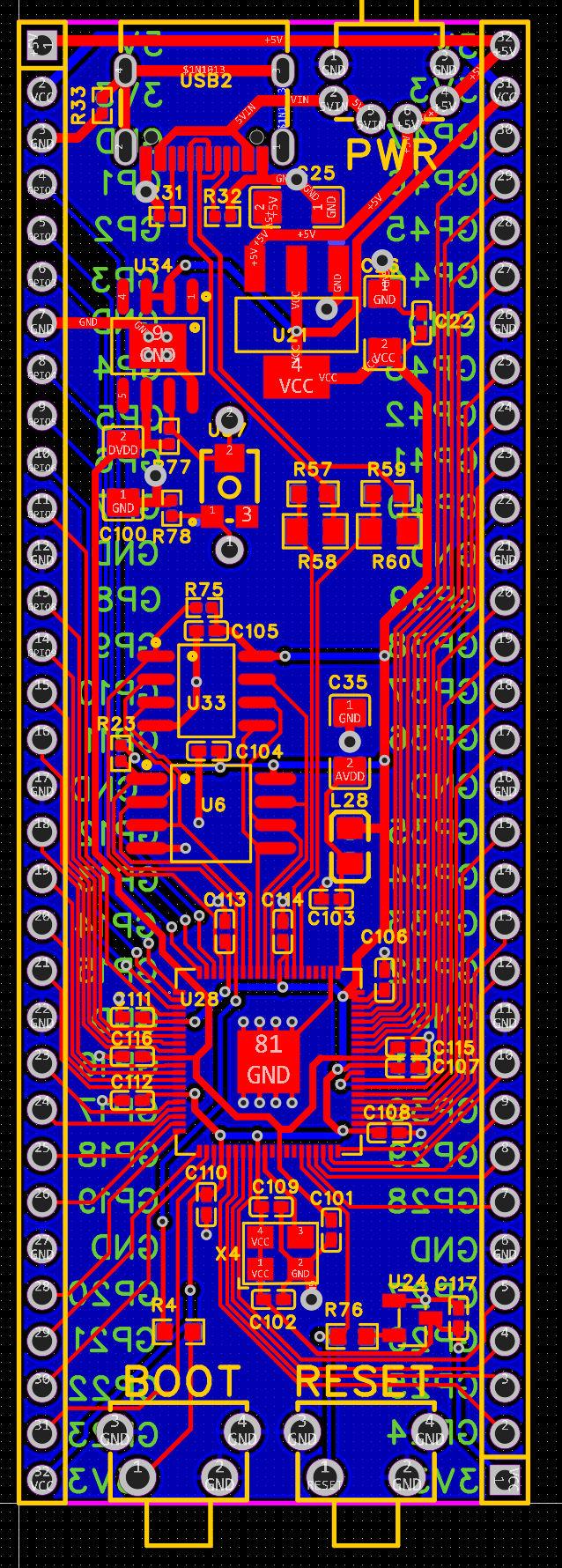

Posts: 11652
Posted: 11:45am 21 Feb 2025

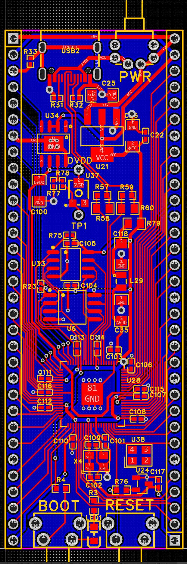

Here is the routed layout. Now I just need to persuade JLC to build it. At the moment they require you to use a specific crystal and inductor to meet the Raspberry Pi design guide but I don't want to do it that way. Worst case I will have to put them on the board unwired

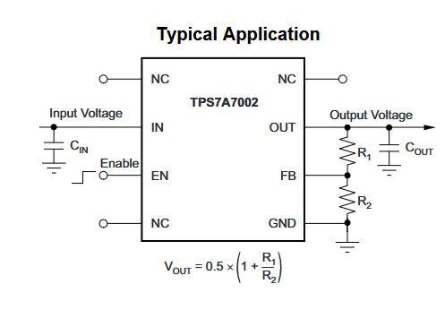

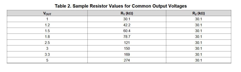

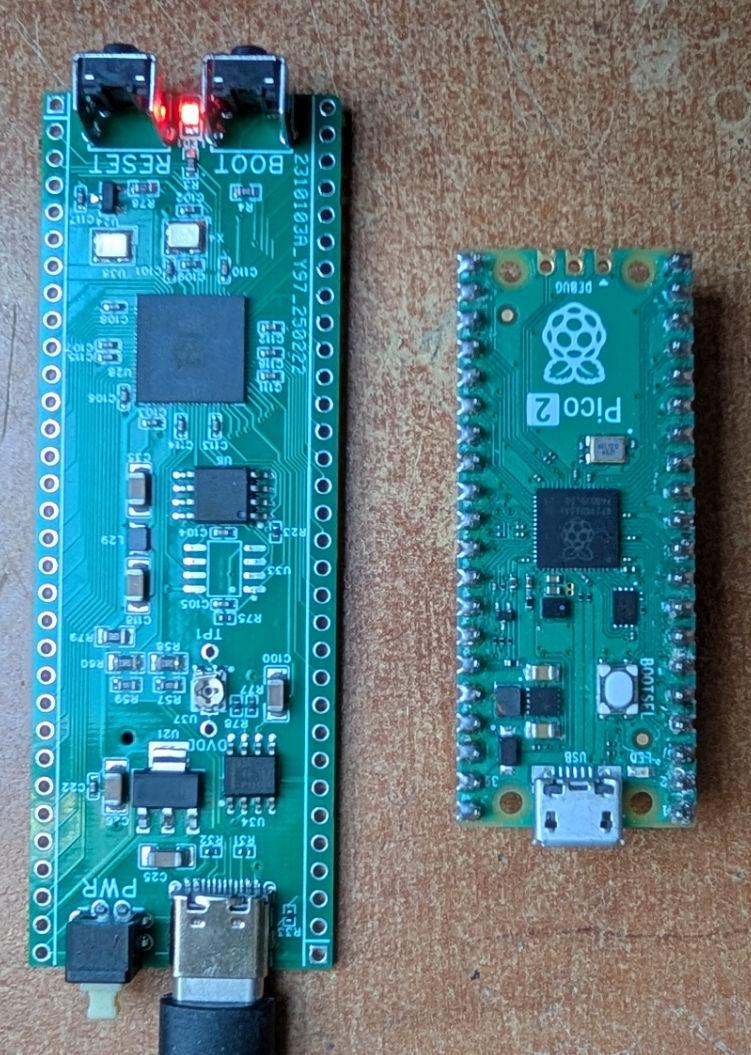

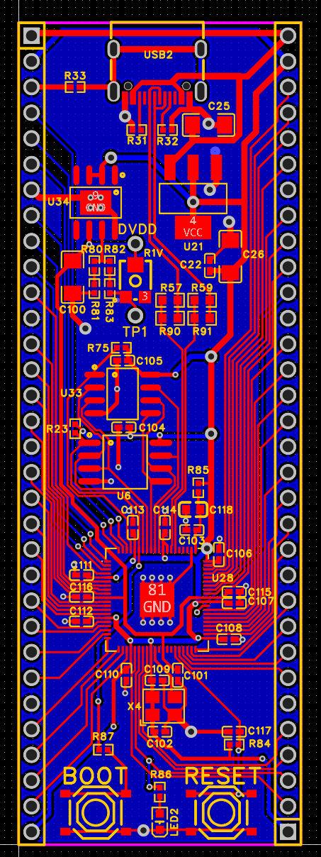

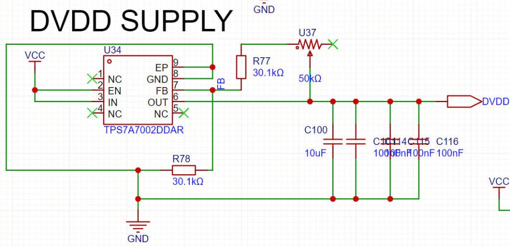

Here is the final version - now includes a heartbeat LED. I've ordered 5 so hopefully no errors. JLC don't have stock of the PSRAM chip (APS6404L-3SQR-SN)
so I've ordered those separately. SOP8 so easy enough to hand solder.
The two test points allow you to measure and set the variable resistor which controls the DVDD voltage. Set to 0 for 1V, 12.1K for 1.2V, 30.3K for 1.5V and if you really want to cook the chip 48.6K for 1.8V.

dddns
Joined: 20/09/2024
Posts: 875
Posted: 09:21pm 21 Feb 2025
Very nice design to me and I would buy it!
Maybe i cannot find them but i miss pinouts for reset and bootsel.
And it would be nice to make the psram cs configurable through solder pads or so.

Posts: 3323
Posted: 11:19pm 21 Feb 2025
  Quote   i miss pinouts for reset and bootsel.
Perhaps solder wires to the underside of the switches, or if using external switches replace the switches on the board with pins.
Posts: 2991
Posted: 09:33am 22 Feb 2025
@Peter,
Just querying the pot position to drive DVDD. According to the datasheet, your max voltage out is 1v. Should it be alongside R77 as opposed to R78?
Vout= 0.5x(R77/R78)
Just checking
Edited 2025-02-22 19:35 by WhiteWizzard
Posts: 11652
Posted: 10:37am 22 Feb 2025
Think its correct. R78 is R2, R77+U37 is R1
Posts: 8965
Posted: 10:59am 22 Feb 2025
It allows a deal of healthy over-volting. :) 1V to around 1V8 when the spec says 1V21 absolute max. I won't argue with that. They are allowing for 85C case temperature. :)
Posts: 3323
Posted: 11:23am 22 Feb 2025
A minor refinement may be to tie the free end of the trimmer to the wiper. In the event of the wiper contact point going open it will limit the voltage to 1.8V.
As it is now it will try to rise to Vin.
I don't know how fussy the regulator is to the value of the lower leg resistor but if the trimmer were in that leg the output would drop if the trimmer went open.
Posts: 2991
Posted: 11:38am 22 Feb 2025
  matherp said  Think its correct. R78 is R2, R77+U37 is R1
Yes, this is correct (I was purely going on your pdf schematic that show R77 by itself (and the pot with R78).
Do you have an ETA for your first batch? I know many people here will be very interested in your RP2350B module….
Posts: 8965
Posted: 11:44am 22 Feb 2025
Both good points. R2 should be kept between 27K and 33K according to the spec.
