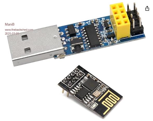

The Colour Maximite 2 User Manual describes on page 10: "ESP-01 Module
There is a footprint on the PCB for connecting an ESP-01 WiFi module to COM2. Version 5.07.00 and later of the firmware allows COM2 to be used as a serial console so if the correct USB/UART code is loaded into the ESP-01 it will be possible to access the console of the CMM2 remotely.
At this time MMBasic does not include any Internet functions using this device in but communications can be established using the normal serial communications protocol included in MMBasic
What is not mentioned, however, is what exactly this “correct USB/UART code” means.
Probably another topic that I should actually know about, but unfortunately I don't have a clue again. Searching the forum for the keyword ESP-01 also brought some interesting posts to light (1 or 2), but it didn't help me.
Can anyone tell me which USB/UART code I need to copy to the ESP-01 WiFi module?
I have ordered this module including programmer: ESP-01 Prog WiFi Programmer
Many thanks in advance.

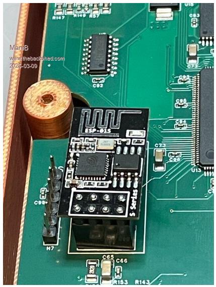

Posts: 3817
Posted: 01:42am 05 Mar 2025
I don't think you want the AT firmware. I think you want ESP-Link. Maybe check this link
Also search the forum for CMM2 and ESP-Link.

  lizby said  I don't think you want the AT firmware. I think you want ESP-Link. Maybe check this link
Ahh, ok. Thanks for the hint. I'll give it a try this evening...

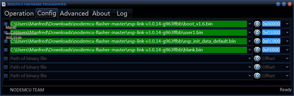

#### 2. Flash ESP-Link to the ESP-01
- **Download Firmware**:
 - From the ESP-Link releases page, download the `.bin` files for your ESP-01’s flash size:
   - For 1MB (black PCB): Use the full version (e.g., `esp-link-v3.2.x-1M.bin`).
   - For 512KB (blue PCB): Use the lite version (e.g., `esp-link-v3.2.x-512k.bin`).

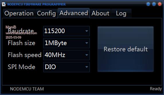

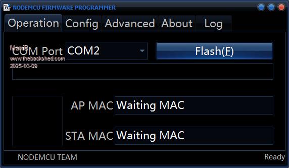

- **Connect the ESP-01**:
 - Insert the ESP-01 into your programmer (VCC to 3.3V, GND to GND, TX to RX, RX to TX).
 - Set the programmer switch to “PROG” mode.
- **Flash the Firmware**:
 1. Open the ESP Flash Download Tool.
 2. Load the firmware:
    - Select the `.bin` file and set the address to `0x00000`.
    - Example: `esp-link-v3.2.x-1M.bin` at `0x00000`.
 3. Configure settings:
    - Flash Mode: DIO (or DOUT, depending on your ESP-01).
    - Flash Size: 1MB or 512KB (match your module).
    - Baud Rate: 115200.
 4. Click “START” to flash.
 5. After completion, switch the programmer to “UART” mode and reset the ESP-01 (remove and reinsert it).

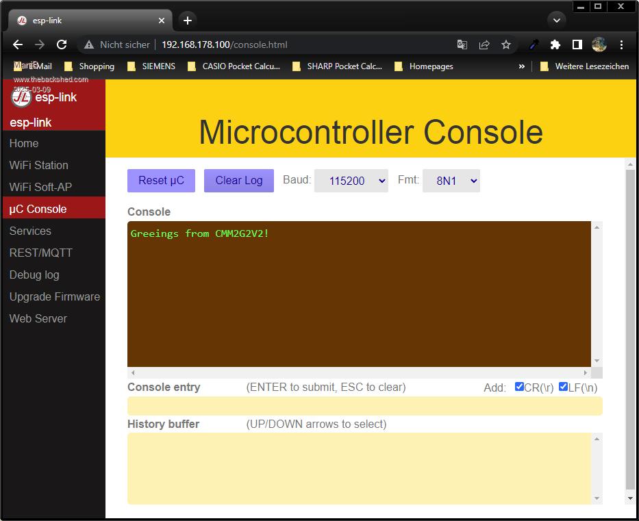

#### 3. Configure ESP-Link
- **Initial Setup**:
 - Connect to the ESP-01 via serial terminal at 115200 baud (default for ESP-Link).
 - Power it on. It should output debug info. If not, try 74880 baud (ESP8266 boot messages sometimes use this).
- **WiFi Configuration**:
 1. The ESP-01 will create a temporary WiFi access point (e.g., `ESP_XXXXXX`).
 2. On your computer or phone, connect to this WiFi network (password is often `12345678` or listed in the ESP-Link docs).
 3. Open a browser and go to `192.168.4.1`.
 4. In the web interface:
    - Set the ESP-01 to Station mode and connect it to your home WiFi (enter SSID and password).
    - Save and reboot the module.
- **Verify Connection**:
 - After reboot, the ESP-01 joins your WiFi network. Check its IP address via the serial terminal or your router’s device list.
#### 4. Install on CMM2
- **Physical Connection**:
 - Place the ESP-01 into the CMM2 G2’s ESP-01 footprint (ensure TX on ESP-01 connects to RX on COM2, and RX to TX).
 - The CMM2 should power the ESP-01 at 3.3V via the footprint.
- **Baud Rate Matching**:
 - ESP-Link defaults to 115200 baud. Check the CMM2 manual or firmware notes (v5.07.00 or later) for COM2’s default baud rate.
 - If needed, adjust ESP-Link’s baud rate via its web interface (revisit `http://[ESP-01-IP]`) to match COM2 (e.g., 9600 or 115200).
#### 5. Access the CMM2 Console Remotely
- **TCP Connection**:
 - On your computer, use a TCP client (e.g., PuTTY in RAW mode or Telnet):
   - Host: ESP-01’s IP address (e.g., `192.168.1.100`).
   - Port: 23 (ESP-Link’s default for transparent UART).
 - Connect, and you should see the CMM2’s console output (e.g., MMBasic prompt).

Yes, I know, I've also the programmer.
You mean I don't have to flash the module at all?
I'll try to test the firmware first sending 'AT' + ENTER with PuTTY
Posts: 8965
Posted: 02:11pm 05 Mar 2025
Yep. Normally they respond to AT+ commands. Well, the ones I have do. :)

now I'm able to use COM2 over the air, like:
open "COM2:115200" as 4
print #4 "Greetings from CMM2G2V2!"

4. Start the nodemcu-flasher tool and make these configuration:
5. Check also the advanced settings
6. Start flashing
7. After flashing is complete, disconnect the ESP-01 module and put it in your CMM2 G2
8. Turn on your CMM2 G2, take your smartphone to establish a Wi-Fi connection with the ESP-01.
9. You can then open the web page http://192.168.4.1 in the browser to carry out the actual configuration: WiFi station, STA+AP mode, WLAN to which the ESP-01 should connect and the WLAN password.
10. The ESP-01 then connects to the WLAN and is assigned its own IP address (e.g. 192.168.178.100).
With the browser on your PC, this new IP address can be opened with http://192.168.178.100/home.html to make further settings.
