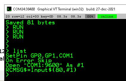

Can someone help me with this error?
On Error Skip
Open "COM1:9600" As #1
RCMsg$=Input$(80,#1)
ERROR: File number is not open
[303] RCMsg$=Input$(80,#1)
This is on a 2040 running MM.ver=60001
Am I interpreting the On Error Skip correctly?

On Error Skip only skips errors in 1 statement unless you specify more.
Try
On Error Skip 2
or
On Error Skip
Both should work.
PS You may want a 5 to 10mS Pause after Open to ensure the port is ready for the data.

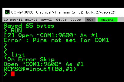

Posts: 10036
Posted: 03:25am 08 Mar 2025
Have you set the pins for COM1?
Manual page 175, Appendix A...
I get the same error, until I comment-out the ON ERROR SKIP command.
I suspect you have forgotten to assign the COM1 port pins.
The code then skips opening the port(cos it can't as the pins are not assigned), and executes the next line, which is you trying to suck data from the buffer - at which point the interpreter falls over and moans that the port is not open.
Edited 2025-03-08 13:28 by Grogster

It is my interpretation that I can use the On Error Skip prior to the Open command so that the program does not trip up if the port is currently Open. Does that make sense?

Please comment out the ON ERROR SKIP command, rerun the code, and see what error message you get...
If I set the COM port pins, and use your exact code, it runs without issue....
Edited 2025-03-08 13:35 by Grogster

  Quote  Please comment out the ON ERROR SKIP command, rerun the code, and see what error message you get...
The Result is:
ERROR : Already open

Posts: 10036
Posted: 03:49am 08 Mar 2025
My guess at this point, is that somewhere else in your code, the port is being closed before it gets back around to your original code problem you posted at the start.
At this point, I would probably be using flags(not ON ERROR SKIP) to tell your code when the ports are open and closed, then you can test the flags in your loops as your code runs.
