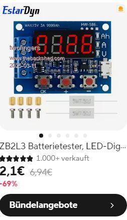

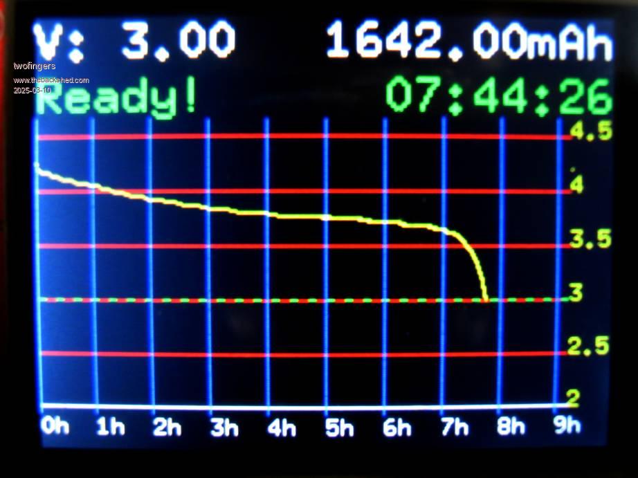

Actually, you only need a Picomite, a logic-level N-MOSFET (like IRL540), a load resistor approx. 18 ohm/1W, 2 * 470k as a voltage divider, 1x 100k and 1x 100nF.

That can work. But I think all you need is a suitable resistor and measurements every second and a shutdown at the threshold voltage. I built a device for measuring capacitance with MicroMites 9 years ago.

Firstly, a 18650 is not a primary cell (https://en.wikipedia.org/wiki/Primary_battery) and secondly, billions of devices (smartphones, etc.) work with these power sources and the 1 V difference. As I wrote, I (and Geoff too) published a circuit based on this principle almost ten years ago. They work excellently.
The small 2 EUR zb2l3 modules also work in a similar way. I have been measuring my 36V e-bike batteries according to the same principle for many years. You should check your statements.
As I said, I suspect a misunderstanding.

As long as the resistor is a constant value (we are not measuring the resistance) it is absolutely usable as an accurate sink.
We know the voltage at any time (that is what we measure), so we also know the discharge current (ohms law). So with every measurement we discharge the battery with a known quantity (not the same all the time, but known value), so we can calculate accurately what the cells capacity is. It may take 7 hours, or 8, or 10... doesnt matter. We know exactly the capacity...
twofingers project

Thank you for providing that link. I think that's what I need.
