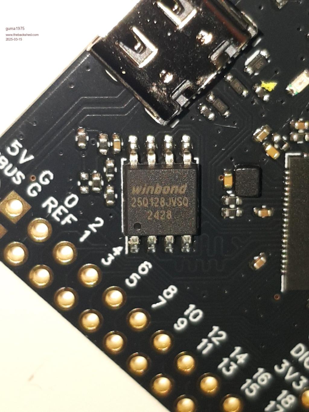

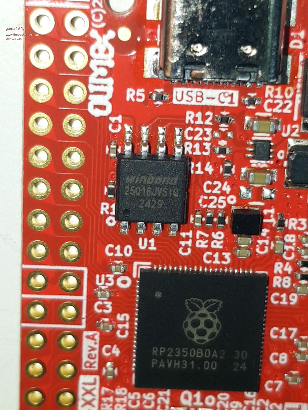

Hello.
I bought a few olimex modules.
Unfortunately the maximum CPU clock is 240MHz
option cpuspeed 240000 above it hangs or degrades to a lower clock.
However, I tested the Weact module from this link successfully at 378MHz.
Weact rp2350b
The memories differ only in capacity and are from the same family and company. I only wonder if it is not a problem of the length of the paths leading to this memory. In Olimex, pin 2 and 3 of this memory is shorter than 5 and 7. In Weact, there are visible zigzags of PCB paths on pins 2 and 3. Could this be the reason that Olimex does not work above 240MHz?

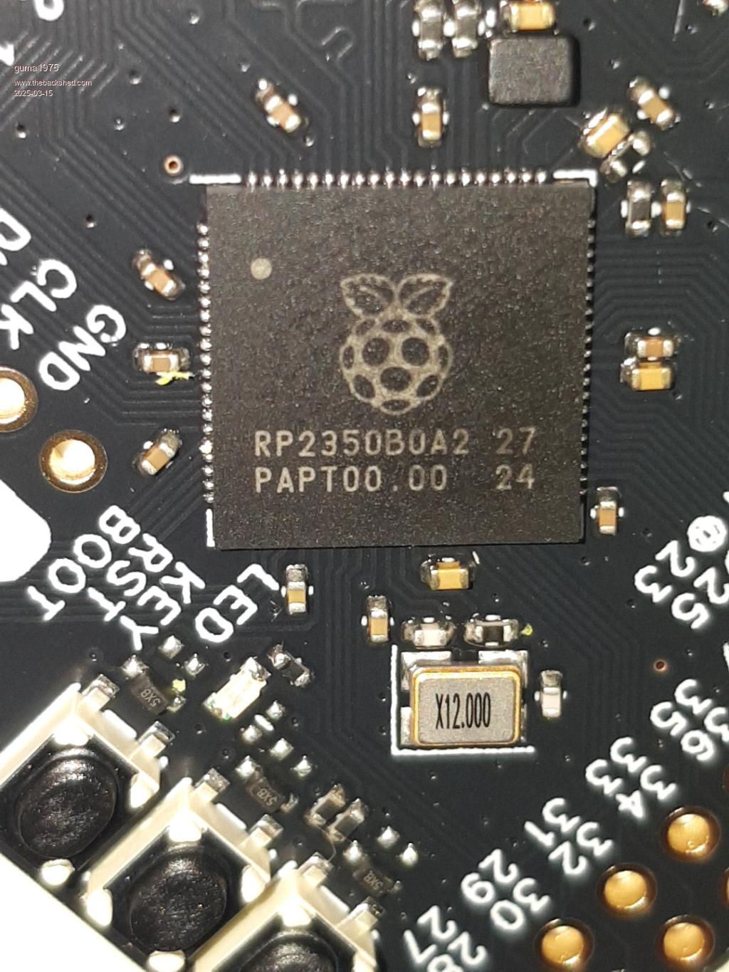

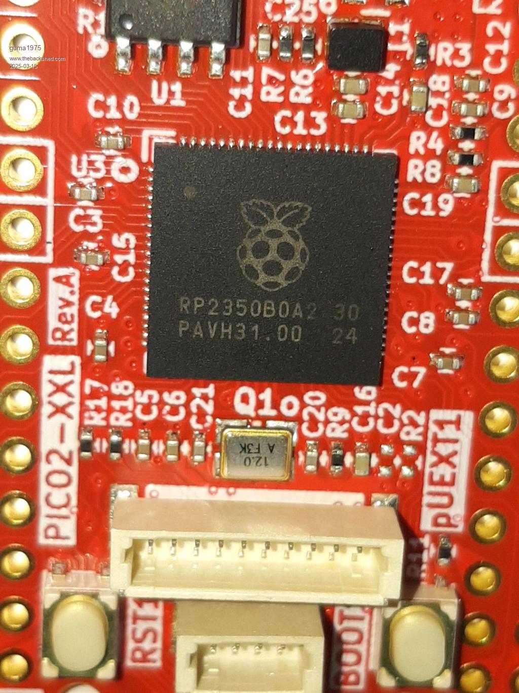

And photos of the rp2350b itself, the markings are the same. The only other ones are below the markings, maybe it's just the series?
Or maybe the core voltage is too low and maybe it can be increased a bit? Is it feasible? I wonder what you all think about this. Best regards.

Posted: 12:19pm 17 Apr 2025
I replaced the 25Q16 memory in Olimex with a 25Q128 from AliExpress and the speed at which the board works increased to 330 MHz, above that it doesn't work. That's a small success.

Posted: 06:51am 18 Apr 2025
No. I think pico won't start without this memory. From 25q16 there was only about 36kb for the program by issuing the files command.
From 25q16 max speed 240MHz from 25q128 max speed 330MHz.

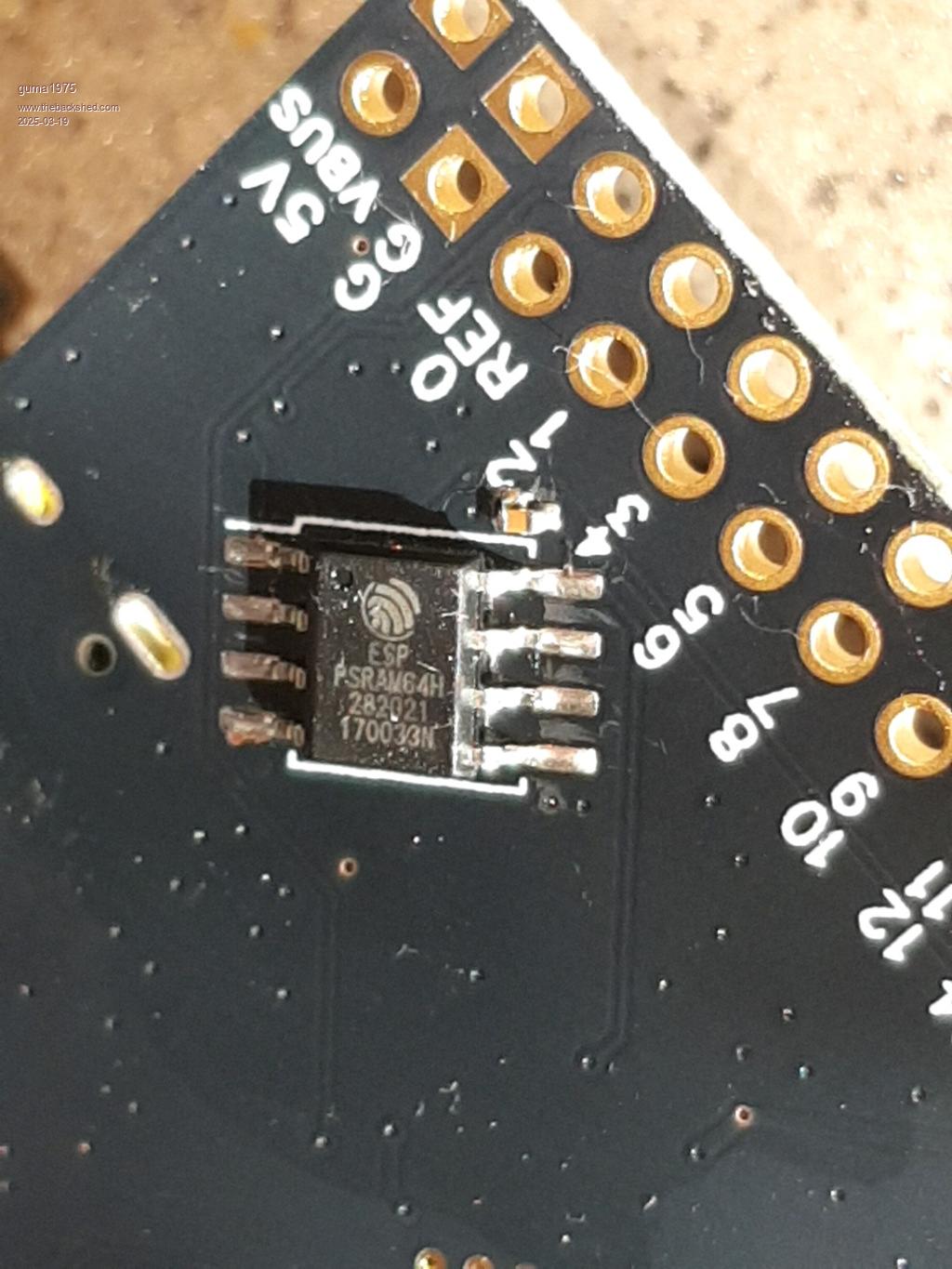

guma1975
Joined: 13/01/2023
Location: Poland
Posts: 16
Posted: 03:06pm 18 Apr 2025
Hello again, encouraged by the fact that in the olimex pico2 rp2350 XL, replacing the flash with 25q128 improved the state of affairs regarding the operating speed and the size of the disk A: I decided to add the same psram that I soldered to weact. Despite adding a pull-up resistor R16=10k and C26=100nF according to the diagram and soldering the psram, everything hangs after issuing the option psram pin gp8 command. Unfortunately, this pcb probably won't work with psram. I changed the psram to the second one again, maybe the first one was damaged. Unfortunately, it didn't work either. I checked if gp8 pin6 rp2350 is connected to pin1 psram - it's ok. The power supply is 3.28V but on pin 1 psram is sometimes 2.65V, I could check with an oscilloscope, but I didn't. If I sleep on it, maybe I'll figure something out.
