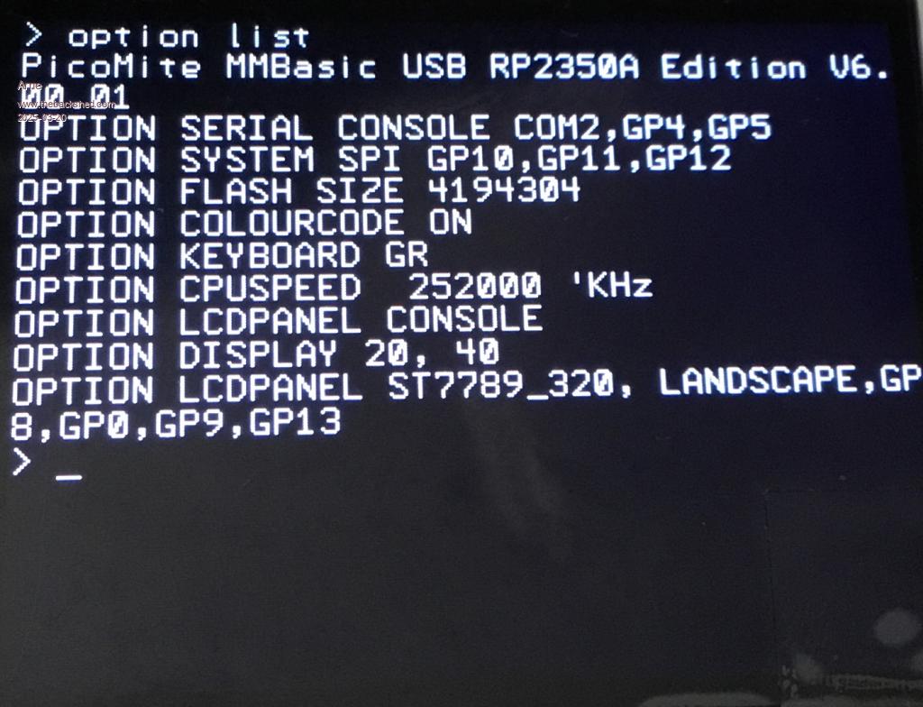

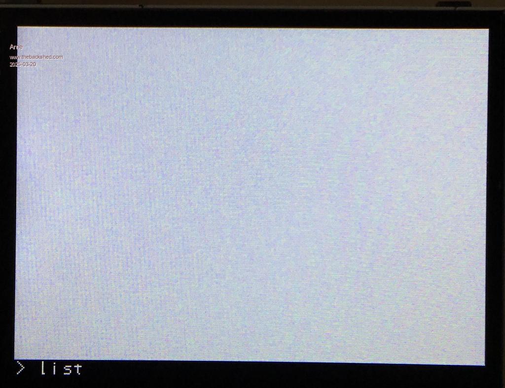

If a printout/listing reaches the last display line all the previous lines will be deleted? or covered in „white“.
The editor is working fine. Here I can scroll up and down without any display problems.
The adapted parameters/options are :
Technical data of the display: https://www.waveshare.com/wiki/Pico-LCD-2
Has anybody an idea/hint?

Your configuration is wrong
Use OPTION SYSTEM SPI GP10,GP11,GP28
OPTION LCDPANEL ST7789_320,l,GP8,GP12,GP9,GP13
OPTION LCDPANEL CONSOLE 1,,,,NOSCROLL
This is a c..p display because they haven't wired SPI MISO from the display so the framebuffer can't be read (unlike their 2.8" display)
See the manual page 92 for more info
