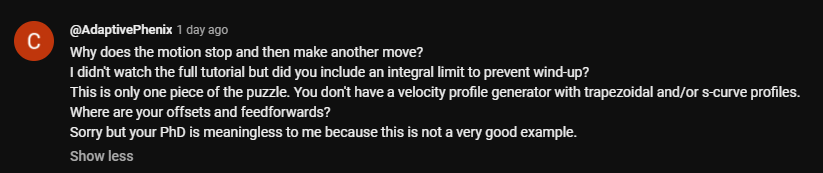

Something not right with this guy. Here's my comment:

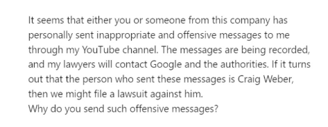

And so he went to my old LinkedIn and posted:
Where did I use "hurty" words?
I asked questions and he didn't answer a single one of them.
He is showing the worst performing example of a motor PID that I am able to find on YT and yet he insinuates that everyone else has got it wrong.
