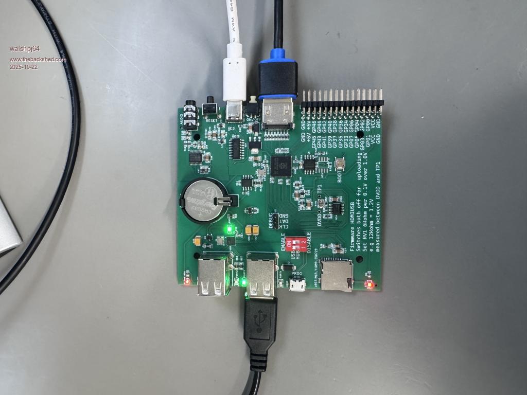

Hi, I also purchased a pre assembled board from SC for $81. RP23500B chip already soldered in. I used the firmware PicoMiteHDMIUSBV6.00.01.uf2 from SC which worked ok. Also set the DVDD volts to 0.1V above the 1.0V as stated.
The only problem i had was there was no HDMI output. Console was OK. Eventually tracked it down to Setting  OPTION HDMI PINS 1, 3, 5, 7  The wiring of the new on board to the HDMI was different from the old board with the plugin pico. Don't know if there will be a revised firmware for newbies like me. At least i have found this forum which is great.

On the board, there should be a OPTION RESET command silkscreened. If you execute this at the command prompt it should fully configure the board for you. Note that for higher HDMI resolutions you will need to set DVDD to 1.3V. measure between the DVDD test point and any convenient ground (SDcard socket cover)

Thanks for the reply. Yes I tried OPTION RESET HDMIUSBI2S  and it wouldn't accept the command. It replied invalid board for this firmware. I tried OPTION RESET HDMIUSB and it worked but did not show or set the HDMI pin option. After i entered it manually it worked. May have to get an updated firmware. I tried PicoMiteHDMIUSBV6.00.03.uf2 from https://geoffg.net/picomitevga.html but it did not work (heartbeat LED did not start after loading).
May have to look around for a more compatible version on the forum
Yes i did also find i had to slightly increase the DVDD voltage when using 1024 x 768 the pico was stopping without it.
just in the process of getting the SD card to work and it looks like i have to change the GPIO pins from 22, 26, 27, 28 to 29, 31, 30, 32.
I found the schematic which helps greatly.
Thanks for the tips.
Peter.

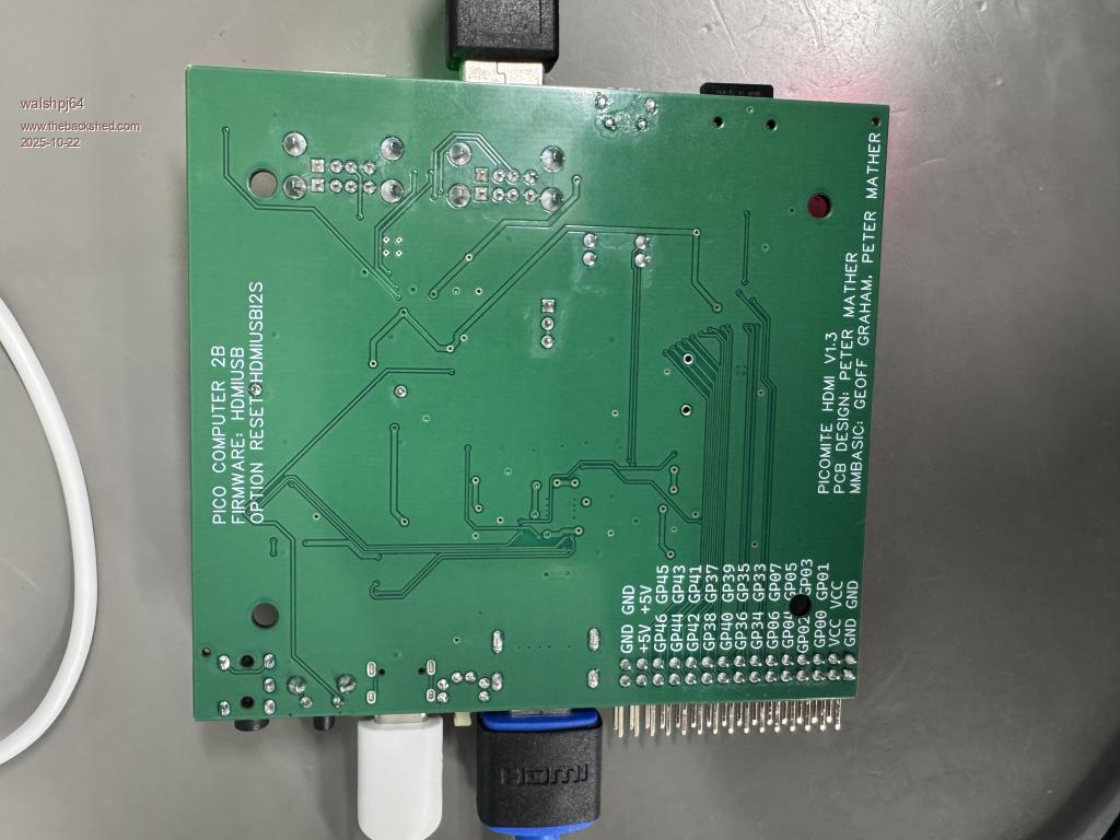

Posted: 11:01am 22 Oct 2025
Please post a picture of the board so I can help further.

Posted: 11:08am 22 Oct 2025
Hopefully the pics are OK.

Upgrade to a later version of the software. V6.01.00RC4 that I have just posted seems robust so try that. Then do the OPTION RESET HDMIUSBI2S and you should get

Awesome thanks, could not find V6.01.00RC4 but found V6.01.00RC5
unzipped and uploaded PicoMiteHDMIUSBV6.01.00RC5.uf2 OK. Noticed the heartbeat led did not start but the console session worked after dip switched restored and restarted.
did the  OPTION RESET HDMIUSBI2S
and WOW Yes all the following happened. Only issue is the USB devices will not work. No green LEDS and keyboard not working. SD CARD works though which is a bonus.

Just found the USB problem. Programming cable was still plugged in. Now All good Much appreciated.
Posts: 12059
Posted: 11:58am 22 Oct 2025
Make sure you have unplugged the micro-usb and plugged in a USB-C to provide power. Also make sure the switches are both set to on
