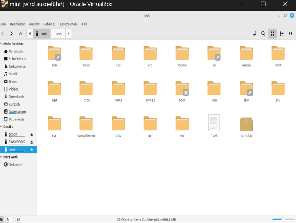

Martin H.
Joined: 04/06/2022
Posts: 1573
Posted: 10:41am 23 Apr 2025
  Quote  1. Have you tried configuring a wireless dongle and SSH'ing into the thing ? Depending on your answer to question 3 it may not be strictly necessary but I want to know what tools we have to work with.
I don't have a USBC WIFI stick or a suitable adapter at the moment, so the console is currently unable to connect to the network
  Quote  2. Are you running with one SD card or two (one for OS and one for ROMs) ?
EmuElec appears to be permanently installed in the console. I therefore have no access to the internal file system. The games are on the SD card (FAT 32).
To start Ark OS I have a 2nd SD card (one for OS and one for ROMs). Whereby I only have access to the boot and Rom partition with Windows.
  Quote  . Do you have a PC that can read the contents of the SD card and read/write to its file-system ?
Since I use windows this looks bad, the possibility would be that I can access the Linux partitions with the Raspberry PI.
  Quote  4. How much Linux do you know ?
The only thing I've been using Linux for a long time is the Raspberry Pi, so I would consider my level here to be “user”.Of course I have some experience with Mint or other Debian offshoots. In the terminal also on servers, but here always only worked according to default

Posts: 4405
Posted: 12:56pm 23 Apr 2025
You really did jump onto this wagon before I had the opportunity to attach the wheels .
  Martin H. said
  thwill said  1. Have you tried configuring a wireless dongle and SSH'ing into the thing ? Depending on your answer to question 3 it may not be strictly necessary but I want to know what tools we have to work with.
You're probably going to need one.
You might want to do some research on suitable Wifi adapters because apparently they don't all work with the R36S hardware.
I am using one that I have from several years back, an "Edimax EW-7811UN 150Mbps Wireless Nano USB Adapter" connected to an OTG Type C cable adapter with an additional USB extension cable to reduce the interference between the Wifi and the console's speaker.
  Martin H. said
  thwill said  2. Are you running with one SD card or two (one for OS and one for ROMs) ?
Hmm, I don't understand that. I don't think EmuElec is firmware so it should be on an SD card. How many SD card slots does the R36S Pro have, my standard R36S has one on the right which I have ArkOS on and one on the left that I have the ROMs on.
  Martin H. said
  thwill said  Do you have a PC that can read the contents of the SD card and read/write to its file-system ?
OK, you need to check out whether that is possible; you will need some way to copy files onto the device.
