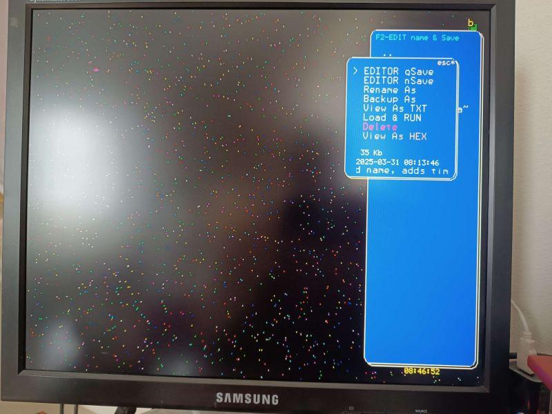

Hello, comunity.
I started slowly convert my navigator to game, so I feel I must lead my 'child' to public while it is not too late (before it will be more game and not util anymore)
It is nothing wrong about typing in cmd line 'save', 'load', and 'chdir' everytime but I am lazy about it. And thus, line by line, Navigator has born. Idea I had in the very begining when i started to bumble about need of some FM manager like CMM2 has.
This is beta beta beta release.
https://github.com/ElectriCatLt/MMBasic/tree/main/navigator

Hi electricat,
I was excited to test this, but when installing it I realized this will not work on a 2040 system. The RP2040 does not support mode 3. And (looking at the graphics in the last photo you shared) I think it will require significant re-write to make this work with tiles (MODE 1).
It is a pitty, but I hope others (especially Mick) will be delighted to see a navigator that is in a library, and does not use up all heap.
Keep up the good work, I am curious as you are about how it works for others.

  Volhout said  Hi electricat,
FREE heap while in use in MODE3 is ~150-180 kb! I 'monitored heap live' (kinda) using interrupts. Tried to balance tasks on fly as much as possible without touching memory too agressive. It could be done better as I see now.
If there will be any interest it`s matter of weekend to adapt util for 2040/SP2/VGA.
('family tasks' interrupts must be disabled at the time )
I designed initially interface do not use colors too much, but symbolic instead.
I need also re-think on some variable control. At some point I lost control on them.
using of LOCAL seems out of balance too.
I have some waweshare RP2040 spare with 16Mb flash .. wanna play and see how it could be used
Also it can be really more library space friendly. Maybe must make 'light' version, and clean out all toys I added while enjoyng and kinda playing in process

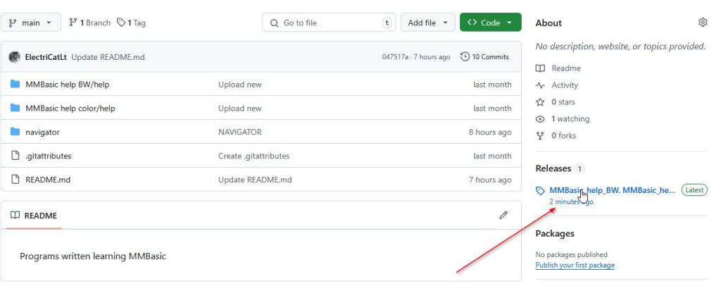

Added 'releases' for easy download
