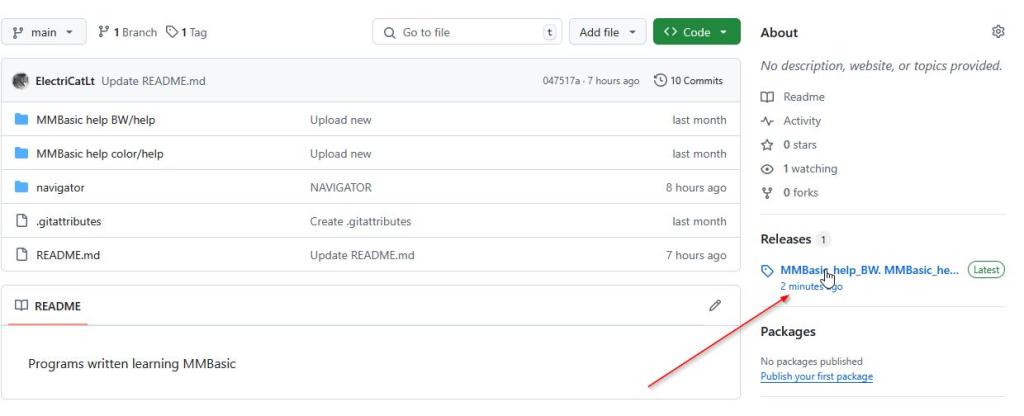

Hi electricat,
I will give it a try this evening. You can't imagine how often I open the user manual PDF to check exectly in what order parameters must be added to commands and functions. If this help provides that info, I will be very pleased. I am most interested in the monochrome version, since it most likely works on my 2040 VGA.
Is this also usable via the console ?
Are you sure I can download the files from your Git? I was not succesfull this morning.
Edited 2025-04-14 20:11 by Volhout
I just checked my signature 'My MMBasic 'sand box'' from another browser without github logins, and all seems to be downloadable. Please report if something wrong.

I also could not download from github (until I went up the tree to ElectriCatLt/MMBasic).

Oh..
I added releases for more easy download.

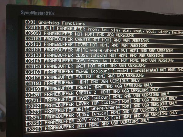

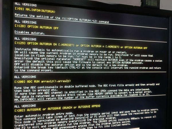

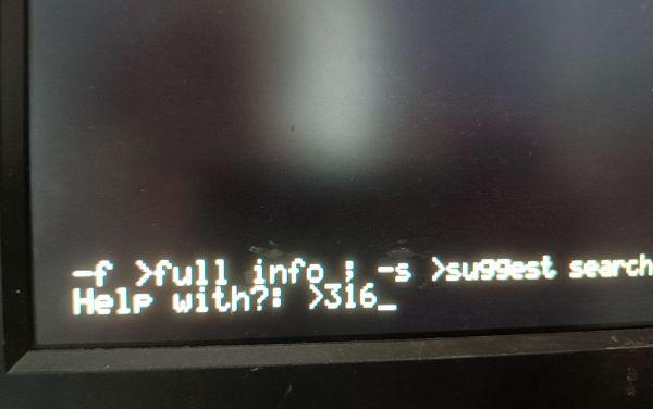

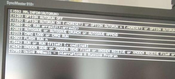

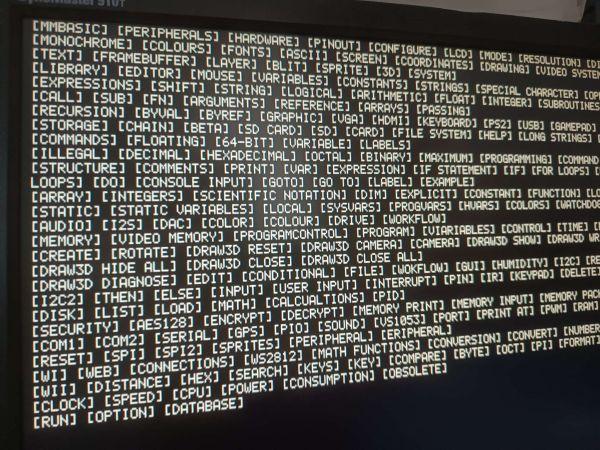

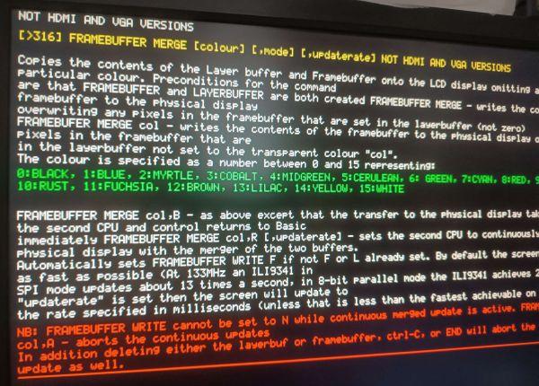

I wanted to capture how it works, but went into focusing problems, so some screenshots here.
effect if entered RUN as search keyword without any keys
search with key -f (lists full info)
BW version. Ok.. not totally BW, all BW except short description
Effect if entered search keyword FRAMEBUFFER (fithout -f key)
and you can read more detailed on topic entering >316
Colour version of >316
effect of just key -s
if there is no ideas what you are looking for

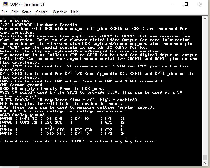

but unfortunately it doesn't work so well for me yet ... RC14 !
> help
ready
[>1] Predefined Read Only Variables
[>4] Using the I/O pins. DIGITAL, ANALOG, COUNTING Inputs. DIGITAL Outputs.Pulse PWM. COMMUNICATIONS INTERFACES (Serial, SPI and I2C).INTERRUPTS.
[>8] DISPLAY PANELS. SPI, I2C based LCD panels . 8-bit and 16-bit Parallel LCD PaControl. Touch Support. LCD Display as the Console Output.
[>9] Graphics Functions
[>18] Expressions and Operators
[>19] Subroutines, Functions, Passing Arguments by Reference,Passing Arrays,Early[>22] CONFIGURING THE KEYBOARD,USING A MOUSE,USB GAMEPAD
[>23] Program and Data Storage.Flash Slots.Flash Filesystem.
[>24] SD Cards
[>25] MMBasic Support for Flash and SD Card Filesystems
[>26] WI-FI
[>27] MMBASIC - Long Strings, Long String Variables, Summary of the Commands and [>28] MMBasic Characteristics - NAMING CONVENTIONS,CONSTANTS,IMPLEMENTATION CHARACTERISTICS
[>31] A Tutorial - STRUCTURE OF A BASIC PROGRAM
[>36] A Tutorial - The IF Statement
[>37] A Tutorial - FOR Loops
[>41] A Tutorial - Testing for Prime Numbers
[>45] A Tutorial - SCIENTIFIC NOTATION
[>49] A Tutorial - FUNCTIONS
[>58] MM.INFO() MM.INFO$()
[>59] MM.INFO$(AUTORUN)
[>60] MM.INFO(ADC)
[>61] MM.INFO(ADC DMA)
[>62] MM.INFO(BOOT COUNT)est search ; -x > exit ; -h >how to
[>63] MM.INFO$(CPUSPEED)
[>64] MM.INFO$(LCDPANEL)
[>65] MM.INFO(LCD320)
[>66] MM.INFO$(SDCARD)
[>67] MM.INFO$(CURRENT)
[>68] MM.INFO$(PATH)
[>69] MM.INFO(DISK SIZE)
[>70] MM.INFO$(DRIVE)
[>71] MM.INFO(EXISTS FILE fname$)
[>72] MM.INFO(EXISTS DIR dirname$)
[>73] MM.INFO$(FREE SPACE)
I found more records. Press 'HOME' to refine; any key for more.
> help display
Error : Argument list
> help "display
> help
[LIBRARY] Dim INTEGER PICOMITE=1
Error : PICOMITE already declared
There is no reaction here in particular:
"I found more records. Press 'HOME' to refine; any key for more."
Only Ctrl-C helps here via Console (I have no keyboard, only a mouse connected for testing!)
The correct output on the console (e.g. TeraTerm) would also be ingenious. Unfortunately, it appears confused.
But I love the idea!

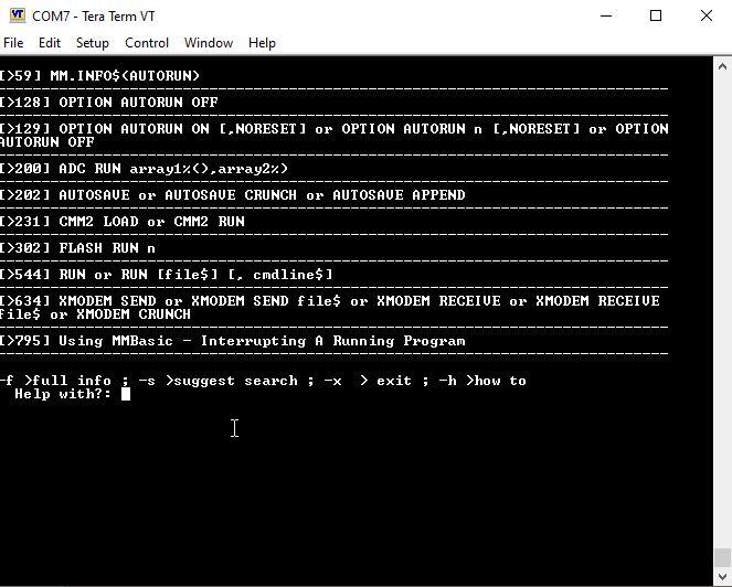

- There is quick terminal/ headless/RP2040 compatible version
So output to VGA screen would be quite ugly, while somehow usable still.
help_console_RP240_headless_20250416.zip
- Now all keyboard sents should work ok through terminal (no need external keyboard)
Will not return path however. Have no any ideas how to do it, yet.
