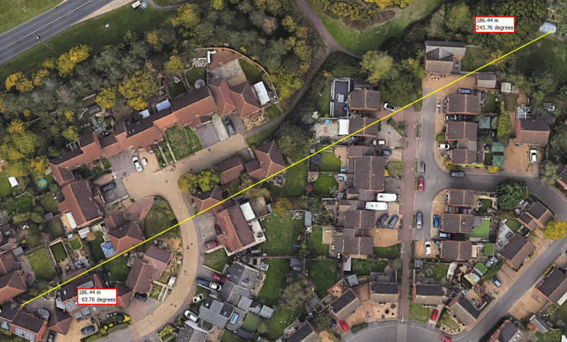

Afternoon forum - you are all well I trust.
I need to link a remote monitor to a data aggregator. Problem is it's almost 200m and not really LoS as there is one building directly in the way and the signal path skims across the face of several others. I have never covered this distance @433MHz let alone with some obstacles.
I think it's a big ask for my goto of HC-12 433MHz modules. I have considered using a couple of directional yagi antennae, the Tx would be about 8ft up and the RX about 10ft so fairly level which won't help with my blocking building. I am 75% confident the yagis would crack it but there remains a nagging doubt which is just going to gulp down cash in successive failures if I let it. The yagis are about £30 each.
So I start looking at LoRa - I have never touched it but the fantastic claims for range are very attractive - especially the "500m in doors". Now I am not so green as to think those are absolutes, but I am less than half that distance and mostly LoS.    I really am not interested in LoRaWAN right now (even though there is a gateway only a few miles away) as I don't want this to become "an internet thing". It needs to be point-to-point
I only have UART available and a lot of the LoRa modules seem to be SPI... which brings me to the HC-15. I really respect the HC01 manufacturer but their website remains stubbornly chinese with loads of graphics and hence resistant to google translate. Also, their stuff  gets faked to death.
Has anyone used these HC-15s? The internet and toobs seem devoid of any examples of use... or can suggest any other UART LoRa module? ... or even validate/defeat the prospects re the standard 433MHz link - maybe someone out there would say something like "walk in the park for HC-12s with a full-wave whip" or similar
I hopefully, will be in a position to do some testing with various set-ups shortly and maybe I'll be pleasantly surprised... but my luck doesn't roll that way much, so I am not hopeful.
cheers all

@JohnS yes it is a stretch for 100mW. I don't have control over the power, other than raising the voltage on the transmitter on one solution which seems a bit, "blunt" and I suspect could take me foul of the licence. So it's all about luck and antennae in the cheap seats, and if that fails then we up the game to more sophisticated modules, failure there means I could invest in a brace of small yagis ($$$) or look at LoRa which is totally new to me - It looks painless enough but I am scared of counterfiet parts soiling the tests and me being unable to tell either way.
@Supertech cheers for that link - I will investigate. I am bound by the licence-free ranges, want this as cheap as possible and not interetsed in licensing so we have to play nice. I am getting the message that it's all about the chip involved and a solution like that is much better than just "throwing power" at the problem.
@Volhout LoRa uses a spread spectrum tech and achieves astonishing ranges on tiny power. The "sacrifice" is bit-rate, but I need to transmit about 100chars each hour of daylight, so if I can get the link working, anything is acceptable but I think I'll get 2400 which would be excellent. Above this would be a dream.. I have used scores of HC-12s @433MHz in projects but they were all within about 20 or 30 metres of their "master" so distance like this is new to me. What I know about antenna design you could write on a stamp, although I have had very good results just using a single-wave whip made out of single core telephone wire to get flawless communication at 9600baud over about 30m - good enough to upload several kilobytes of program code without issue.

This is deinitely suburban. Residential to the south, warehousing/light industrial west, open countryside (for now) north and east with a highway in a cutting... so my plan is:
1. test with cheap crappy 433MHz modlues... don't judge, I have some on hand and with a full-wave whip might just be OK. The Tx are surprisingly good simple OOK devices - a bit messy but... it is usually the Rx that let's the side down. This is mainly me being cheeky and seeing if I can get it to work. Really tempted to skip this stage but it's an easy test and I'd like know if possible - I have read about people getting these to 300m LoS with a balanced dipole both ends, so who knows, sub 200m, almost LoS... if you squint at it and accept lofts are mainly empty space with some wooden bits... I actually think the line-up on the signal path is remarkable apart from that first building.
2. same test but with HC-12s... my first "serious" attempt to do it without LoRa. Again I have HC-12s on hand and I think the chips involved will make the absolute best of what can be had (from experience). If the Lora thing wasn't available I would focus on the antenna here but I think that has probably become un-necessary (saving me 60 quid)
3. I have a couple of HC-15 LoRa modules coming. If they do what they say, I think they will be the end of my tests if 2 fails. Actually, if they arrive before I am ready to do the tests, I will probably skip 1 & 2. I expect good things but I am worried about the lack of chat out there about these HC-15s specifically and the prospect of picking up a couple of duds.
4... 5... will very much depend on the outcomes of 1-3 but I think it will go down the LoRa route regardless. I will have to see. If I get to this stage and it still isn't working, I have plenty of info to proceed with.

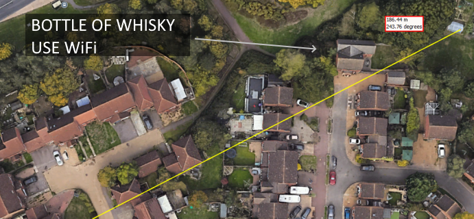

My solution is about 70 pounds (give or take), but probably fairly foolproof.
Bring a bottle of whisky to this house here. Tell the owner what you want to do and offer the bottle of whisky in exchange for tapping into his WiFi.
If he refuses - you still end up with a bottle of whisky - so there's no way you can lose out.
CaptainBoing

PeteCotton
Joined: 13/08/2020
Posts: 667
Posted: 09:06pm 15 Apr 2025
  CaptainBoing said
but I like your thinking
