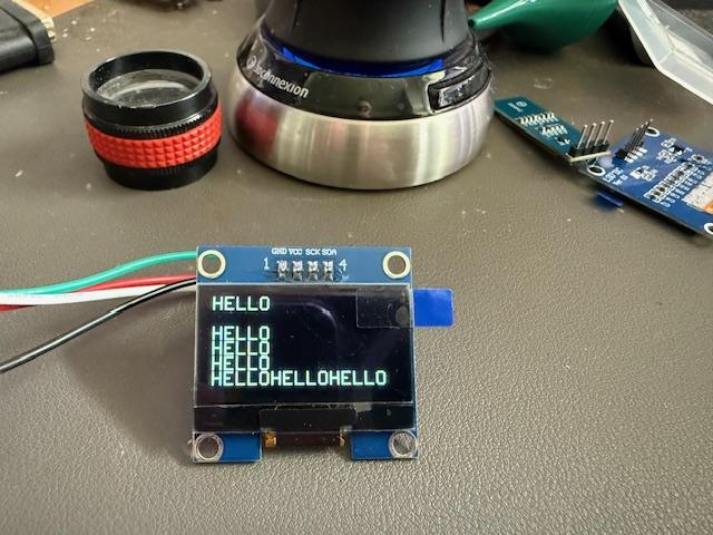

basic version 6.0001 , rpi2040
The manual says many modules are wired wrong without explaining exactly what is wrong. It's also not explained what base address the built in routines expect.  (0x3c or 0x3d)
Display is attached to physical i2c1 (not i2c0)
option system i2c gp18,gp19 ' i2c1 port as system port
option lcdpanel ssd1306i2c,1,2
i2c2 check &h3c ' returns 0 so the device is there
comment : the naming of the i2c devices is confusing.
i2c means physical i2c0
i2c2 means physical i2c1

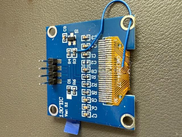

i rewired the display to 0x3d and
i2c2 check &h3d ' returns 0 if display wired to 0x3d
Nothing appears on the display.
Tried line and text commands.
it would be good to be able to set the base address for the system display.
like:
option lcdpanel ssd1306i2c,1,2 ,&h3c
option lcdpanel ssd1306i2c,1,2 ,&h3d
any ideas ? any leads on what displays are known to work. ( 1.3inch. need 128x64 )

i had to bodge mine on the flex as the D2 trace was hard strapped under the flex.
trial code:
PicoMite MMBasic RP2040 Edition V6.00.02RC18
OPTION SYSTEM I2C GP18,GP19
OPTION CPUSPEED (KHz) 200000
OPTION LCDPANEL SSD1306I2C, LANDSCAPE, 2

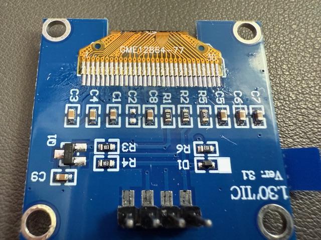

Attached display with ssd1315 (1.3inch oled):
https://goldenmorninglcd.com/oled-display/1.29-inch-oled-128x64-ssd1315-gme12864-77/
sold on amazon
https://www.amazon.com/dp/B09ZP6MLWR?ref=ppx_yo2ov_dt_b_fed_asin_title&th=1
