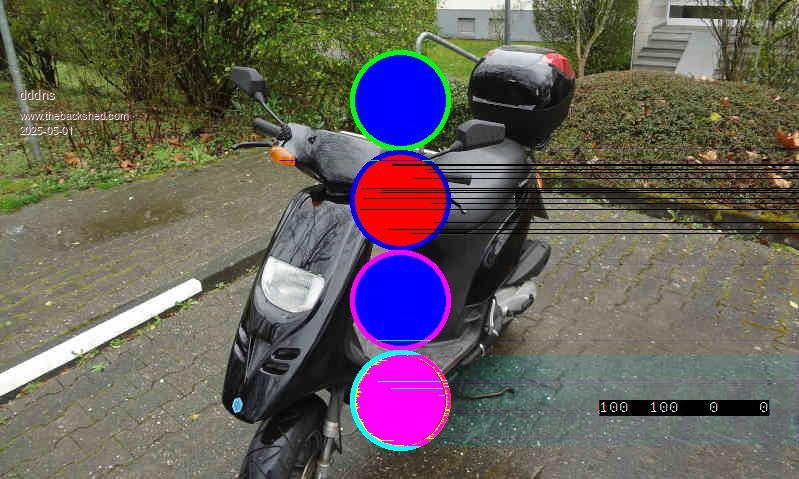

Hello!
If you copy a blit of a whole! screen into memory, it take around 600ms and 200ms to IIRC write it back to screen. Tested with PSRAM on a 2350B.
It is so fantastic fast while displaying true color, you can easily realize a digital picture frame, which can be so nice you can't buy.
Using a PicoMite with a ssd is for me the best experience of all version when running on a 2350 with PSRAM. I used it for a year as my main console screen for a RP2040 and its the same warm feeling as the editor is so wonderful usable with is.. I know what I am talking about. It scrolls as fast as serial console at 115200 flicker free and highly responsive to keystrokes
just my 2cent
I have a 7 inch. Touch works very nice. Downside is a poor viewing angle
test while getting bug out of wiring
picture of cause taken with "save image" on a RP2040
One more: a square of about 120 pixel can be copied into memory and moved with mouse flicker free and smooth and keeping the background on a RP2040 at 378MHz in true color

Posted: 06:59pm 30 Apr 2025
Copying within the screenbuffer is very fast. copying of one half or even move it constantly and smooth to the next pixel and fade it out looks good and is not too slow like 10 frames/sec.
