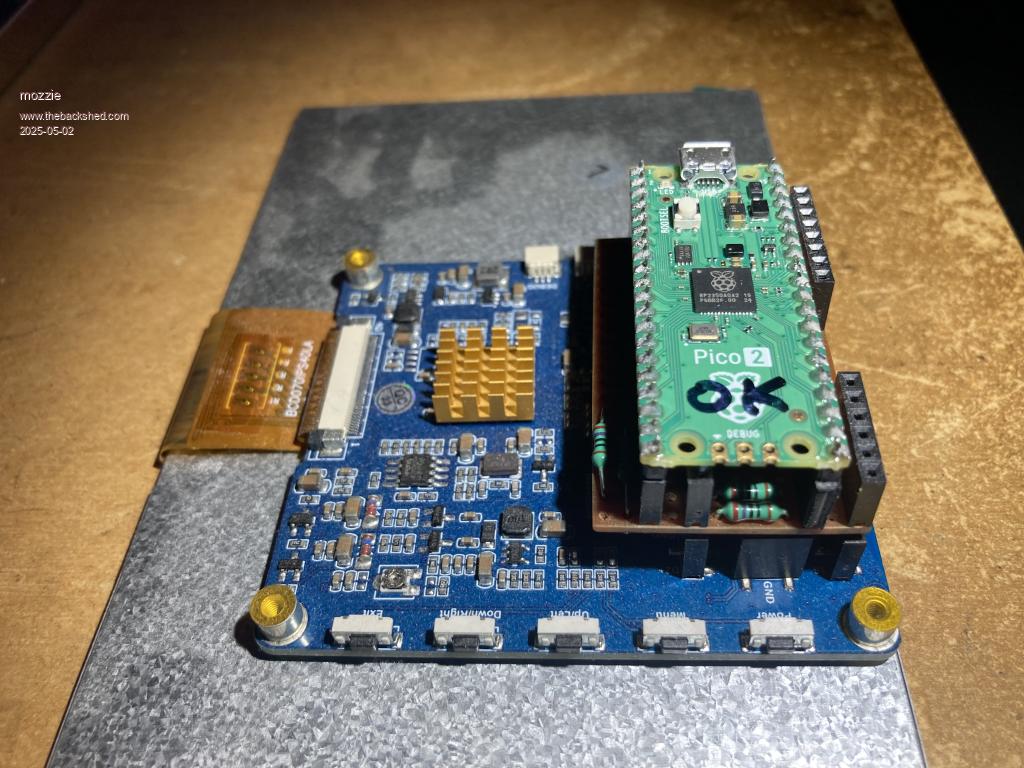

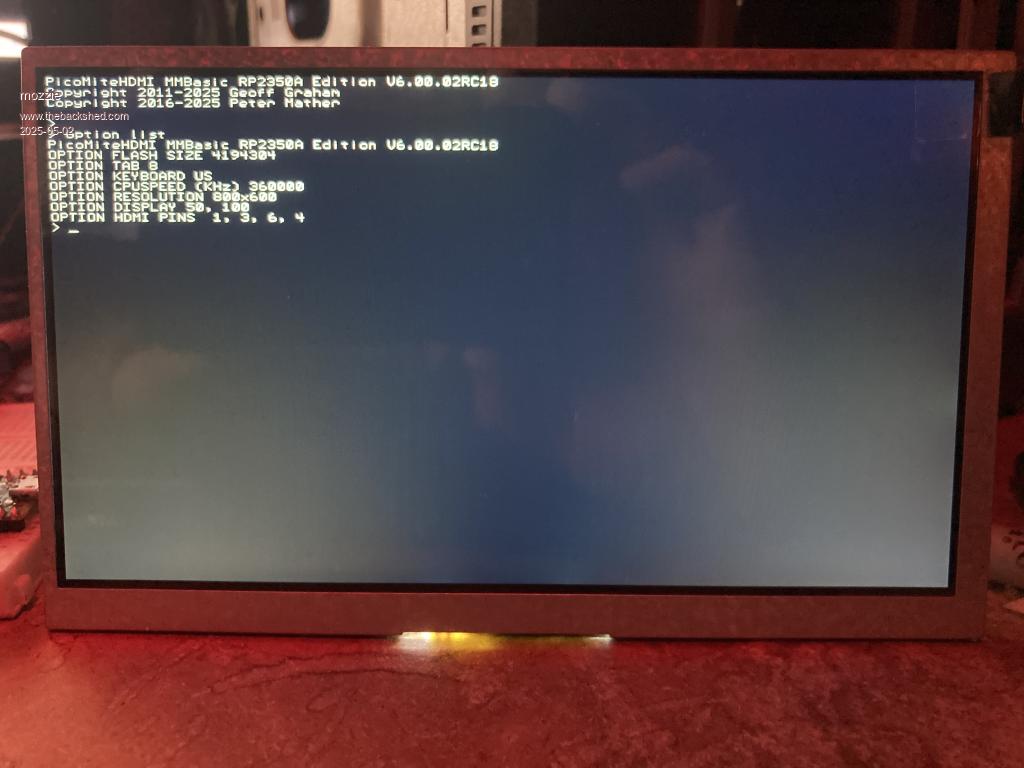

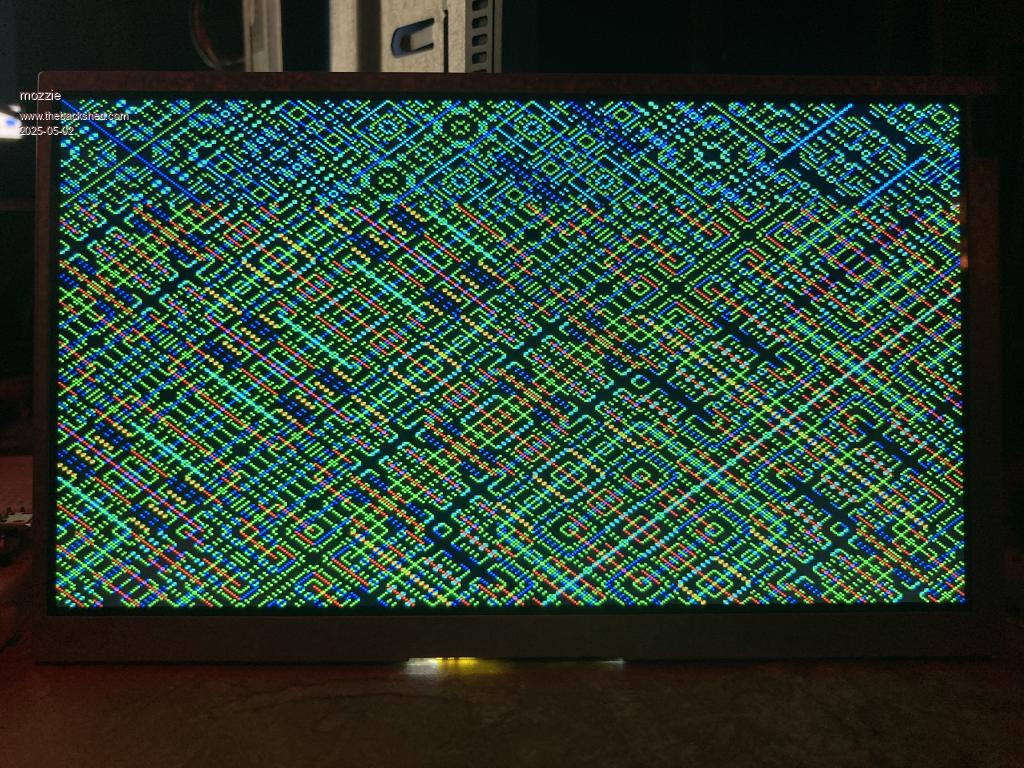

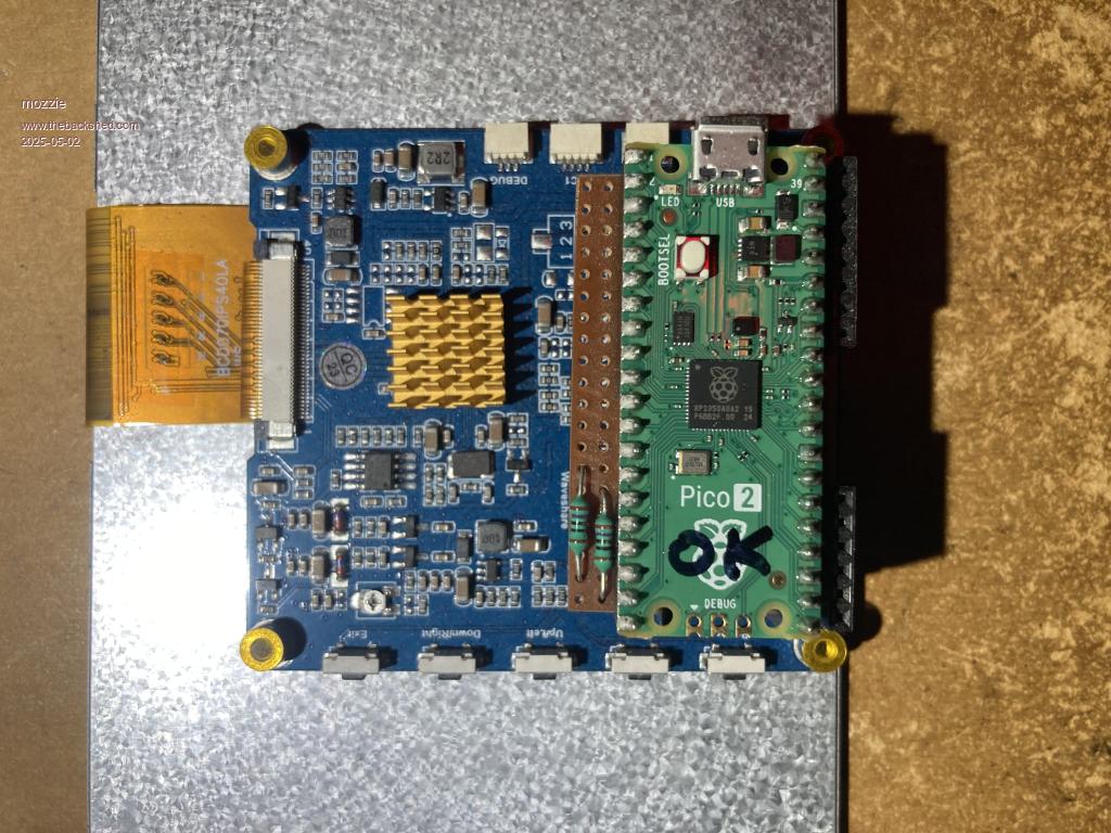

| mozzie Guru Joined: 15/06/2020 Location: AustraliaPosts: 487 |
G'day IanT With a simple breadboard adapter these DVI screens work very well, the native 1024 x 600 resolution is a pain but they scale to whatever you drive them with. Can confirm 640x480,800x600,1024x768 and 1280x720 all work fine, haven't tried the others yet. Photos don't do the real thing justice, this is the 7" version. Regards, Lyle. |

G'day, See below for... well... ummm... a diagram... You loose GP8,9,10,11 on the PICO side and GP16,17,18,19 on the DVI side using veroboard. These could be connected with jumpers of course with a bit of juggling. Use option HDMI PINS 1,3,6,4 if you do it this way. Also tested 720x400 and 848x480 resolution and can confirm they work as widescreen modes. Regards, Lyle. |

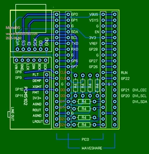

| Mixtel90 Guru Joined: 05/10/2019 Location: United KingdomPosts: 9280 |
I'm just having a play with a design. I'm wondering if I can fit an audio module on too.... Fairly early days. Mick Zilog Inside! nascom.info for Nascom & Gemini |
So far... Mick Zilog Inside! nascom.info for Nascom & Gemini |
I'm not far off now. I've added some GPIO pins and a reset button. Mostly tidying up now. Mick Zilog Inside! nascom.info for Nascom & Gemini |
PS2 not on board at the moment. You could connect one to the GPIO pins though. I'm not sure I'd want to hang a keyboard cable off the piggyback board. I've just suspended a mini RTC over the top of the uSD card socket. :) I'm picking up 5V from the Waveshare VBUS connection and feeding it into VSYS via a Schottky diode on the Pico. The Waveshare can power the Pico but not vice versa. The Pico can then be programmed using it's own USB connection, which may not be able to supply the current as it's not USB-C. The circuit shows the USB-C VBUS going directly to the Pico VBUS. Not a good arrangement. Mick Zilog Inside! nascom.info for Nascom & Gemini |
You're right - I'd misread the info. It's got 5V on pin 39, intended for VSYS. That's fine. I'll feed it to VBUS via a diode. To install or update MMBasic unplug the display and connect the PC to the Pico USB as usual. You can then use the Pico's USB in host mode for a hub while you power the system from the display's USB. The diode will prevent a big current draw from the PC. According to the circuit diagram we don't need to provide DVI resistors or I2C pullups. They are already there. I think I'll move the UART connector to GP8/GP9. It's of more use to us. It's still COM2 anyway, which is equally inconvenient. :) There aren't many COM1 pins but I'll try to do something with GP0/GP1. Mick Zilog Inside! nascom.info for Nascom & Gemini |
