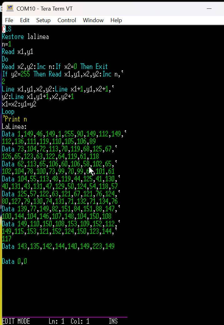

Attached is a PICO and VGA RP2040 version for test/comment.
PicoMiteRP2040V6.00.02RC20e.zip
PicoMiteRP2040VGAV6.00.02RC20e.zip
Changes
New command
OPTION CONTINUATION LINES ON/OFF/ENABLE/DISABLE
This is a permanent option but doesn't cause a reboot
When enabled it changes behaviour as follows:
The back single quote character chr$(96) is used as a line continuation when it appears as the last character on a line.
The LIST command and EDIT commands will automatically insert line continuation characters when used. This will be inserted at a space or comma character if possible or at the last displayable character as defined by OPTION DISPLAY.
All text in a program will therefore be viewable in the editor
When in the editor you can use the line continuation character to split lines. However, on saving these effectively disappear but are recreated when the program is listed or edited. NB: They may not therefore be in the same place.
When you use EDIT fname$ continuation characters are created as the file loads and then removed again when the file is saved.
The way that this works is that the tokeniser effectively strips the continuation characters out of the program and joins the lines. The normal maximum line length applies. When editing/listing the saved file, the new functionality inserts the line continuation characters as described above.

As it appears in the editor with a line width of 40 characters
Edited 2025-05-05 00:47 by matherp

Clever Peter, but now can you be persuaded to go the extra mile and use '_' instead of '`' as the line-continuation character so as to match the "prior art" of VisualBasic and FreeBASIC ? I believe VB requires the underscore to be preceded by a space, but FreeBASIC does not unless it immediately follows an identifier or keyword.
It would be nice if it was clever enough to work within string literals too, though there are some more edge cases there especially when automatically breaking up the strings.
Posts: 11827
Posted: 03:19pm 04 May 2025
  Quote  Clever Peter, but now can you be persuaded to go the extra mile and use '_' instead of '`' as the line-continuation character
The problem is that underscore is a valid character in variable names and I also use it to code some commands that appear to start with a period.
As a proof of concept I wanted to avoid anything that possibly has unexpected side effects. The back quote is so rarely used and has no use in MMBasic except in a string so it makes an ideal character.
The current mechanism will split inside a string without issue
Edited 2025-05-05 01:21 by matherp

  matherp said  The problem is that underscore is a valid character in variable names and I also use it to code some commands that appear to start with a period.
I understand, but I also stand by my "prior art" argument if this goes beyond proof of concept, it just makes the trickery a little trickier; the underscore is also a valid identifier character in VB and FreeBASIC I believe.
  matherp said  The current mechanism will split inside a string without issue
Nice.
Not that it changes the argument but the back-tick is rendered as the degree symbol in most (all ?) PicoMite fonts, this confused some PicoCalc folks who thought they had a keyboard problem.

Do you want to do some testing? I've set it to use underscore. What version do you want?
Posts: 4395
Posted: 04:02pm 04 May 2025
  matherp said  Tom
LOL, you've called my bluff ;-).
Let's try using it on the Game*Mite (since that is the most constrained environment), so a standard PicoMite RP2040 build.
Posts: 11827
Posted: 04:12pm 04 May 2025
Here you go
In this version if you use OPTION CONTINUATION LINES ON it defaults to underscore.
However, you can also use OPTION CONTINUATION LINES n where n is the ascii code for the character you want to use.
I've tried stupid things like
s$="____________________
and it seems to work - the string just ends up 1 underscore shorter as expected
Edited 2025-05-05 02:14 by matherp
