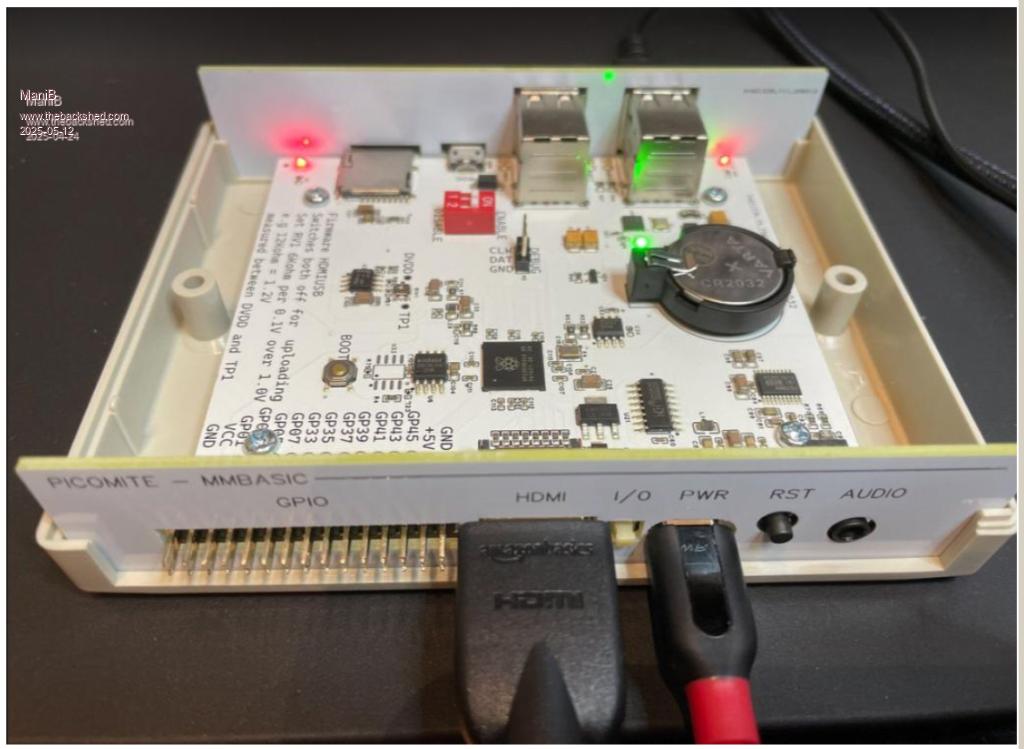

Posts: 11879
Posted: 02:30pm 08 May 2025
Won't work. Only RP2350 based boards will work with PicoMite DVI/HDMI and on those the DVI pins must use GP12-GP19. The order of the 4 pairs is not important

Posts: 4380
Posted: 03:00pm 08 May 2025
I guess you mean VGA to HDMI adapter.
Probably simpler to use one of the designs which already output DVI (HDMI).
That way it's all done and even has an HDMI socket.
JLCPCB can build them and/or you may be able to buy one from someone on here who bought some already and has a spare.

Posts: 11879
Posted: 03:44pm 08 May 2025
This is also an option with a Pico2 rather than a Pico1. OPTION RESET OLIMEX and it is fully configured

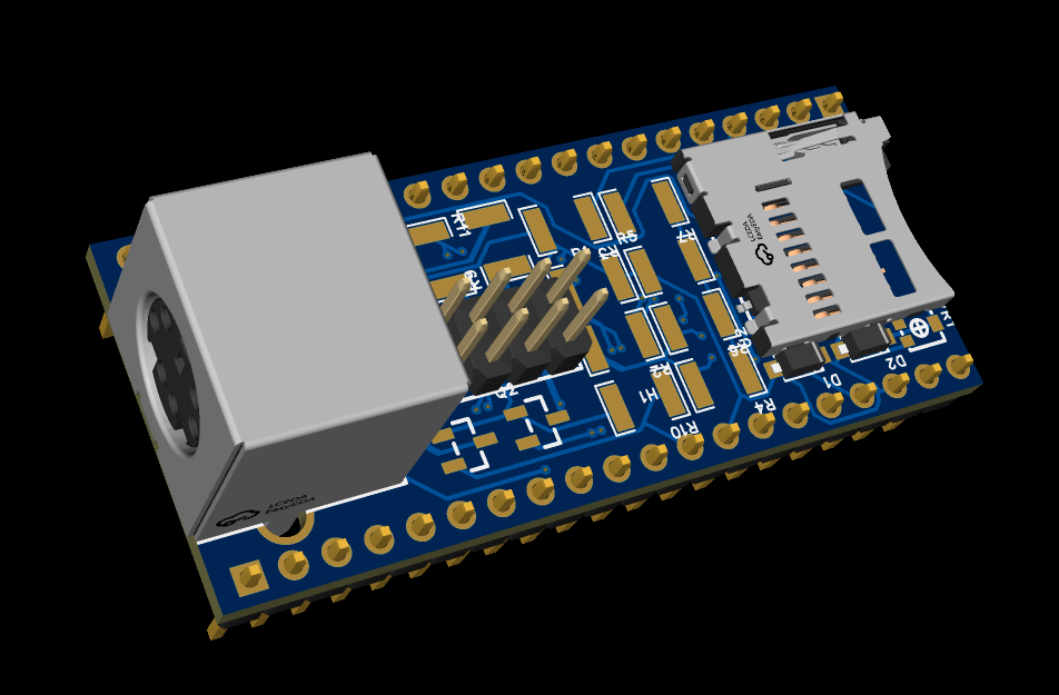

Today i began to play with EasyEda (from JLCPcb) .
I try to make a piggy board with SDcard,mini Din(ps/2),resistors for VGA(use a 2x8pins connector) .. cause Vga to big for piggyback .
I use as reference PicoMiteVGA schematic.
Perhaps someone have done this stuff ?
I used Autorouter of EasyEda .. hop finish next week .. and send it to JCLPCB
Amiga...

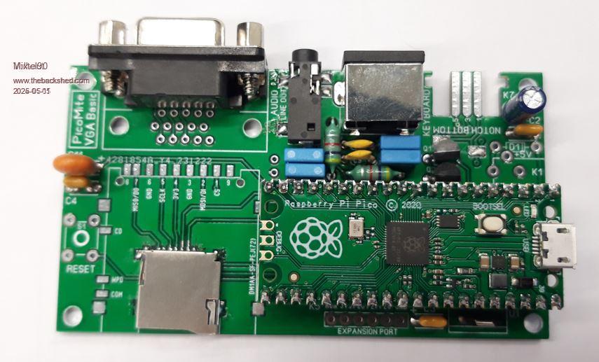

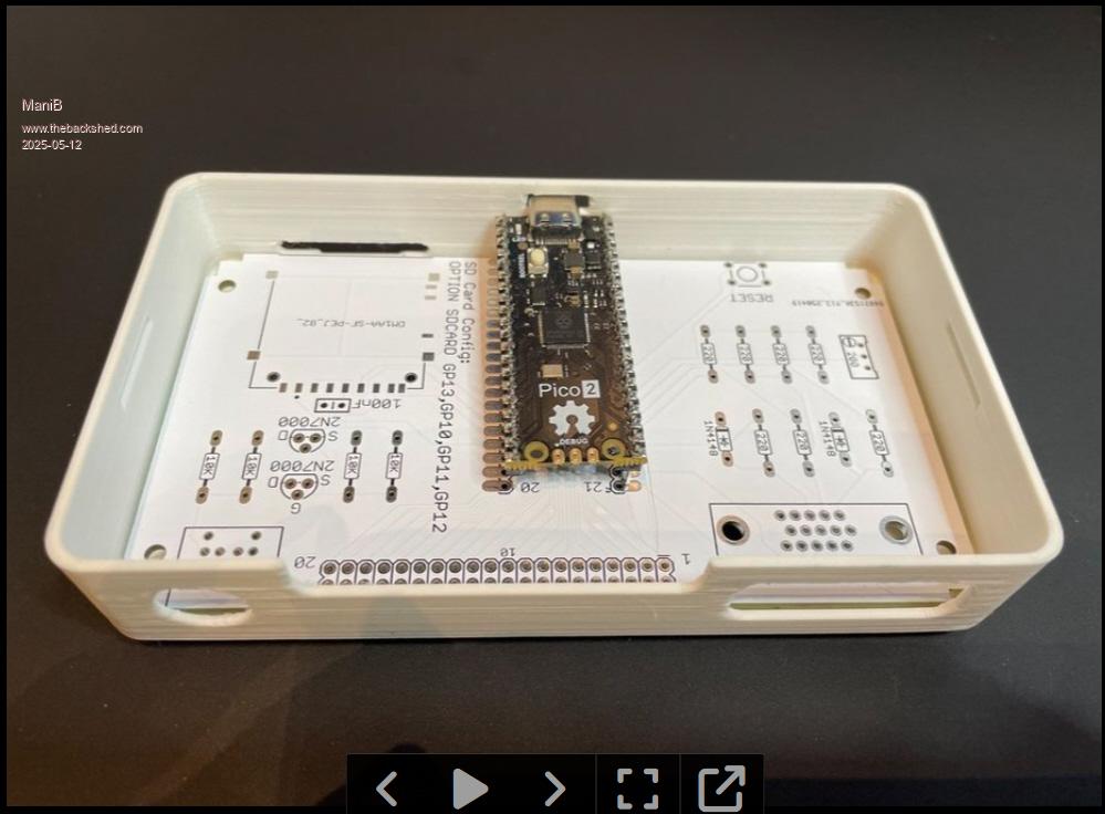

Posts: 9136
Posted: 06:43am 10 May 2025
I've done several weird and wonderful Pico boards. Some, but not all, can be seen by following the link in my sig:
PicoStick jams just about as much as you can onto a stick that plugs into the VGA scket of a monitor.
PicoMite 2X2 gets everything onto a 50mm square board.
PicX is an experimenters board. All the pins are out to connectors and you fit links to use them. There are two small breadboards. The whole thing is 100mm x 100mm to keep it cheap to build.
The list is rather out of date now. I really should put more on. :)
twofingers
Joined: 02/06/2014
Posts: 1769
Posted: 08:59am 10 May 2025

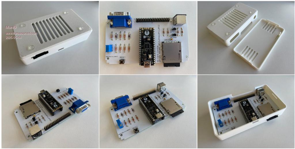

  amiga said  ...Perhaps someone have done this stuff ? ...
Peter designed this; it works well, but it's limited (No keyboard port, serial console only). A case is also available for it. It dates back to the time when RP2350 chips weren't available.
Michael
The lone and ...

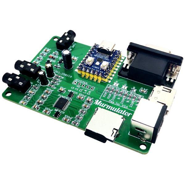

javavi
Joined: 01/10/2023
Location: Ukraine
Posts: 609
Posted: 07:27am 11 May 2025
My PicoMite works great on Murmulator's boards. VGA version on Murmulator 1 boards, and HDMI version on Murmulator 2 boards.
