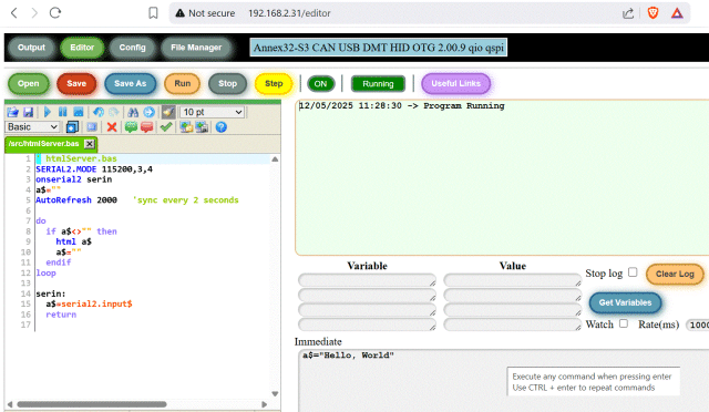

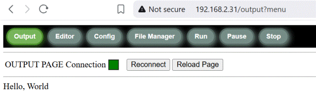

Posts: 3816
Posted: 02:38pm 12 May 2025
Sorry to be a PicoMite/WebMite heretic here, but for my money (and time), Annex RDS Basic  on a (for instance) ESP32-C3SuperMini is about ideal.
You can get rid of the buttons on the web page output so you just have a clean page.
The code contains a little kluge so that I could use the "Immediate" window to enter the html to be displayed instead of the serial connection, but it should work as is through serial.
Of course, a$ can be as complex as you want (no effective limit to a string size), or it can contain values which you massage to create your html text.
For the most bare version, the DO...LOOP would be replaced by WAIT, and "html a$" would go in the serin routine.
