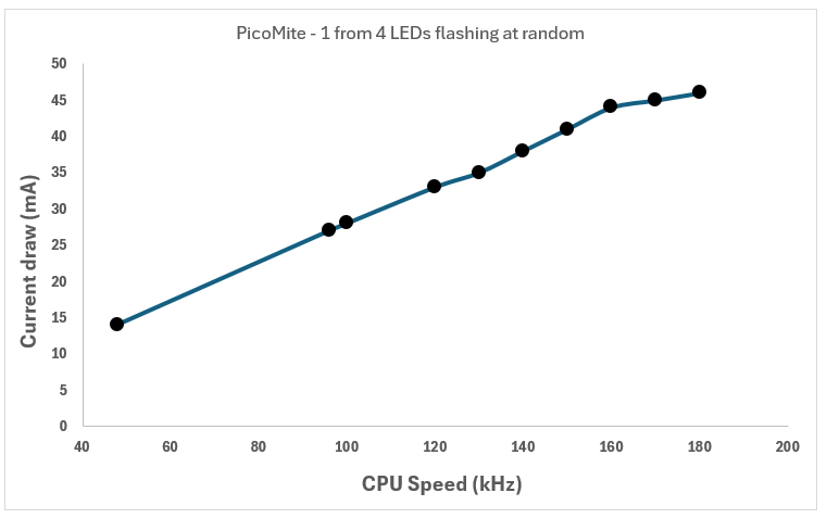

I know the RP2040 is not best suited for ultra lower power - but looking to extend battery life on a project.
I took my 1 from 4 LED flasher and hooked it up to one of those USB power displays. I set CPUSPEED from 48000 to 180000 and let it run.
Was really interested to note how much less current was drawn at the lowest speed. 14mA - which would mean, left on 24/7 that a 10,000mAh batter pack would last about 1 month.  Say six hours a day (evening/night) - would equate to 4 months - not too shabby.
Not sure I can reduce this further (make the LEDs dimmer) - but as they only draw ~5mA, the biggest overhead is the pico itself.
Question: Can any of the internal (and here unused) processes be turned off in any manner?

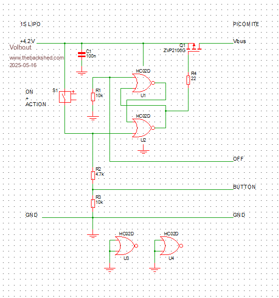

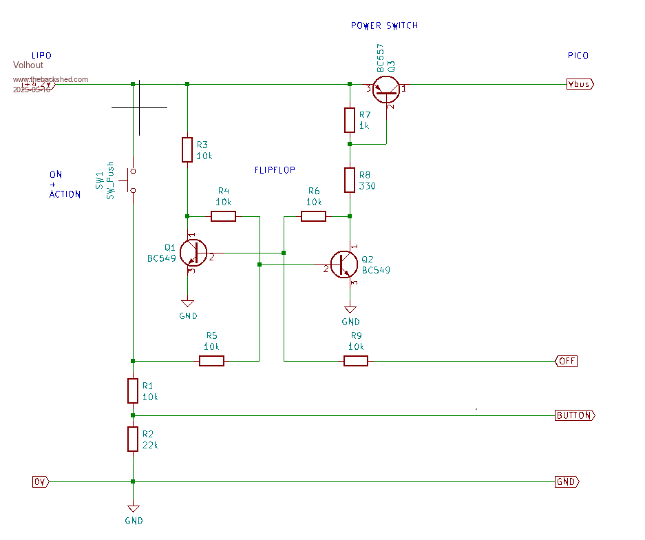

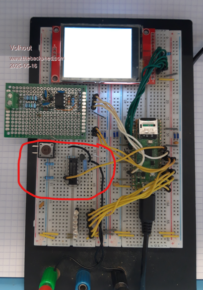

Nimue,
I have prototyped an external circuit to the pico that
- pico can shut itself down.
- a push button can wake up de pico
That brings the power consumption to near 0. But the pico is OFF while asleep, so you cannot run any tasks.
If you are interested, I can dig up the schematics.

...are you really sure about the unit? Shouldn't that be “MHz” instead of “KHz”?

  Volhout said  Nimue,
That sounds interesting - happy to tinker.  For this use case, a manual switch will suffice, but for future projects sounds intriguing.   Thanks!

  Frank N. Furter said  ...are you really sure about the unit? Shouldn't that be “MHz” instead of “KHz”?
Frank
Doh! - yes - thank for the spot.
