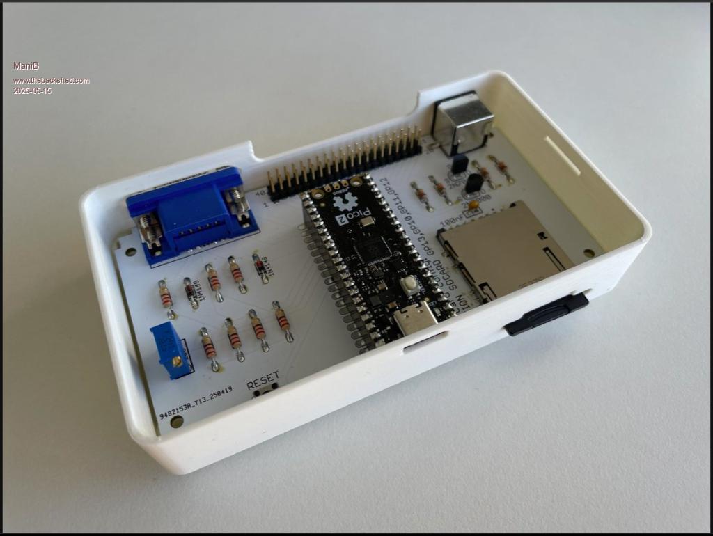

Hello everybody,
I am currently setting up four PicoMite VGA refernce boards using the Raspberry PI Pico 2 and the Firmware "PicoMiteRP2350VGAV6.00.02RC23.uf2"
The manual says that after installing the firmware, the Pico boots up and a virtual COM port is started on the micro USB port. Here is the excerpt from the manual, page 6:
"When the copy has completed the Raspberry Pi Pico will restart and create a virtual serial port over USB on your computer. See the chapter Serial Console below for the details of using this."
Well, MMBasic is running, I can use VGA monitor and PS2 keyboard without any problems. Actually everything works, but on my Windows PC, which I have connected to the Pico with the USB cable, no COM port is displayed.
What is the reason for this?
Here are my currently set options:

Is this option list coming from the device shown on the picture??

And yes, the OPTION LIST is from this device shown in the pictures.

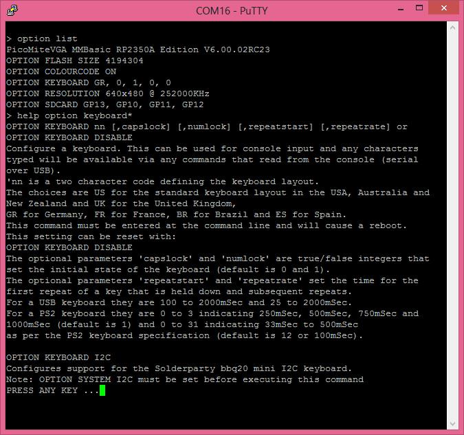

ManiB
Joined: 12/10/2019
Posts: 168
Posted: 09:31am 15 May 2025
  Mixtel90 said  This looks wrong.
Installing PicoMiteRP2350VGAV6.00.02RC23.uf2
will NOT give
PicoMiteVGA MMBasic USB RP2350B Edition V6.00.02RC23
OPTION FLASH SIZE 4194304
OPTION COLOURCODE ON
OPTION KEYBOARD GR,0,1,0,0
OPTION RESOLUTION 640x480 @ 252000kHz
OPTION SDCARD GP13, GP10, GP11, GP12
as OPTION LIST unless it's buggy.
The GPIO pin list looks correct though.
TassyJim is right. You probably need to clear the flash to reinstall the correct firmware.
Personally, unless someone can recommend a version that they have tested on this particular PCB design, I'd try one of the earlier Release Candidates or even 6.00.01, the last full release.

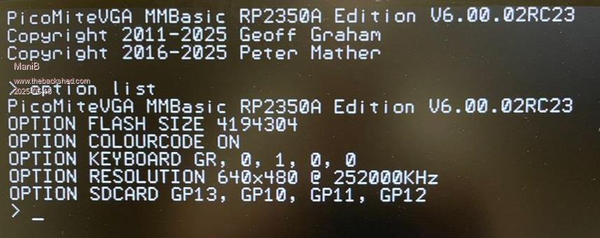

Yes, it is IS WRONG!
Sorry, I made a typing error when typing the screen message.
The corrected power-on message is: “PicoMiteVGA MMBasic RP2350A Edition V6.00.02RC23
Here is the screenshot:
Im using a Windows 8 PC. I will try this out this evening with my Windows 10 Intel NUC computer and then report what happens there.
Thank you for your help.
Posts: 9114
Posted: 09:36am 15 May 2025
Are you seeing this on the console screen just after the Pico boots, with it connected (and powered) via the USB connector?
Note for those who swap USB leads around. Not all USB leads contain the D+ and D- data cores. Some are intended for charging only and are intended for simple, single-rate chargers. This sort of lead is not suitable for the PicoMite family unless you are aware that there will be no USB console and the lead cannot be used to update or install MMBasic (or anything else for that matter!). I've been tripped up by this personally a couple of times and it can lead to a head-scratching session until you realise what's happened. I now label such leads as I come across them!

Posted: 09:41am 15 May 2025

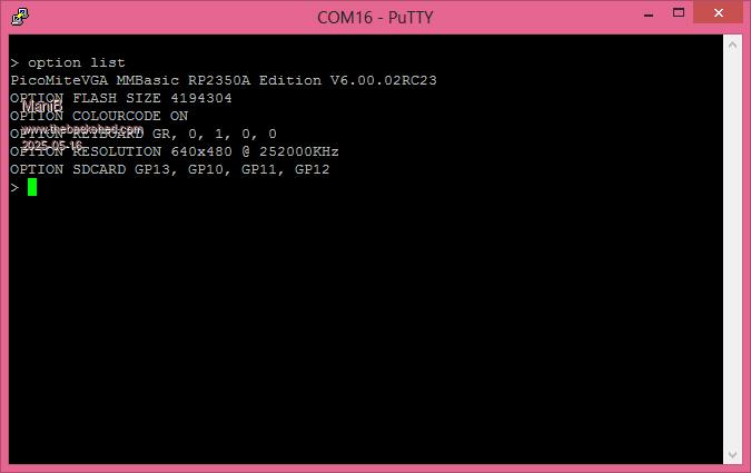

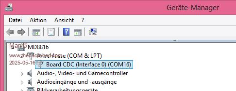

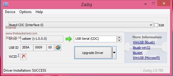

From the manual page 8.
Windows 7 and 8.1
The USB serial port uses the CDC protocol and the drivers for this are standard in Windows 10 and 11 and will load automatically.
The Raspberry Pi Foundation lists Windows 7 or 8.1 as “unsupported” however you can use a tool like Zadig
( https://zadig.akeo.ie ) to install a generic driver for a “usbser” device and that should allow these computers to
connect. This post describes the process: https://github.com/raspberrypi/pico-feedback/issues/118

Posts: 9114
Posted: 09:45am 15 May 2025
Well spotted!
Windows 8 belongs in the pits of hell anyway. It's awful. :)

dddns
Joined: 20/09/2024
Posts: 910
Posted: 10:30am 15 May 2025
Very confusing for everybody. Please confirm:
This version is the correct one if you want serial over USB on a RP2350 (Pico2):
  ManiB said
If an unknown device is plugged into Win then usually it requests a diver install.
Maybe it won't come up with this but then you should see an unknown device in the device manager. Please check
Try all of this on a plain pico without having it plugged in to your board
Then please report what your findings are
Please never retype an option list but copy & paste!
If I think about it twice windows is not your problem as you are able to flash the Pico. Isolate a Pico and be sure flashing a non USB version as first step
The discussion about clear_flash is not worth a word. simply do if you want to be sure

dddns
Joined: 20/09/2024
Posts: 910
Posted: 11:00am 15 May 2025
The keyboard setting are your problem
