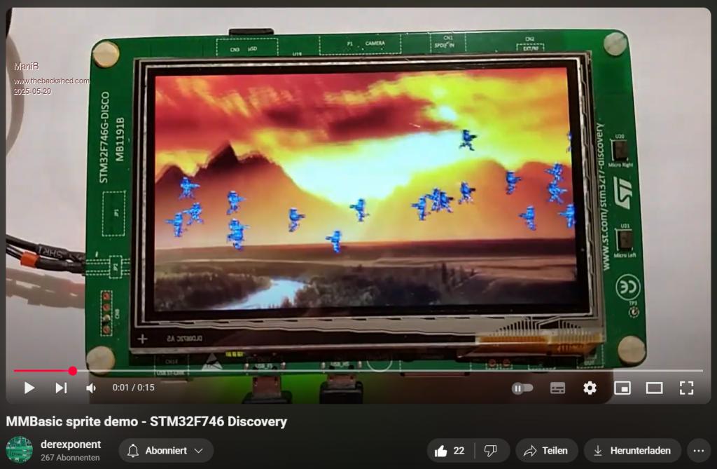

Posted: 01:25pm 20 May 2025
You need the power of the CMM2 to have some fun.
Here is a video of my brother who got MMBasic running on the STM32F746 Discovery Board:
https://www.youtube.com/watch?v=5g3-ztufoNM
More infos about on my blog:
https://mikrocontroller.bplaced.net/wordpress/?page_id=787
Or her in this forum:
https://www.thebackshed.com/forum/ViewTopic.php?TID=7969
Edited 2025-05-21 00:06 by ManiB

Posted: 02:30pm 20 May 2025
@ManiB,
That is early work (2015).
10 years ago... wauw...

Posted: 08:10pm 20 May 2025
  Volhout said  @ManiB,
In fact, this was a very early time to port MMBasic to the STM32F746NG MCU.
I did a quick search here in the forum to find out when the first versions of CMM2 were released.
Overview of Colour Maximite 2 Versions
CMM2 (First Version)
First Mention: June 2020
Processor: Microchip PIC32MZ EF (ARM Cortex-M7, up to 200 MHz, 2 MB Flash, 512 KB SRAM, 176-pin)
Source: TheBackShed.com, Silicon Chip
CMM2 G2 (Generation 2)
First Mention: December 3, 2020
Processor: Microchip PIC32MZ EF (ARM Cortex-M7, up to 480 MHz, 2 MB Flash, 1 MB SRAM)
Source: TheBackShed.com (?), Silicon Chip (August/September 2021)
CMM2 G2 V2
First Mention: October 2, 2024, with development starting April 4, 2024 (schematic)
Processor: STMicroelectronics STM32H743IIT6 (ARM Cortex-M7, 480 MHz, 2 MB Flash, 1 MB SRAM, 176-pin LQFP)
Edited 2025-05-21 06:16 by ManiB

Posted: 09:02am 21 May 2025
AFAIK the CMM2 has always been STM32 based.
The PIC32MZ family uses MIPS core, not ARM core.
But I think the 2015 port of MMBasic to STM32 was before CMM2 was concepted.

Posted: 09:47pm 21 May 2025
@ManiB
Wow , so long ago ,
i worked with Uwe on this project , i added the Sprites , Polygon , 3D Functions to the interpreter
It was bad that Uwe don't have time to continue the project.
The STM32 was the best at that time , for now i don't have check but for real power i
think the teensy 4.1 is the only one to beat the STM.
And greetings to Uwe when you get in touch with him

Posted: 07:58am 22 May 2025
  darthvader said  @ManiB
Wow , so long ago ,
Yes, I remember. I bought an STM32F7 Discovery board just because of this MMBasic project and thought it was so great to be able to write Basic programs that were faster to execute than if you had programmed in assembler back in the 80s.
Unfortunately, my brother decided to stop updating his blog, which meant that the website was no longer accessible and then the webspace was deleted;(
To my regret, and probably also to the regret of his fan community, a great documentation on the STM32 microcontroller has been lost.
I have therefore decided to put his work back online here:

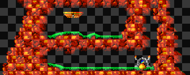

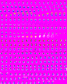

Posted: 03:16am 11 Aug 2026
Fortunately, you can find the animations online
Amiga Spritesheet
or bigger
Lemmings 16x20
Edited 2026-08-11 15:53 by Martin H.

Posted: 07:34am 11 Aug 2026
Hi Martin,
I think the 16x20 is not very suitable for a 320x240 resolution screen. I have a lemmings core working with 13x20 (mouse control on pico !!), and despite they look great, and move great, it will be hard to make a nice landscape/world for them to move in. The landscape can scroll sideways, but vertical scroll is difficult to play. So your total height is only 15 lemmings high (not much falling/digging/parachuting to do).
I started re-writing my core to make use of the 8x8 (classical) lemmings. And it helps that Peter added collision detection with the background. So the game is in essence possible now.
Rodents demo: that is really using every aspect and bug inside the VIC2 chip....
Edited 2026-08-11 17:53 by Volhout

Posted: 08:06am 15 Aug 2026
I’ve put together the complete set for you here as sprites and CSUB file. These are 318 converted Amiga sprites which, to allow for freedom of movement, are still 16x16 pixels in size.
sprites.zip
You can, of course, create a Lib from it or read the BMP using BLIT FLASH. See which works best for you.
Have a good Weekend
Martin
