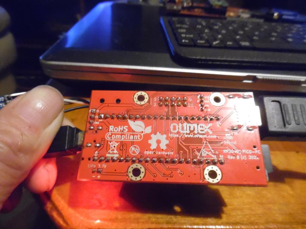

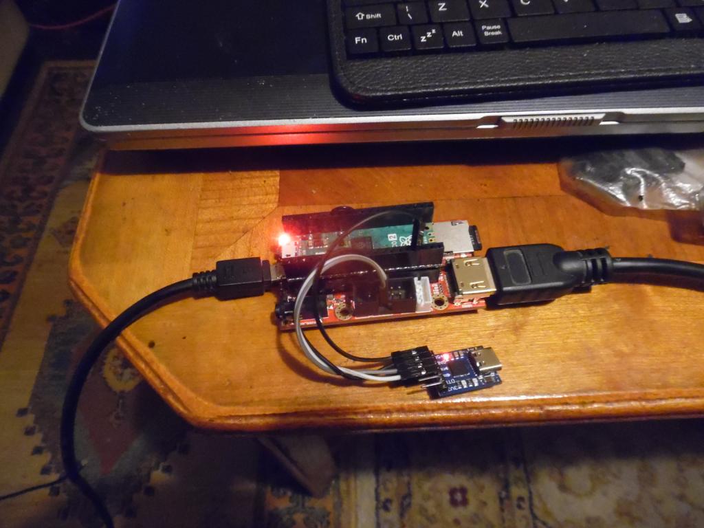

got an olimex 2350a / pico 2 but don't use it.
> option list
PicoMiteHDMI MMBasic USB RP2350A Edition V6.00.02b0
OPTION AUTORUN  ON
OPTION FLASH SIZE 4194304
OPTION COLOURCODE ON
OPTION KEYBOARD UK, 0, 0, 600, 150
OPTION CPUSPEED (KHz) 315000
OPTION DISPLAY 30, 53
OPTION HDMI PINS  1, 3, 7, 5
I had to add a link for sound but just flashed a prog and it seems ok and neat so why don't I use it? I must have bought it for something.
Posts: 2807
Posted: 07:46pm 21 May 2025
what was wrong with it as it looks good for new users but there must be a catch or it would be more popular
I notice using usb version usb to ttl works to program but needs dissconectig for code to run and connecting usb to ttl stops program running disconnecting it runs again.
just posted as beginners show interest in the board and be fair it looks tidy but it's got faults with mmb but mine is "working"

What is printed as product description on the backside?
I found a board looking like yours but seems to be originally designed for RP2040.
I think this is used by some here and can be setup with OPTION PLATFORM OLIMEX but I'm not sure. I looked at the scheme and I think its ok for the 2350.. Your usb problem sounds unusual to me, maybe other can help better.
scheme I looked at
I think your ground wire for usb is wrong..can'T see excatly but check
Edited 2025-05-22 06:27 by dddns

@dddns there are faults reported with this board and mmb but I can not remember them only there is a wire joining 2 gpio pins
Posts: 2807
Posted: 08:40pm 21 May 2025
it's ground for usb to ttl
no usb connected, that is on the pico. power goes to the olimex board
all strange
edit checking usb to ttl sir
Edited 2025-05-22 06:46 by stanleyella
dddns
Joined: 20/09/2024
Posts: 875
Posted: 08:46pm 21 May 2025
I think you plugged it in one too far to the left. please check that
On the pico, not at the socket
Edited 2025-05-22 06:49 by dddns
Posts: 2807
Posted: 08:59pm 21 May 2025
I had the 5V from usb to ttl plugged in to ground doh.
plugged into vbus pin 40 and no need for power to olimex board.
mmedit working through usb to ttl ok.. which is usb c and tiny.
Thank you for your help @dddns

There was a long discussion about olimex... and me. sorry, looking fine now.
seems ideal for beginner, what was the catch?
found from info 3.3V is input supply so use 3.3V out from usb to ttl instead of 5V to vbus... works

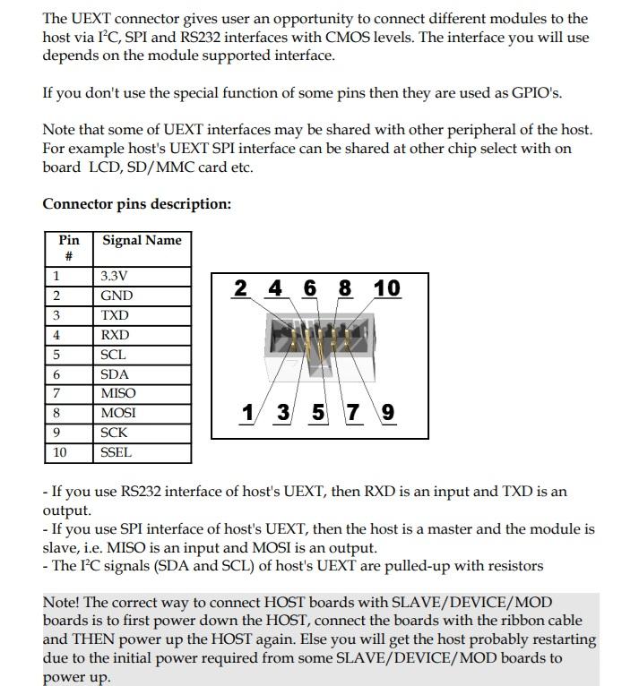

The board has its own USB connector for power source. Your USB TTL serial converter should be only connected to UEXT via GND,RX,TX

Posts: 11646
Posted: 07:15am 22 May 2025
This is a perfectly good little board save for one silly design issue. They have allocated GP27 and GP28 for the audio. These are not on the same PWM so are not synchronised and cannot be used with MMBasic. The workround is to connect GP26 to GP28 and then set up the audio with OPTION AUDIO GP26,GP27. This is assumed when you set up the board with OPTION RESET OLIMEX or OPTION RESET OLIMEX USB. In the latter case MMbasic configures the serial console as GP0,GP1 which are connected to the three pin header next to the USB port (labelled RX and TX)

Posts: 8965
Posted: 07:25am 22 May 2025
This is the module with the dodgy audio. It's PWM on GP27 and GP28. These are PWM5B and PWM6A respectively so they don't work! The answer is to link GP26 to GP28 and use PWM5A and PWM5B for audio. You lose GP28. DVI_CEC isn't used so it doesn't matter.
Posts: 2807
Posted: 04:18pm 23 May 2025
mine seems to not work now. no hdmi out. reflashed 2350 but the board didn't see usb to ttl. one usb to ttl not working win says. tried another and not responding. find a use for the pico 2350
JanVolk
Joined: 28/01/2023
Posts: 386
Posted: 04:44pm 23 May 2025
Stanleyella,
Peter described it well above.
It works fine for me.
Flashing with the RaspBerry Pi Pico USB.
Then connect a separate USB power supply to the Olimex board.
Connect the keyboard or hub to the USB Raspberry Pi Pico.
Now type blindly: option reset olimex usb
Give a reset to the Olimex.
When connecting the Terminal via rx and tx next to the usb, note that they must be connected crosswise and then make a standard 3-pin cable so that it always works well.
