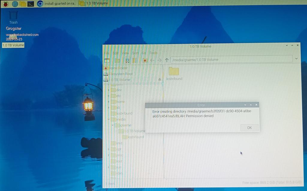

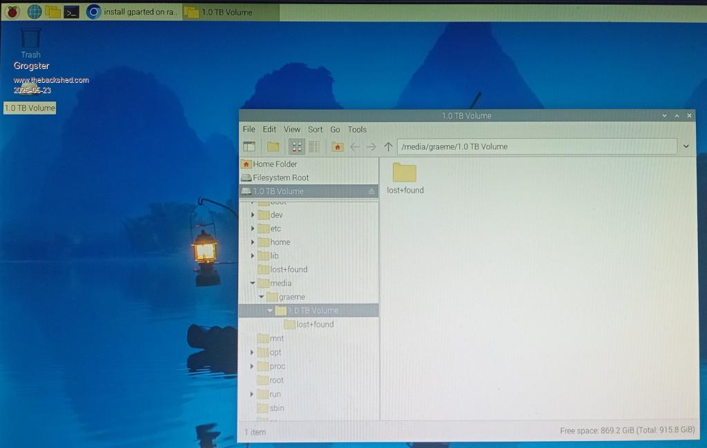

Trying to simply create new folders on my NVMe SSD on a RP5 board setup.
I used gparted to partition and setup the drive as ext4.
I was asked for my password to do this, so I entered it, and that was accepted.
The drive was formatted successfully.
I also created a partition table, as instructed by gparted.
Everything seems fine there.
The volume appears to have been mounted by the PI5 - there is an icon on the RP desktop.
But if I try to make a new folder on the NVMe SSD, I keep getting "Permission denied" messages.  At no point am I asked for my admin password during this, it is just outright denied.
Little help?

It's a permission problem. Use administrative rights to create a folder and assign the group user rights of the username you are logged in with to it. Try right clicking the folder there should be a tab "permissions"

But.....it won't LET me create the folder in the first place...

if you right click the area where lost+found is shown you might have an entry "open as administrator"

You will probably need to use Sudo from the command line to do anything like that on the Pi as the Root account is disabled. An ordinary user probably hasn't got permissions. In the past I've usually run the partition manager in root/sudo mode to mess about with partitions. You can then do anything. It's nice and dangerous. :)

In my case, I simply installed Raspbian to the SSD, rather then trying to boot from the SD card, and THEN mount the SSD as a storage volume.  When installed to the SSD from the off, I have full write permissions and can happily create new folders etc, with no issues other then the odd request for my password.
