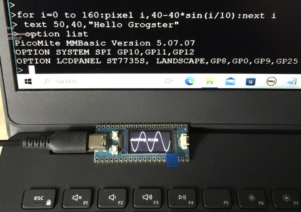

Posted: 07:17am 27 May 2025
Yes MMbasic supports it.

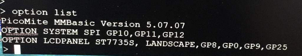

Posted: 08:00am 27 May 2025
With my configuration it is working.

Posted: 08:10am 27 May 2025
Better is:
OPTION SYSTEM SPI GP10,GP11,GP28
OPTION LCDPANEL ST7735S, L,GP8,GP12,GP9,GP25

Posted: 08:45am 27 May 2025
So....the controller chip is an ST7735S, yes?
And it is supported?
That is what I want to know, before I buy any of the WS modules....

Posted: 08:50am 27 May 2025
  Arne said  With my configuration it is working.
Arne
"Hello Grogster"
Nice one, my son.
Did not spot that on the first time through the thread.
I will order a couple on my next WS order then.
