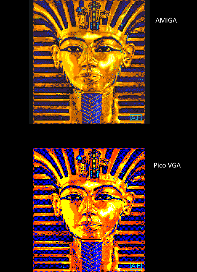

In that post you showed an illustration from a PicoMite(VGA?) that had been modified to allow grey in the palette though you never posted a schematic ?

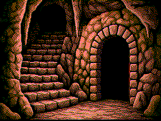

  thwill said
TBH I'm becoming inclined to do something similar.
Use MMB4L to reduce resolution and colour depth (probably to RGB333) and then KolourPaint (Linux) with the PicoMiteVGA palette for final editing down to RGB121.
RGB121:
Just used my little MMB4Windows Program (MMB4L should also di the job):
FN$="sandy-beach":W=240:H=160
mode 1
load png FN$+".png"
for y=0 to h
for x=0 to w
cl%=0
n=Pixel(x,y)AND &HFFFFFF
r=n AND &HFF
if r>96 and r<128 then
if (y mod 2)then
R=255*(x mod 2)
else
R=255*not (x mod 2)
endif
end if
inc cl%,255*(r>127):n=int(n/256)
g=n AND &HFF
select case g
case >191
inc cl%,&HFF00
goto weiter
case >127
inc cl%,&H8000
goto weiter
case >63
inc cl%,&H4000
end select
weiter:
n=int(n/256)
b=n AND &HFF:inc cl%,&Hff0000*(b>64)
pixel x,y,cl%
next: next
save image FN$+".bmp",0,0,w,h
Edited 2025-06-07 20:39 by Martin H.

You can get grey with a RGBI network, though for maximum compatibility with Pico VGA RGIB is better. RGIB resistors
For image conversion I used a Pico LCD and a program (in the link above) to distort the colours so they would decode correctly through the RGB121 codec in the Pico VGA.

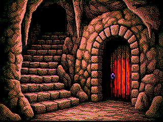

Martin H.
Joined: 04/06/2022
Posts: 1573
Posted: 09:20am 08 Jun 2025
  Mixtel90 said  I can't see anything wrong in that. In fact, the walls and floor were surfaces that could be coloured. The door archways were polygons that were drawn over them, with the doors as further polygons inside them, covering the black area.
so from this
to this
Edited 2025-06-08 19:26 by Martin H.

Martin H.
Joined: 04/06/2022
Posts: 1573
Posted: 09:50am 08 Jun 2025
  Volhout said
Martin: that is not PicomitVga color palette.
sure it is
'no comment
