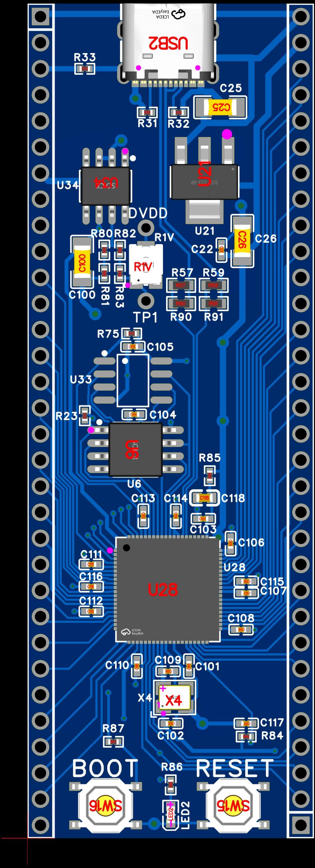

Make sure you set up the R1V pot before you power anything on.
Posts: 12059
Posted: 12:52pm 13 Jun 2025
The pots seem to come mid-range which gives a voltage of just over 1.4 - perfectly safe. I just power the boards up and then with a multimeter across DVDD and GND adjust to 1.3. The board is designed so that even with the pot full scale it should be safe (1.8V) - others have run the chip at that without issue

Posts: 2552
Posted: 02:57am 14 Jun 2025
is the unused end of R1V tied to the wiper?
i'd be interested in seeing both sides of the PCB with parts unpopulated so all tracks are visible.

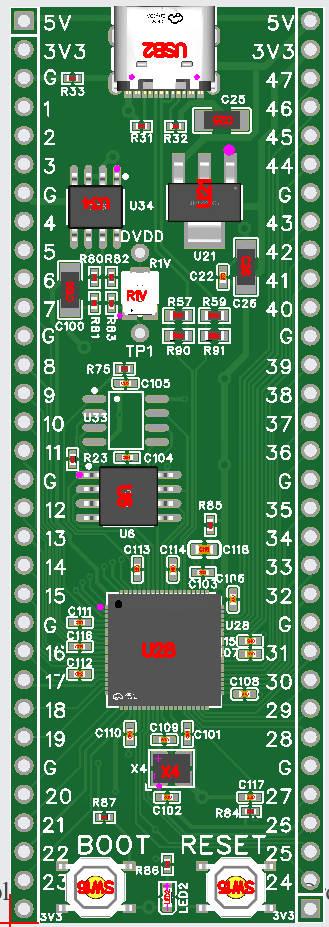

Posts: 12059
Posted: 07:14am 14 Jun 2025
Grogster et al
I have done a trivial update to include GPIO numbers on the top silkscreen of the board. No other changes. The board as you have ordered seems rock solid.
Pico2350DILV1.2.zip
Edited 2025-06-14 17:17 by matherp

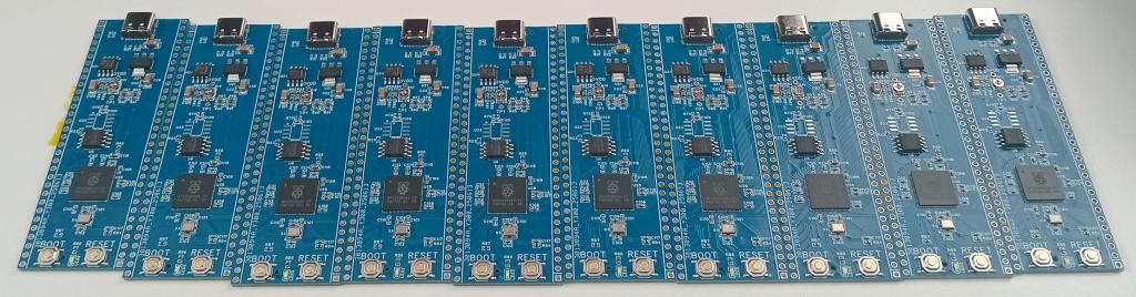

Posts: 10074
Posted: 12:15am 19 Jun 2025
My boards have arrived.
I hope to have a play around with one of them over the weekend.

OK, I have my first PICO2 up and running, and white "Heartbeat" LED blinking away there happily.
Can someone just briefly explain WHY there was a need for the wee trimmer, and setting it to 1.30v - which I have done, BEFORE I loaded the MMBASIC firmware.
I am sure this has been covered before, but I have been very busy lately, and have not had the time to read each and every thread or post, so a quick pointer as to the purpose and need for this trimmer would be fantastic.
Posts: 6197
Posted: 06:51am 20 Jun 2025
Hi grogster,
In short: RP designed a switch mode power supply for the core voltage INSIDE the RP2350B. That switcher has possibility to adjust the core voltage to support over clocking.
But.. RP found out that the switcher is sensitive to noise, and specific noise generated from the coil that the switcher uses. Polarity of the coil (how it is wound) is key. And since there is no polarity indicator on small coils, problems are to be expected.
Hence Peter decided to avoid the issue, and use an external linear regulator for the core voltage. And if you want to "overclock" you have to set it for 1.3V (normal core voltage is 1.1V for 150MHz).
That is the short story,

EDIT: Should I be setting the default core voltage to 1.10v then?
1.30v might be needed for HDMI support etc.
Edited 2025-06-20 17:28 by Grogster
