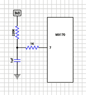

this is probably a question for Geoff:
with the Micromite Mk2 (MX170), is there any way of keeping approximate track of how long a CPU SLEEP has lasted? i have an I2C ADC set up to collect samples at a rate of around 64 samples per second; these are summed, and around every 300ms are averaged and transmitted.
whenever the ADC has a new sample ready it signals the MX170 by toggling pin 16 - so this can (and indeed does) wake up mmbasic, the sample is read from the ADC, and the ADC then instructed to collect another sample if we are still within the 300ms collection window.
i want to use CPU SLEEP for a couple of reasons:
(a) so i can keep the current consumption down at the 1mA level, this is for a battery operated device and i'm hoping to achieve a battery life in the hundreds of hours;
(b) having the MX170 sleep while the ADC is operating is desirable to minimize electrical noise issues. signal levels are down into the 100's of microvolts.
one hardware option i'm thinking of is simply an LM555 set to produce a 50/50 600ms square wave that is fed into a pin on the MX170, thereby providing a 300ms ON, 300ms OFF tick-tock that i can check. but, if there was a SIMPLE software option...

How about a RC network. A resistor trickle charges a cap. At the trigger point the MX170 wakes up, increments a counter, pulls the pin low to discharge the cap through a diode, makes it an input again then goes back to sleep. It may not be too accurate, depending on the type of capacitor used, and may also drift with temperature. That would at least give you a sort of clock without having to use a 555 as well.
I'm not even sure if this is possible. I've not used the MX170 for ages and I can't find my manual either.

  Mixtel90 said  How about a RC network [...]
not a bad idea     i've got plenty of spare pins, so could use one to monitor the voltage on the capacitor and another to connect a low value pulldown resistor for discharging once 300ms is reached. +/-20% variance in duration isn't an issue; if i use an analog input i can even get some granularity and do a self-calibration at startup.

success, using an external RC as suggested by Mixtel90, using just a single pin:
and the following code:
' automatic calibration
SetPin 7, dout
Pin(7)=0
Pause 10
SetPin 7, ain
t=Timer+300
 Vcal=Pin(7)
Loop Until Timer>t
Print "calibration = " Str$(Vcal, 0, 3) " volts"
' timing test loop
 SetPin 7, dout
 Pin(7)=0
 Pause 10
 SetPin 7, ain
 t=Timer
 Do : Loop Until Pin(7)>Vcal
 Print Timer-t,
this is the output from the above code:
> RUN
calibration = 2.404 volts
302     302     302     303     302     302     302     302     302     302
303     302     302     302     302     302     302     302     302     302
302     303     302     302     302     302     303     302     302     302
302     302     302
i've also been able to verify that CPU SLEEP does not have any effect on the timing.
rob   :-)
