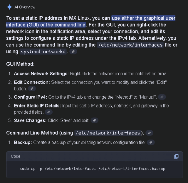

I WOULD like to know how to set a static IP address for MX Linux, but A.I. is very good at telling me how to do that, so that is one thing that A.I. does well....

While I wait for the SSD to arrive, I have been researching various things.
The Google AI seems to be pretty good at telling me how to do stuff.
Once the SSD arrives, and I have installed MX Linux to it, I will post back on this thread again.
