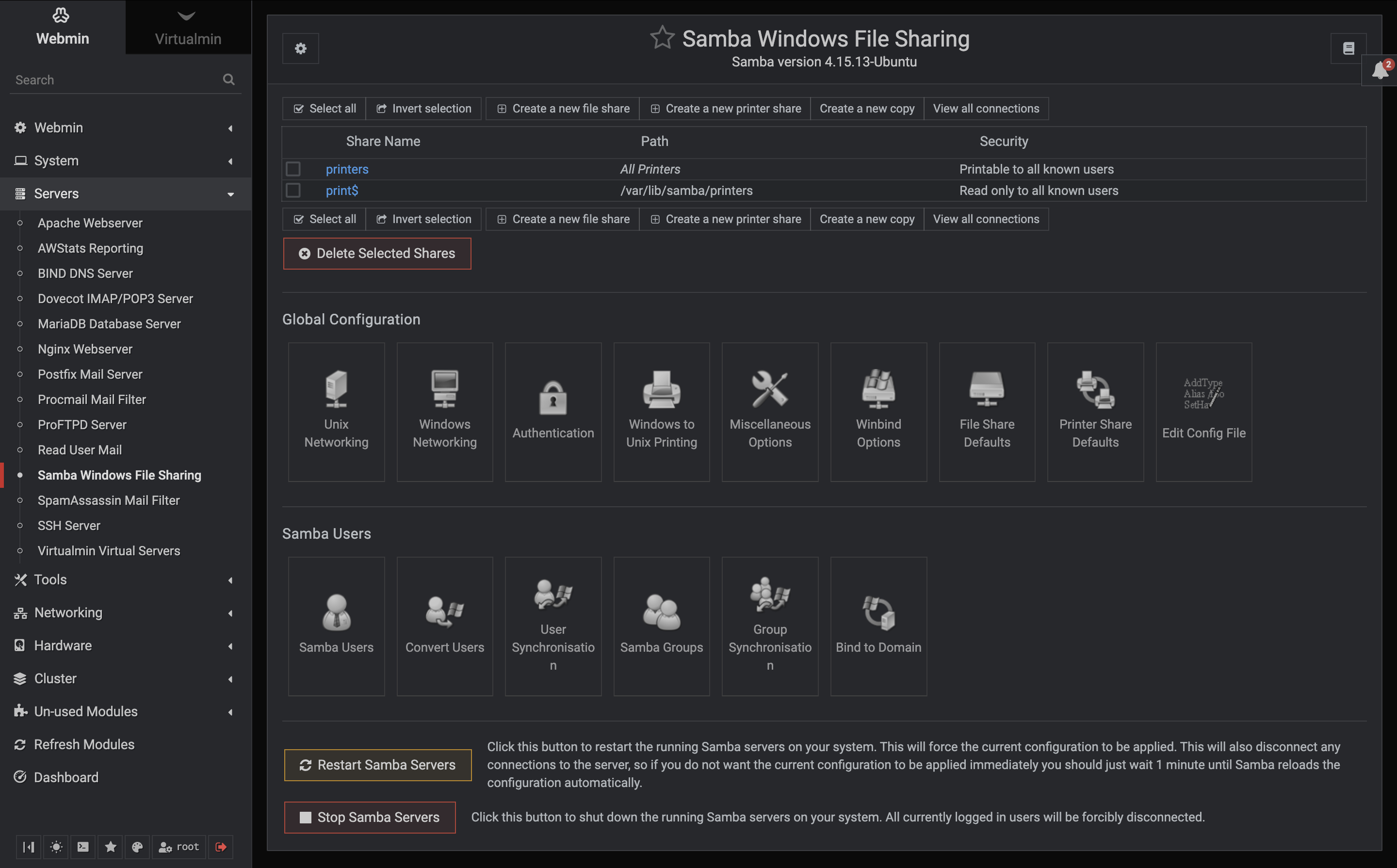

Try Webmin  for your MX install to have full GUI control over your box and services. This is 20years+ mature and should let you setup and administrate any server service you like on your debian box with a very clear GUI

dddns
Joined: 20/09/2024
Posts: 875
Posted: 08:43am 24 Jun 2025
See here, how nicely you can configure any aspect of SAMBA with Webmin
E.g choose the right (domain)server mode, setup SAMBA users and have them synced or not with you linux authentication mechanism

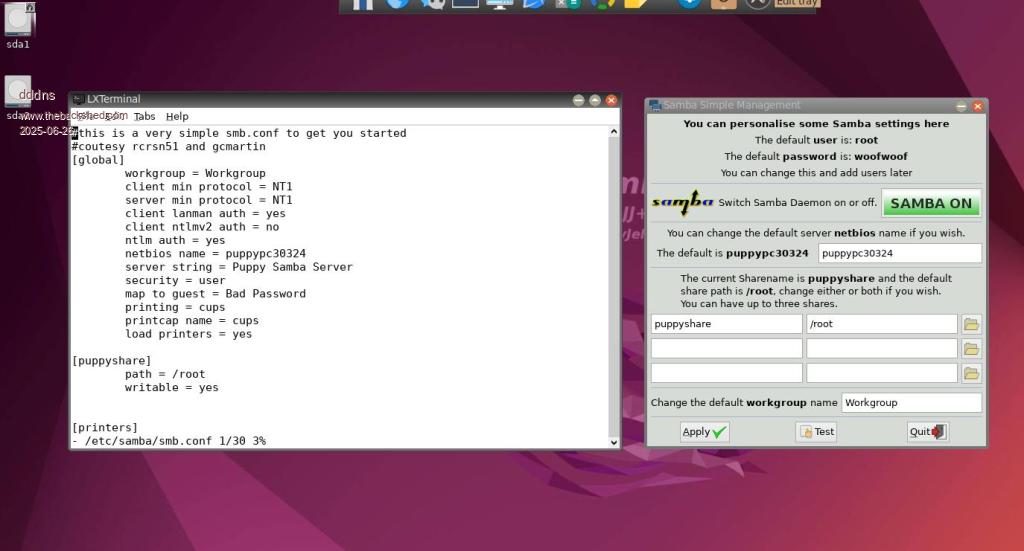

Posted: 06:04am 26 Jun 2025
Hello Grogster!
the issue you describe is very old but I never took the time to really look into it, as I'm using NFS which is faster and I don't have any Windows clients.
So here are two links which offer an answer: Mint forum1 and 2
I downloaded puppy (very interesting..) and installed it in a VM under virtualbox and bridged the network, so my client and the puppy box are one the same /24 network.
on the puppy server side I had to modify the default /etc/samba/smb.conf:
and on the client side:
[global]
## Browsing/Identification ###
# Change this to the workgroup/NT-domain name your Samba server will part of
  workgroup = WORKGROUP
client min protocol = NT1
#client lanman auth = yes
#client ntlmv2 auth = no
server min protocol = NT1
#ntlm auth = Yes

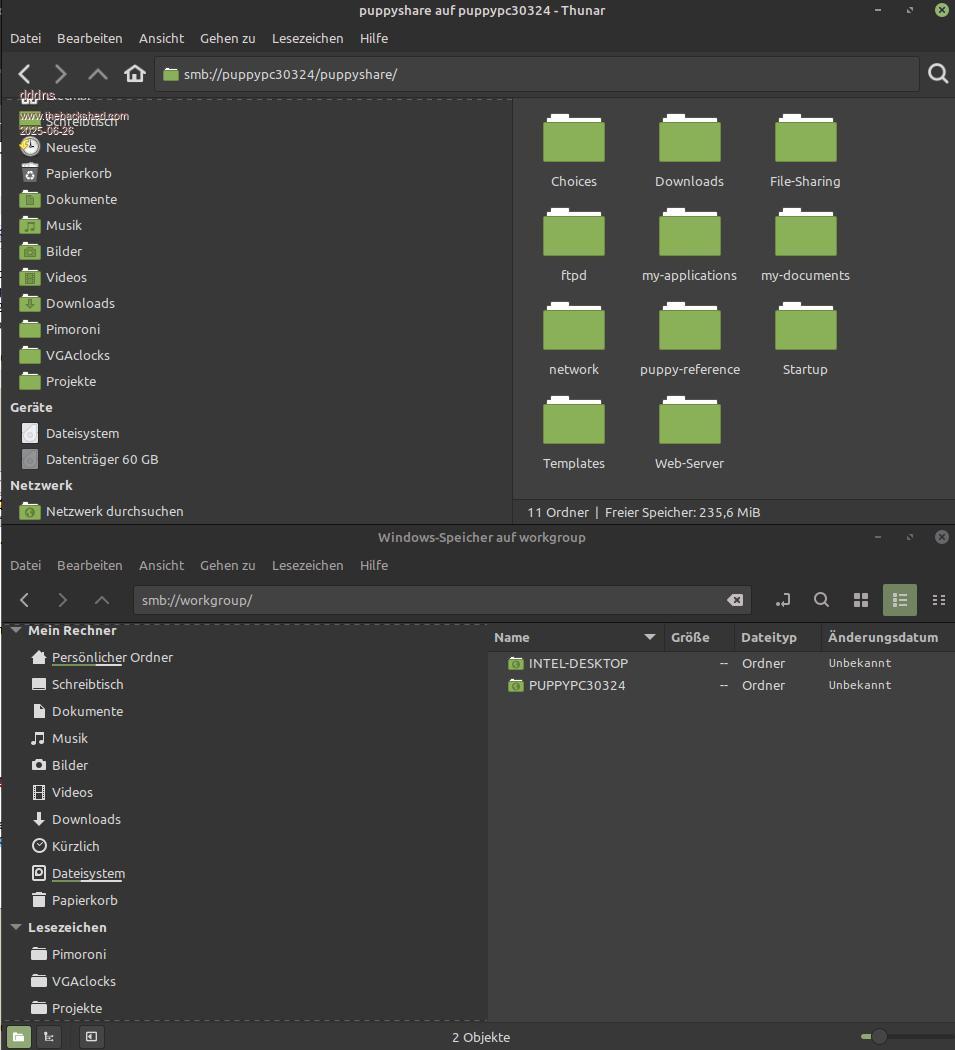

Now it's possible to:
smbtree -S puppypc30324.lan -U Workgroup/root
Password for [WORKGROUP\root]:
WORKGROUP
\\INTEL-DESKTOP   Intel-Desktop server (Samba, Ubuntu)
\\PUPPYPC30324   Puppy Samba Server
and to see them in Nautilus,Nemo or Thunar:
If you can't remember the samba root password, you can use:
smbpasswd
in a LX shell in puppy.
I hope you didn't give up yet!
Best wishes
If you only want to map a share to your MX, it might be sufficient to use Thunar and enter the share path by hand:
smb://puppypc30324/puppyshare/
Edited 2025-06-26 16:53 by dddns
