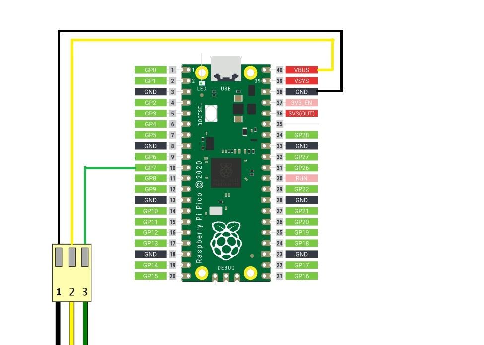

Hello everyone !!!
Some time ago I have had a small problem, which is not being able to measure rpm.
I use a CPU fan as a reference to be able to measure, but the readings always come out at 0.
attached the reference image.
I set OPTION COUNT gp6,gp7,gp8,gp9
on SETPIN i try PIN,CIN, and FIN.
and the code i use the same in page 46 of last MMBASIC manual.
In advance, thank you very much for your help.

Try outputting a PWM signal to a pin connected to pin 3 on your connector. If your count then works, that tells you that there's a problem with the wiring to your actual device. If it doesn't work, there's a problem with your code.
Posts: 6197
Posted: 08:56pm 27 Jun 2025
Typically, a 3 wire fan has power, ground, and pwm control for fan speed. Fans with a 4 wire connection have a tacho output and pwm.
Are you sure your 3 wire fan has tacho out? Note that a tacho output needs a pullup resistor (10k to 3.3v when used with a pico) to work.

The green wire of the CPU fan gives the signal to measure RPM, the problem is that not work, this wire have more than 3.3V and Ground(when sense).
I used another sensor through an optocoupler, where pin(gp7) has pullup (10k to 3.3V) and the optocoupler connects to ground. This scheme did work.
Posts: 3417
Posted: 02:24am 01 Jul 2025
First check that the Pico is reading frequency correctly, as Lizby suggested.
Put a jumper from GP2 to GP7 then enter the following at the command prompt:-
> setpin gp2, pwm : pwm 1, 1234, 50 : setpin gp7, fin : Pause 2000 : ? pin(gp7)
 1234
If the output is 1234 after 2 seconds then that is working. The pause is needed to allow time for the PWM to start and then to count pulses for 1 second.
Remove the jumper.
To reduce the 5V signal to 3.3V use a voltage divider. 18kΩ from fan output to GP7 and 33kΩ from GP7 to ground.
Then run the fan and try this:-
> setpin gp7,fin : do : ? pin(gp7) : Pause 1000 : loop

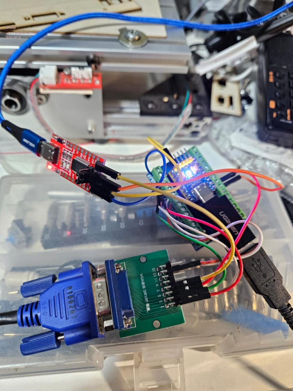

A few days ago, I received a Raspberry Pi Pico W from AliExpress, but the WebMite firmware didn’t work because the Wi-Fi chip is an ESP8285.
I’ll have to use it as a regular Micromite, either via USB or VGA Firmware.
From now, I’ll need to be very careful when choosing a Raspberry Pi Pico to use with WebMite.

One of the things that fascinated me about the Raspberry Pi Pico is the possibility of using MicroMite Basic, for the simple reason that before I used to think "how to do it", now I think "what to do". I enjoy programming in Basic, and MicroMite on the Raspberry Pico gives you the ability to do great things easily. I use also the esp8266 with espbasic, its great.
Unfortunately, the different versions of Raspberry Pico boards are not all the same in terms of functionality, and problems arise like the one I mentioned in this forum. But even so, quite a lot can be done without major issues.
Is there a channel to share experiences and information about the different boards with those developing MicroMite Basic? (For example, about the Pico W with ESP8285 chip.)
By the way, the RP2040-Zero is a very good format, but it happens to lack all the necessary pins to use PicoMite VGA. Is it possible to reassign them?
My best regards.
