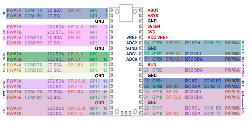

Hi all,
due to the possibility of colour mapping "any" colour of interest I'll take another look at the PicoHDMI version - BUT NOT the USB variant, since
there is a major flaw in the USB keyboard response time I can not live with. I am exremely happy with the "Converter-Solution" by the user "NoOne",
this allows PS/2 and USB at the same time. I have no interest in gamepads, so I don't care.
Why not the "reference design"? It just don't fit my needs and uses ICs (USB HUB etc.) I don't want on my PCB. And if I see it correctly there is
no free ADC pin at all (used by the SD CARD).
But I need some advide for the best pinout or any problems I might oversee!
This is my Pinout idea:
Are there any problems (conflicts) so far?
With this design I still have 5 pins free
GP26 (ADC!!)
GP20
GP21
GP0
GP1
since GP20 & GP21 can do COM2 & give me a second I2C + PWM
and GP0 & GP1 can do COM1, I am quite happy with it.
The design will be open for anybody when it is done. Like always.
Greetings
Daniel

hdmi remap colours can be done in vga.
hdmi gp 12,13,14,15,16,17,18,19 works for me
ps2 kb on gp 20,21 but need to reset com then enable
