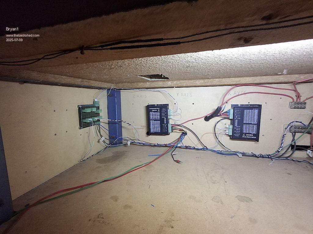

Well first Peter I do think we need to come up with a name for this new board and big daddy does come to mind as it will be a beast in any project one takes on.
My board from Grogster has finally arrived and in 3 hours and counting it will be in my hands   as my daughter picked it up this morning and she is working and gotta say she is only 17 and has been made a manager
Well with that out of the way a circuit board will need to be made where opto isolated outputs for the DM556 Stepper boards which will accept a 5 volt input. Now Harm did make me a file where it proved a 2040 could drive a axis   so with big daddy it should be a breeze.
Now the question as some pins on this board can handle 5 volts will they output 5 volts ?

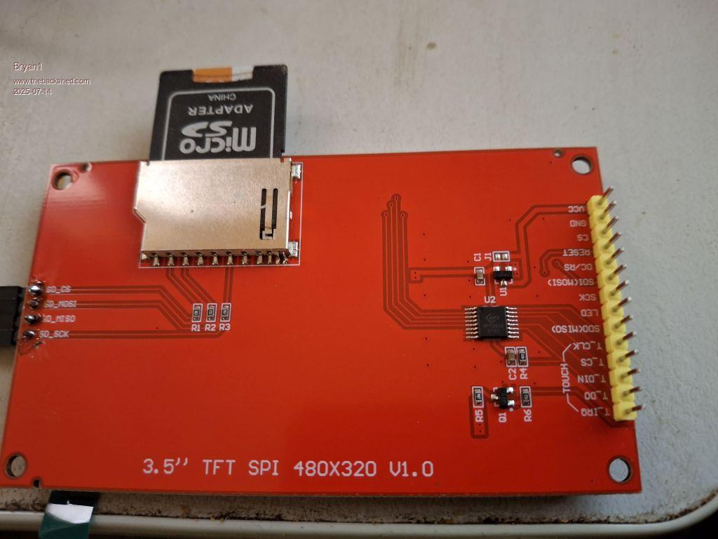

So my idea is to use a 2040 with a 3.5" touch screen with a ILI9488 so it can be mounted on the CNC to provide live updates from big daddy and be there for jog functions etc where the 2040 can report back on any movement.
Now big daddy will be setup with a VGA screen (well no HDMI screens here) and a USB hub setup for keyboard and mouse.
Essentially 4 pins for each axis will be needed for enable, direction, step and count as for each step which can be calibrated has to be counted for accuracy as no encoders are used.
More ideas will come to mind and remember this black duck will be learning from the get go on the coding side as the grey matter comes into play also with other projects on the go aswell. Also has it has been awhile my sprint layout skills will need a touch up to suit JLCPCB.

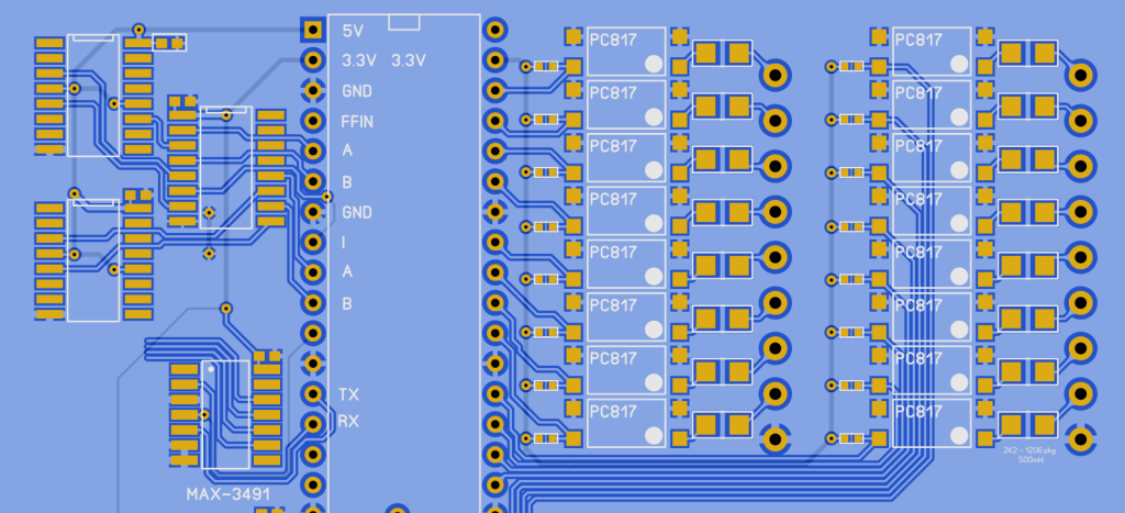

PhenixRising
Joined: 07/11/2023
Posts: 2100
Posted: 10:36am 04 Jul 2025

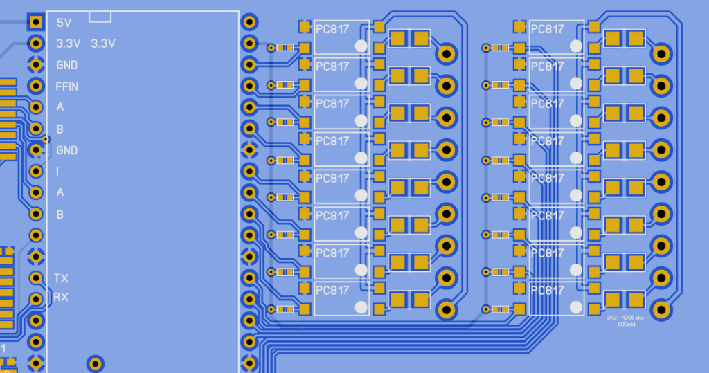

I use optocouplers for 24V inputs from machine sensors.
The unlabeled devices (top left) are for two encoder inputs (I prefer two encoders per axis). They are MC3486 differential line receivers although they can be configured to handle single-ended encoders. The device between those and the RP2350 DIL is a CD4050 for 5V to 3.3V.

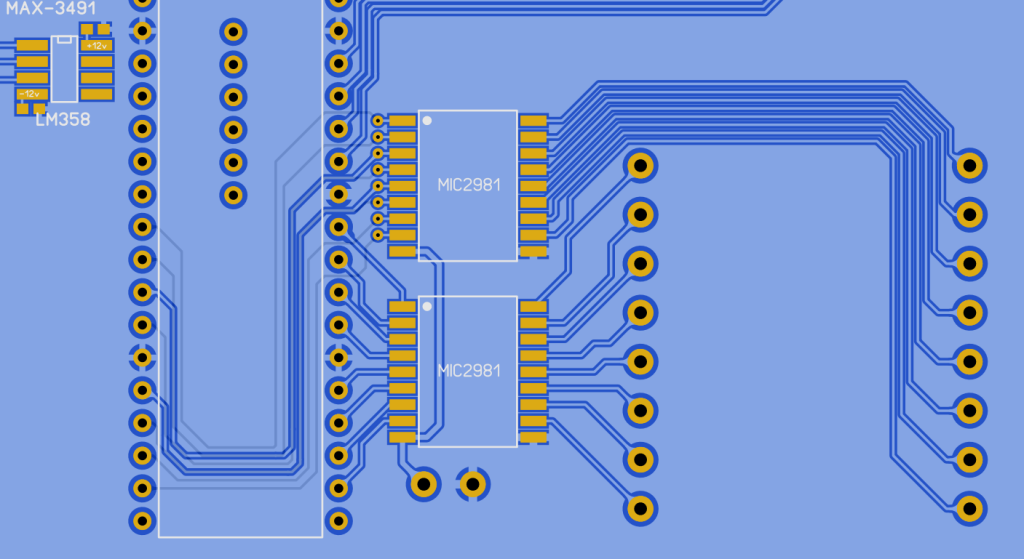

The MIC2981 is used for outputs. The datasheet states that it can be used for stepper-drives. It can handle a decent amount of current although I only use it to give me up to ~30mA per output with negligible load on the RP2350.
The two terminals under the MIC2981s are for external supply (up to 50V?). For me, this is typically 24V although some machines can be 5V or 12V

Posts: 6197
Posted: 11:26am 04 Jul 2025
Hi Bryan,
When you have optocouplers at the input, you can also disconnect the LED cathode from your ground plane, and connect it directly to the ground of the system driving the input.
As it is now, the optocoupler shares input and output ground. It does not isolate.
Do you have the 64 pin footprint correct? Maybe the photo is misguiding my eyes, but it feels a bit narrow.
When you plan to use the MIC2981 to drive stepper pulse and direction, you may want to add pull-down resistors from the outputs. The MIB2981 can essentially only pull high. Not pull low. The MIC2981 is a complement to the ULN2803 (that can only pull low, not high).
Edited 2025-07-04 21:32 by Volhout

PhenixRising
Joined: 07/11/2023
Posts: 2100
Posted: 11:47am 04 Jul 2025
  Volhout said  Hi Bryan,
Not Bryan, but
Hey thanks, Harm
Optocouplers: In fact. What I actually intend to use is the AC-type optocouplers. Yeah I'd better do it now or I'll never do it.
You are absolutely correct (great observation) re: width. Here's where I assumed it was the same as the RPi Pico and didn't measure or check Pete's gerbers.
I toyed with the idea of a pull-down on the MIC2981 but I have thoroughly tested these things with all kinds of loads and haven't seen the need. I will look at it
Posts: 9240
Posted: 11:51am 04 Jul 2025
I wonder if that's my fault? I think I might have done a 0.9" footprint for SL6....

PhenixRising
Joined: 07/11/2023
Posts: 2100
Posted: 04:18pm 04 Jul 2025
  Mixtel90 said  Very red-faced. :(
Here's the fixed version!
Pico2-64.zip
Thanks Mick
I'd already spaced mine out but I loaded yours anyway, superimposed it and it snapped right into place.

PhenixRising
Joined: 07/11/2023
Posts: 2100
Posted: 04:54pm 04 Jul 2025
Corrected DIL spacing and isolated optocouplers.
