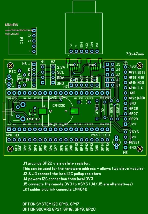

Something that I've been considering for some time. This could be used with anything that can send and receive 3V3 I2C. The board is small enough to get two out of a 100mm square of PCB material.
Any of the Pico pin-compatible devices can be used but a few of the modules, such as the YD-RP2040, are slightly wider and there might be mechanical considerations if the SD card or RTC is fitted.
This can run stand-alone or as a remote IO board. By default it communicates over I2C, but it's easy to use multi-drop COM instead by adding diode D2. Communication pullup resistors are optional.
If I2C is being used for communication:
A mini RTC can be used if required, with an optional additional battery.
A SD card module can be added if required.
Unless the SD card module is fitted all GPIO pins apart from the two allocated to communication (GP16 & GP17)are available to the user.
The power chain is configurable.
5V via USB.
3V3 via the communication supply.
If using this as a master module it can power the communication supply at 3V3.
VSYS is accessible on H5.
There is already some software support for remote IO. Some time ago @lizby produced some routines that might be used with this board. Sorry, I can't find them at the moment.
You could easily connect another SPI device, sharing the port with the SD card and using GP22 as a select line. GP26-GP28 are available on the same connector.

Hi Mick,
Have you played with Pico-to-Pico I2C and if so, how is the performance?
Posts: 9241
Posted: 11:04am 08 Jul 2025
I tried it a while ago. Just an experiment to make a I2C game controller. Actual data transfer is very reasonable, but it will depend on your protocol more than anything else. I wouldn't recommend doing remote IO any faster than 100kHz due to cable length issues as it's really designed for on-board communication. The other problem is that I2C isn't buffered so you have to work round that.
I used about 600mm of telephone wire and 100kHz. The controller was handled by the master asking it for registers or register sets, so you might only ask for the buttons as a byte (very fast) or both of the X and Y positions of the analogue joystick - slower obviously. The controller used a RP2040-Zero.

Hi Phenix,
Last weeks spend again a lot of time debugging a test system using I2C for some sensors.
Lessons learned (again) : Don't use I2C crossing boards (flat cable) in an electrically dirty environment (near a 11kW 3phase motor drive).
I2C on a PCB with good ground plane is fine. But as soon as you leave the board the open drain (pullup impedance) makes it vulnerable. And there is simply no good way to filter this out (capacitors/common mode chokes). If you need I2C then use one of those serial-I2C convertors, make the cable run on serial (RS422) and convert to I2C near the I2C device.
And when you implement I2C in industrial system, it is almost certain I2C errors will occur. Make sure your software can handle I2C errors. SCL stuck low is a nasty one, most cases require a hard reset of the I2C device (slave). SDA stuck low can be repaired with 9 clock pulses on SCL.
Implement error handling from the start !!! Do not wait until you are hit by it in the field. Then it is too late to implement the reset of a device (*).
Most I2C devices can be reset by removing Vdd, waiting, and re-applying Vdd. This only requires to switch individual device Vdd, no need for extra RESET line. You can also power low power I2C devices from the output of a logic gate (that acts to switch Vdd).
P.S. There are I2C bus buffers that can communicate I2C with low resistance pullups. That improves somewhat. It is not fail proof though.

All very true! I'm not pretending that this board is industrial gear, more a way of adding extra IO to a Pico mounted somewhere nearby. For industrial stuff I'd only use RS485 or, in severe cases, opto. That's become a lot cheaper than it used to be, especially if the distance isn't too great for plastic fibre.
For this particular board you might get improved performance using multi-drop COM, purely because the COM ports are buffered. It's still only local though as the pullups are only resistive, not active. You also can't use it if the RTC is fitted as that assumes a I2C bus. I could have given the communication lines their own GPIO pins and put the local I2C stuff on another pair, but that's using pins that might be required for something else.
Oh, a bit of rearrangement and the YD-RP2040 will fit now (preferably shorting pins 39 and 40). GP23 and GP29 come out to pads near the RTC battery.
