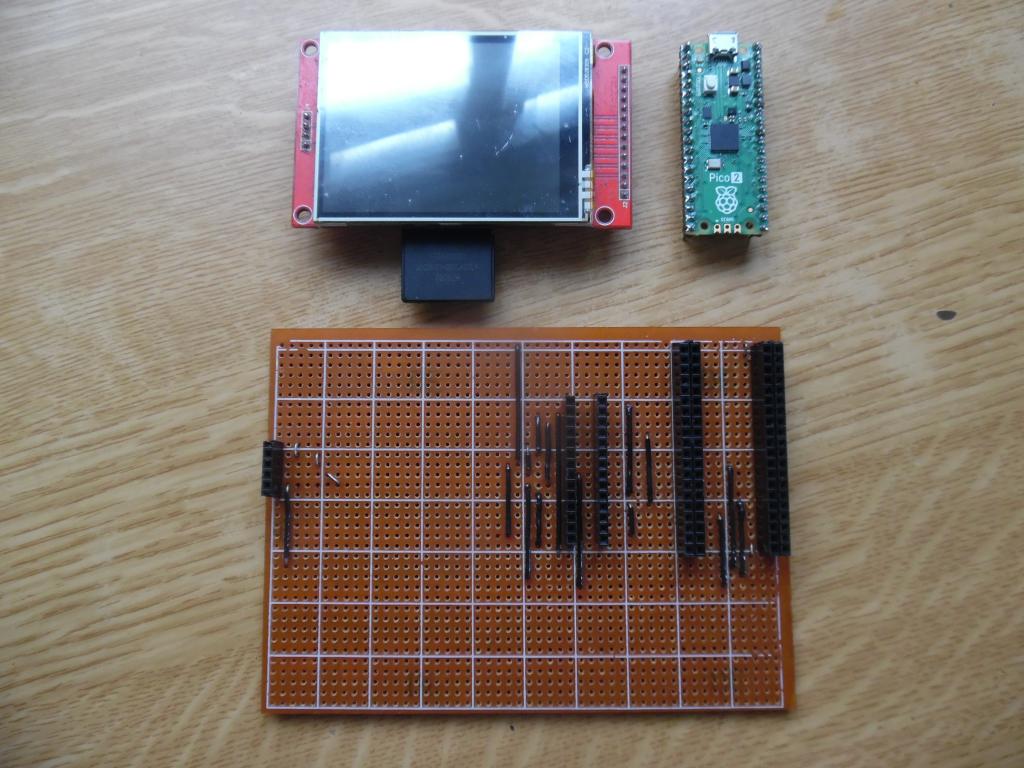

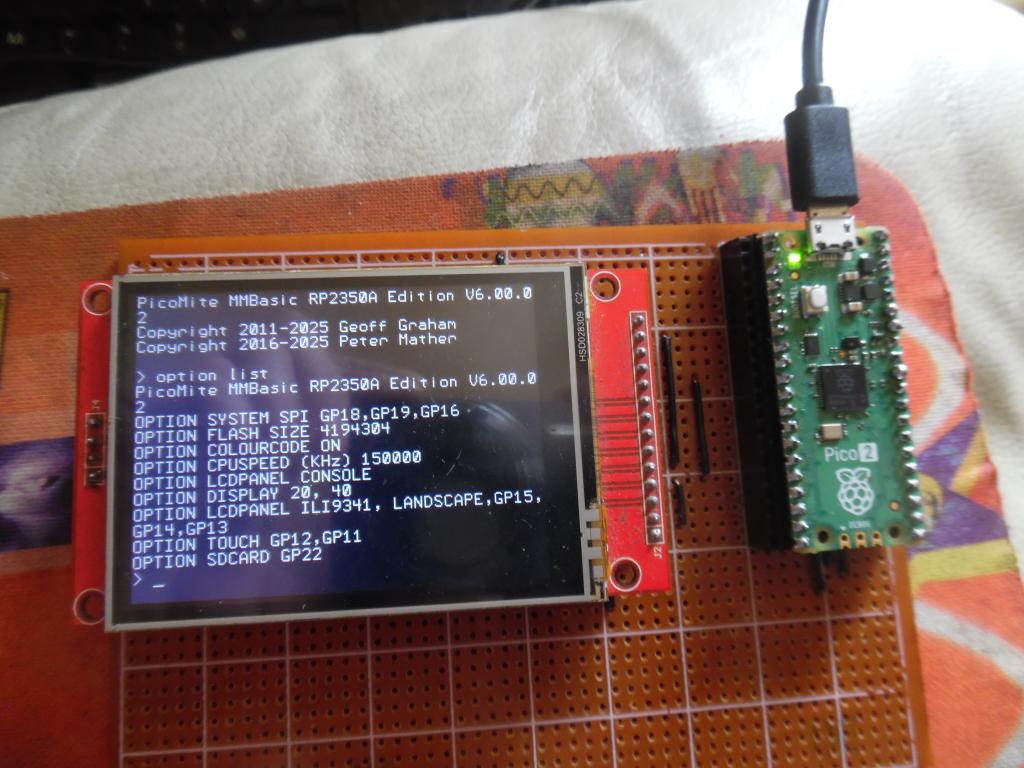

I tried a ili9341 board I built and upgraded to pico2 but no display so upgraded to v6.02 and set options but no display. swapped display, same. reflashed and heartbeat flashing but same. Then I realised I put the pico board wrong way round.
amazed pico not damaged. how to waste hours :)

but rpi pico 2 is forgiving. hdmi took my attention but want to relearn lcd picomite gui cos it's really well implemented with brill features.
not as good as hdmi or vga cos it's spi and slower reading the screen and stuff but still impressive imho

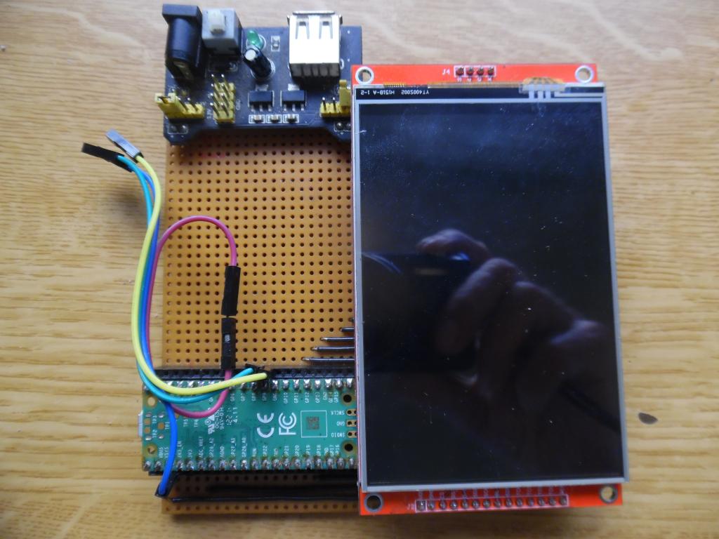

I did a ili bigger display but wired the pico upside down so I could see the gpio labels.2040  silly.
got to wire diode and resistor for it to work touch and sd card which I done but not on above board and it doesn't mess with ili9341

the above board 2040 I decided to update to latest firmware and took the board which was usb and pressed the boot button and then plugged the usb cable. windows went bing bong then the pico board got too hot to hold.
guess it was still in usb mode.
and looking at the above display it has diode sdo -->:--tp0
and 10KR cs---[10k]---tp0 which isn't mentioned in the manual so is it still needed?
the burning out pico is strange if it still in usb then no apply usb lead but I pressed the boot button
