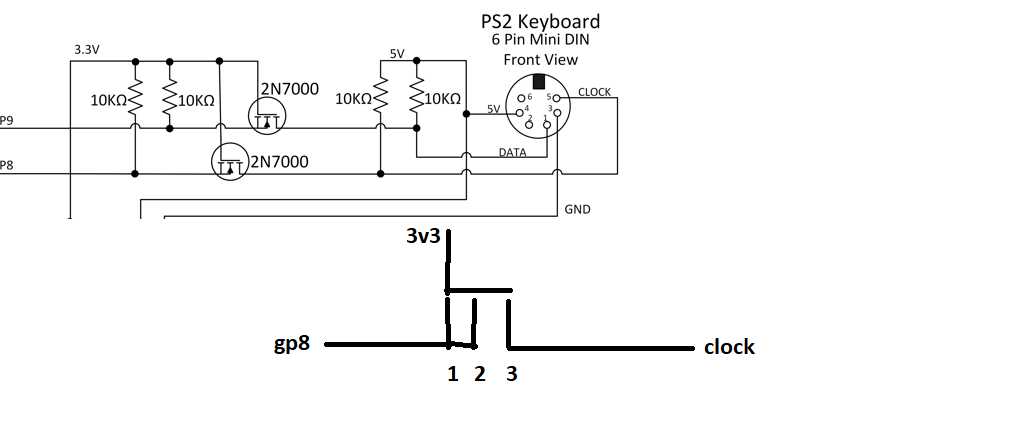

dont now how this 2N700 is connected
3v3 connected to pin 3 ?
gp8 connected to pin 1 and 2
pin 3 connected clock

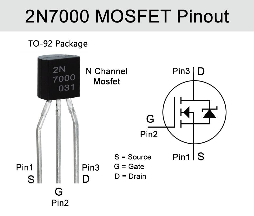

How do you mean? That's a conventional level shifter circuit using a common N-channel mosfet.
GP8 - source - pin 1
3V3 - gate - pin 2
PS2 CLK - drain - pin 3
If you look at the mosfet from the top with the flat side towards you the pins are in 1-2-3 order left to right.
What you have labelled as pin 2 is wrong. On a mosfet symbol the source is indicated by both what you have labelled as pin 1 and the centre line with the arrow on it. The direction of the arrow shows weather it is N-channel )towards the gate) or P-channel (away from the gate).

3v3  connected to pin 2 - GATE
GP8 connected to pin 1 - SOURCE
CLOCK connected to pin 3 - DRAIN

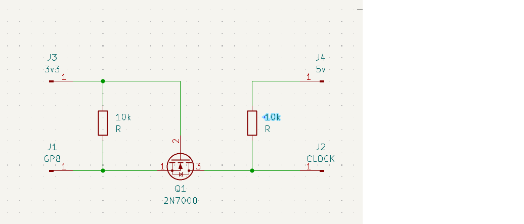

Posted: 10:40am 17 Jul 2025
like this

The 10kΩ pullups are a bit high for speed.
On the 3.3V side 1.8kΩ and 2.7kΩ on the 5V side would be better.
If that still isn't enough 680Ω and 1kΩ are as low as I would go.

Connecting one line via a mosfet and the other not is exactly like adding a capacitor to one of the signals. You can expect the signal to be delayed - that's how mosfets work. :)  If the clock speed is reasonable then putting both clock and data via mosfets works fine as the signals remain in synch.
10k is ok for the pull-ups in most cases. It needs to be reduced at higher frequencies to charge the capacitors in the mosfets (and any signal line capacitance) quicker, but at PS2 speeds it's ok.
